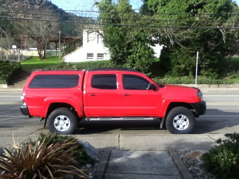

    2008 Tacoma Super Duty aka Tundra
    Canopy, fitted seat covers, OBA with self leveling air bags, 100w solar, dual Rhino Rack Pioneer platforms, side & rear LED work/FU lights, CB, cell booster. 7x16 cargo conversion, 3" lift, 7'x6.5' fold down aluminum rear deck.
    2007 PreRunner. Front-5100s w/ OME 884 coils. Rear- AAL currently with Rancho shocks (will get Billies later). Tires- 255/86/16 (a little less than 33").
