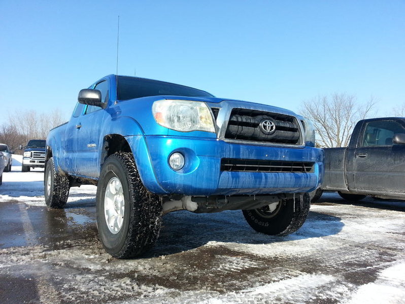

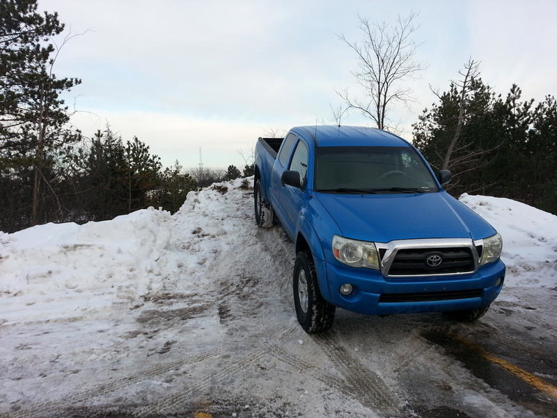

    One truck pic, more to come tomorrow.

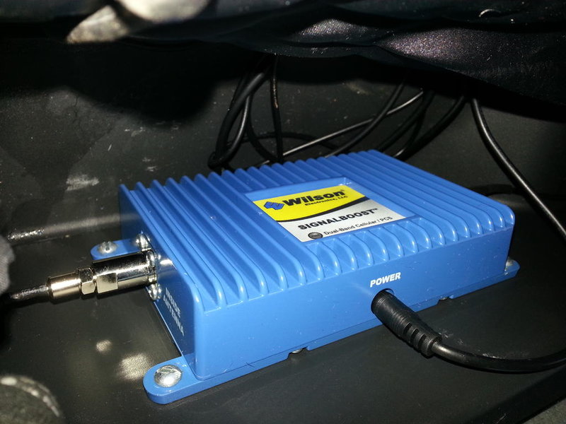

    The Wilson electronics amp module is under the back seat in the cargo compartment. Thanks to the plow jockey who made the nice picture ramp for me. More to come soon. Still waiting to get more parts in the mail.

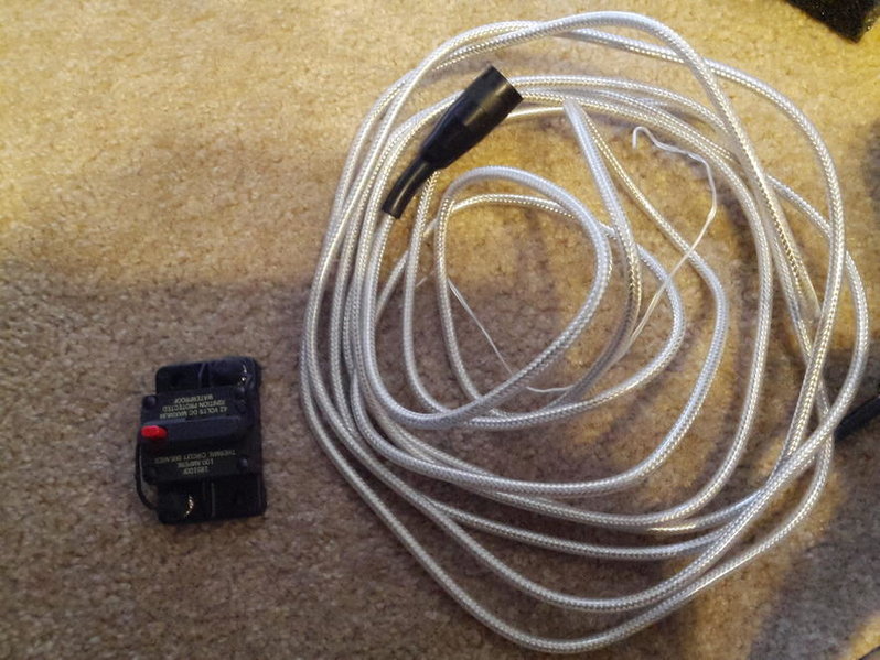

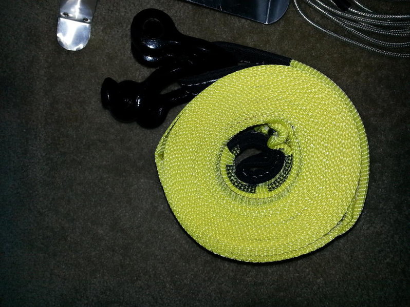

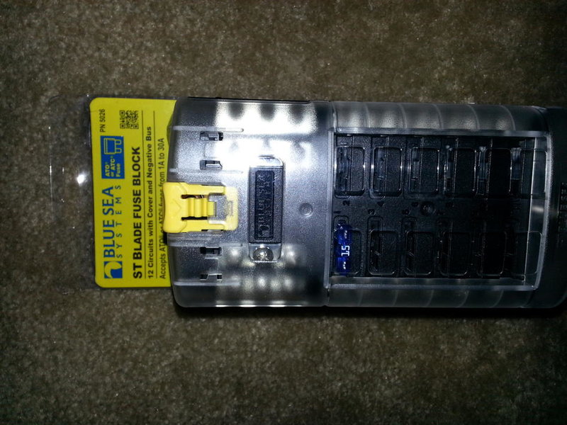

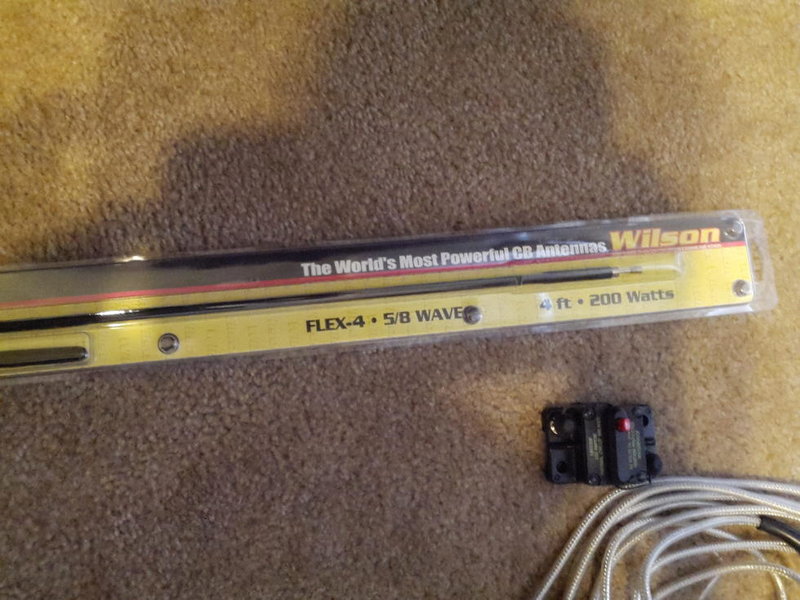

    Here is the new tow strap and shackles I got and the blue sea systems fuse block I'm gonna use. Its a negative bus and 12 fuse slots.

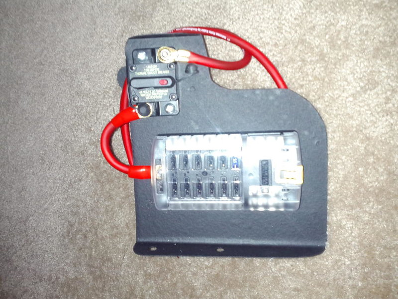

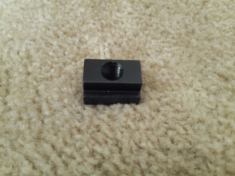

    I got the t nuts from fastenal they are 3/8 16. The second picture is the aux panel set up. It will be installed once the weather gets a bit nicer.

    Nice build! What is the Wilson thing? I have never seen one before

    Yep its a cell booster. Its a awesome addition if you go to places that don't have good cell service. I get a 2 bar boost when it is hooked up.

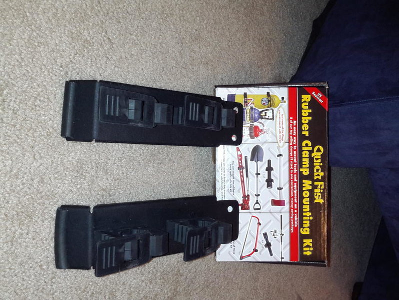

    I got the quick fists mounted up on the brackets today. I decided to buy the kit with 4 regular 2 large and 2 mini quick fists all for 27 bucks through Amazon. I'll have more pics up soon of them mounted in the truck. I did use some rubber hose over the ends of the brackets to keep the chaffing and noise down.

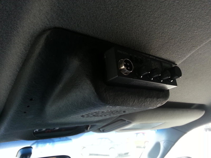

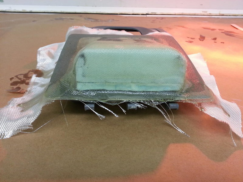

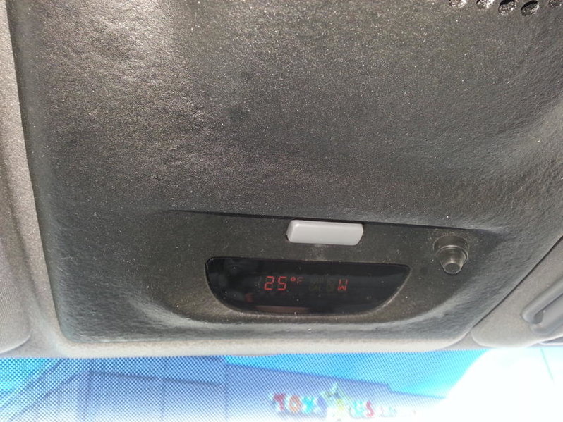

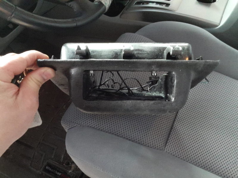

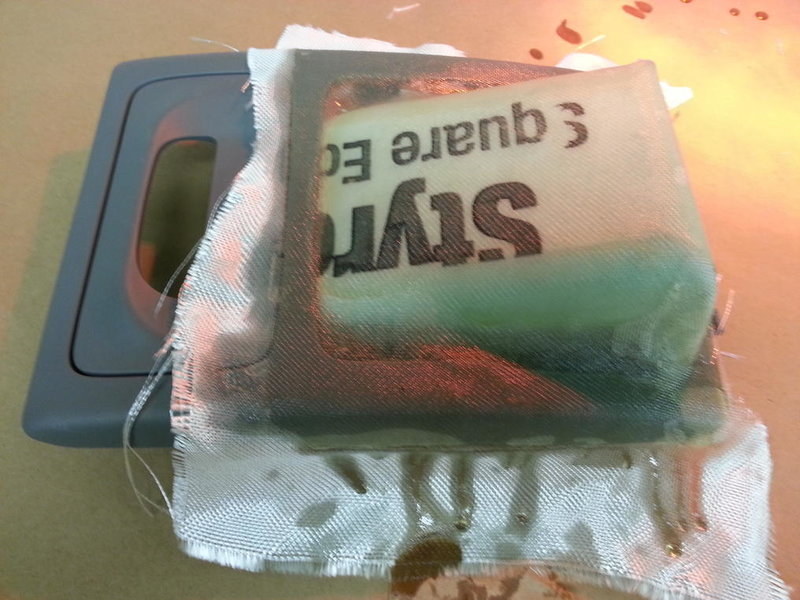

    This freezing weather has really taken a toll on the mods. I ordered my softtopper at the beginning of the week as well as a pioneer touch screen head unit. My cb mount is taken shape. I'm modding my over head console to accept my Cb radio.

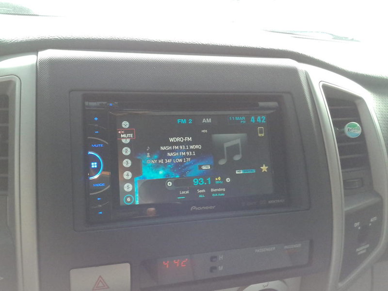

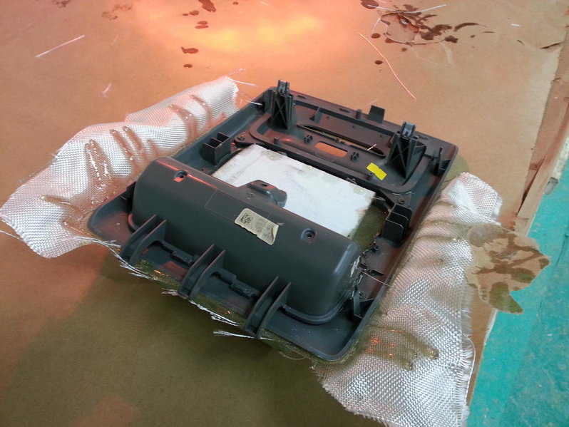

    So with the nice weather the mods can comense. I got my pioneer head unit installed. I bought it from crutchfield and I received the wiring harness and adapters for free. The directions from them were awesome and so was the price, 300 for everything. The only issue I have is the plastic feels a little cheap and doesn't fit the dash like factory.
    I got the hybrid Axe/maul and shovel mounted on quick fists on the front wall of the bed. Pretty happy with how the brackets tured out.

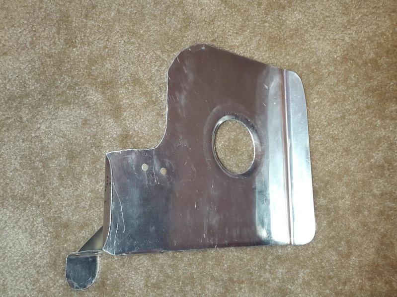

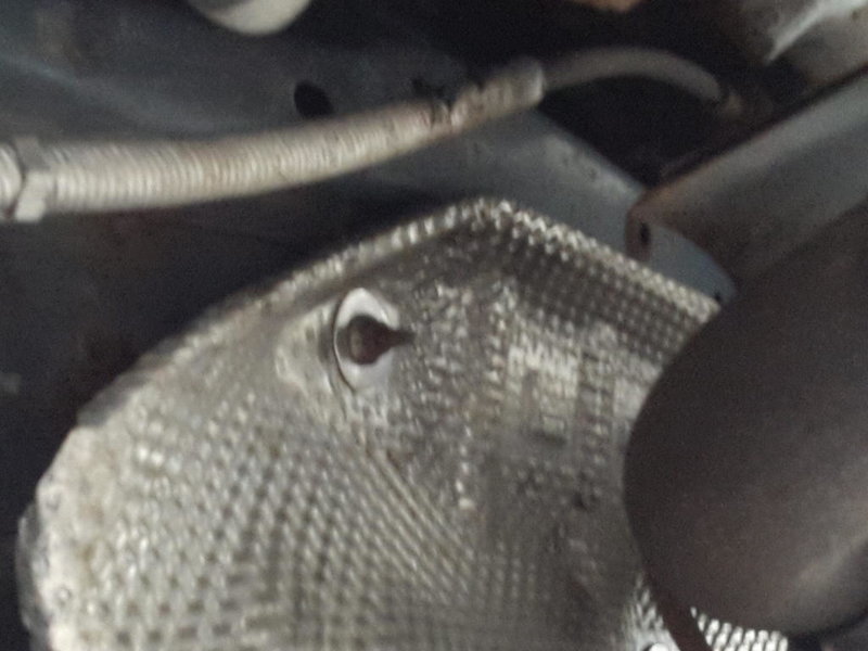

    For the past month my heat sheild on the drivers side has been rattling on the cat. It turns put the aluminum shield had broke around the bolts so I made some washers at school Out of .050 thick aluminum and then installed over the sheild. I hope this adds enough surface area so it doesn't crack again. Last but not least I made some spacers out of .063 aluminum add put it between the carrier bearing and mout flange. This will reduce the drive line angle and I hope help with some vibrations.

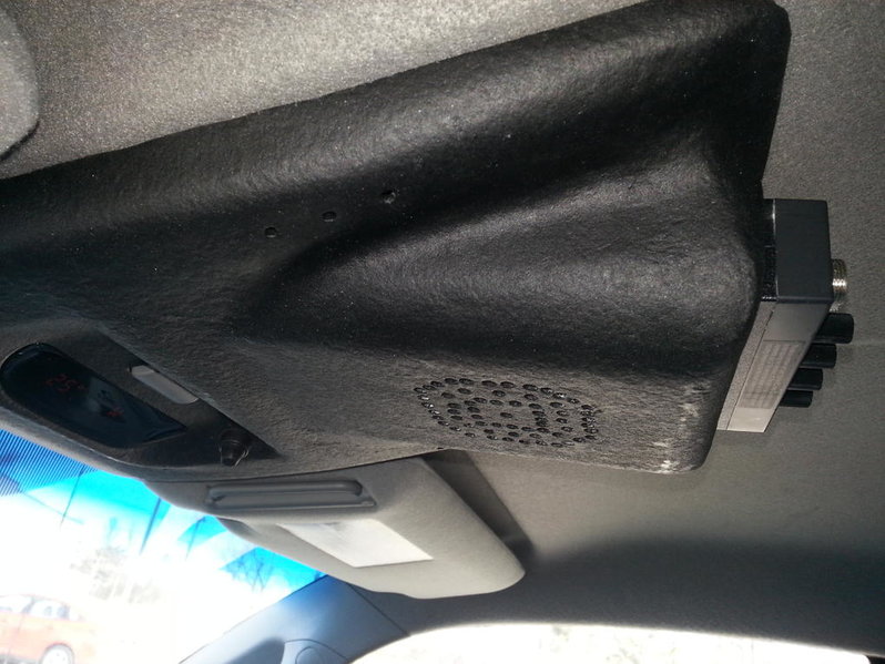

    Well the cb console is done. It turned out very nice. I still need to wire up the lights and the cb but its installed.
