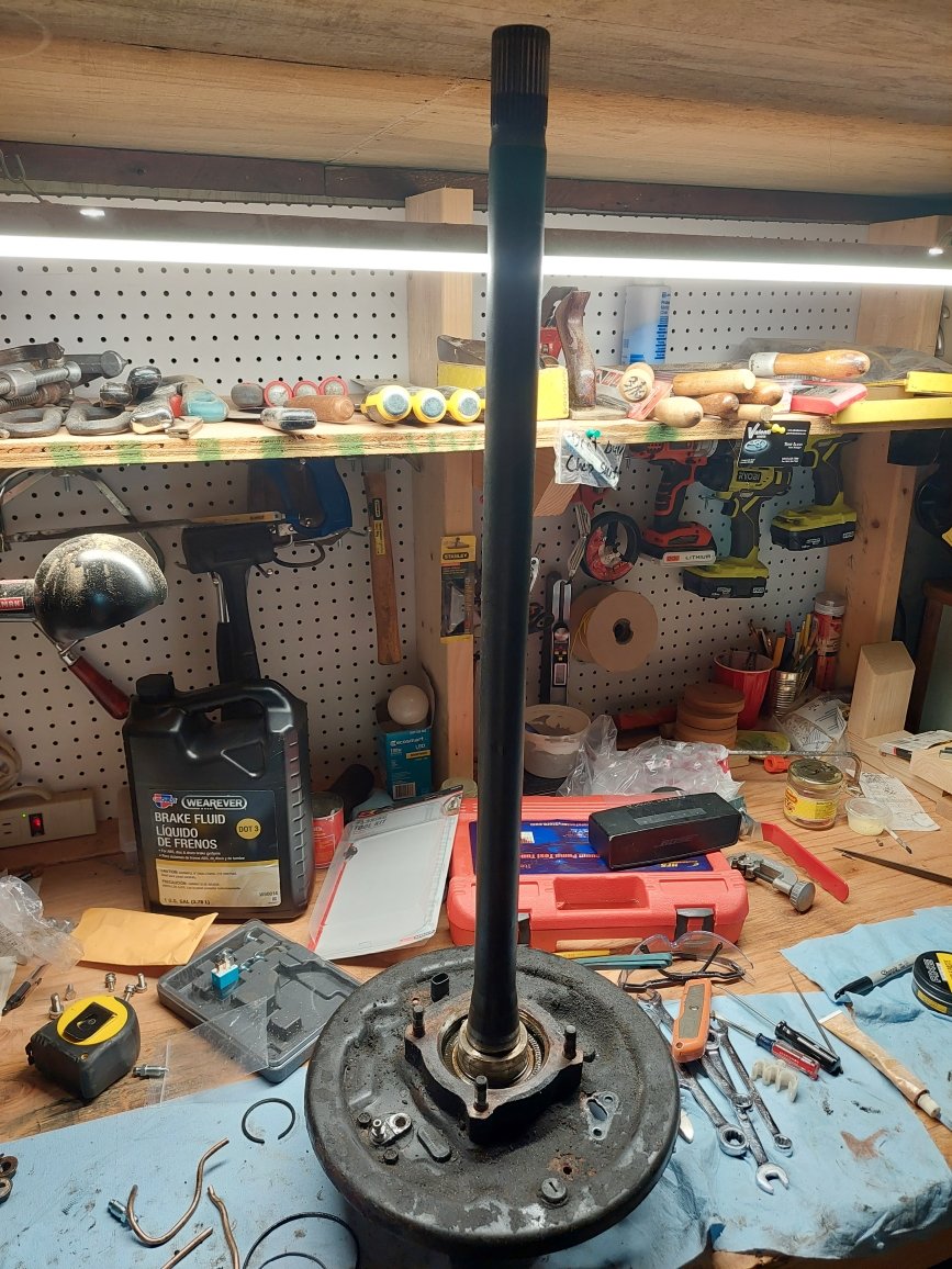

    So I replaced the leaking right rear axle seal on my 2007 4WD 2.7L Tacoma (amongst other things) and decided to replace the wheel bearing while I was at it because the bearing didn't feel great and people have said gear oil is bad for the bearing.
    Lacking the tools to replace the bearing myself, I brought the rear axle half, hub and drum backing plate to toyota (see picture) to have the retainer ring pressed out, the wheel bearing pressed out, and new ones pressed in.
    When I got the axle assembly back from the dealership, there was a space between the retainer ring and the snap ring that holds the retainer ring in place. ODD, the retainer ring previously stopped right at the snap ring groove. I.e., the retainer ring is now approximately 1/16-inch closer to the wheel bearing than it was previously.
    Additionally, I cannot rotate the wheel bearing by hand. I know new wheel bearings can be tight, but this seems very tight. For example, with the axle installed I can rotate the wheel bearing by putting most of my 180lbs on a wheel stud with my foot, and maybe with all my force rotate it by hand, but I don't ever remember new wheel bearing requiring more than light hand pressure to rotate. If I put the wheel on the added leverage allows me to rotate it, but again it's very tight.
    So, I am thinking the wheel bearing was over compressed by the retainer ring, squeezing the wheel bearing and not allow the bearing to rotate easily.
    Does everyone agree? I have everything back together (drums too), but am leaning towards pulling it back out and bringing it to the dealer because I won't even be able to adjust the rear drums. I dont want to bite the bullet because it's been a never ending project, but it seems smart.

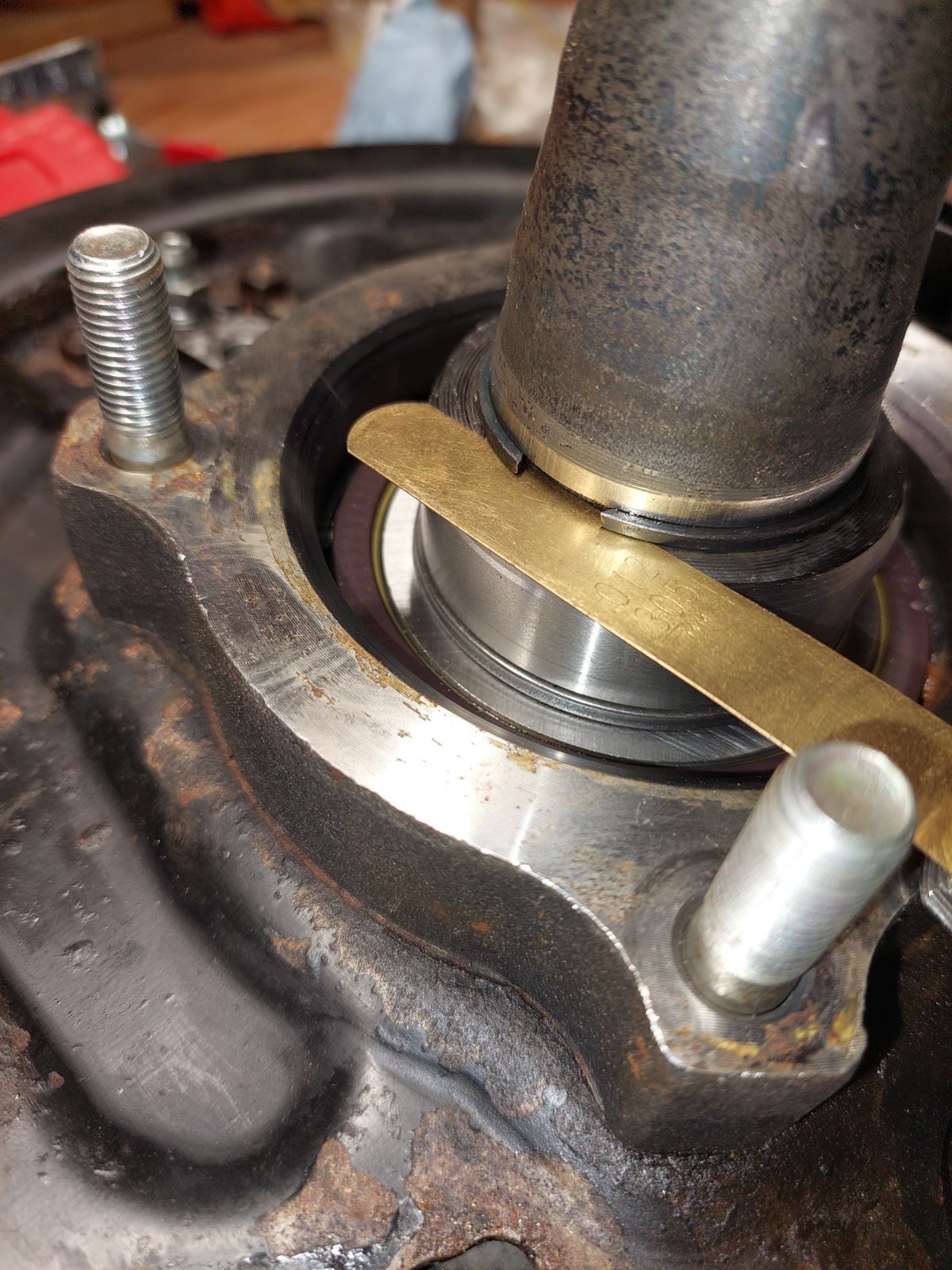

    Steve P, see below picture. I over estimated the gap in my original post, the ring is loose but not as loose as I previous said, a .012 shim fits.

    One more thing - my best guess based on the pic with the feeler gauge is that they went overboard with the press. The washer is clearly there, and nothing else looks out of place to my untrained eye.
    It does take a fair amount of pressure to drive everything down the axle, but the amount required is pretty uniform until is finally seats. Once it does, there's no need to crank on it any further...it ain't moving, and forcing it to do so will only cause trouble.
    There's also no need to press everything on at the same time...you can seat the bearing first, then slide the washer on and press the bearing retainer/collar on after that. Doing it separately relieves a little bit of the stress of making sure everything is aligned properly before you start bearing down on it. So to speak.

    It does appear that the bearing and seal retainer have been pressed on a bit too much causing your issues, that Belleville washer is flat as a pancake. It took a fair amount of pressure just to get the snap ring on so to get to that point it definitely a lot of force.
