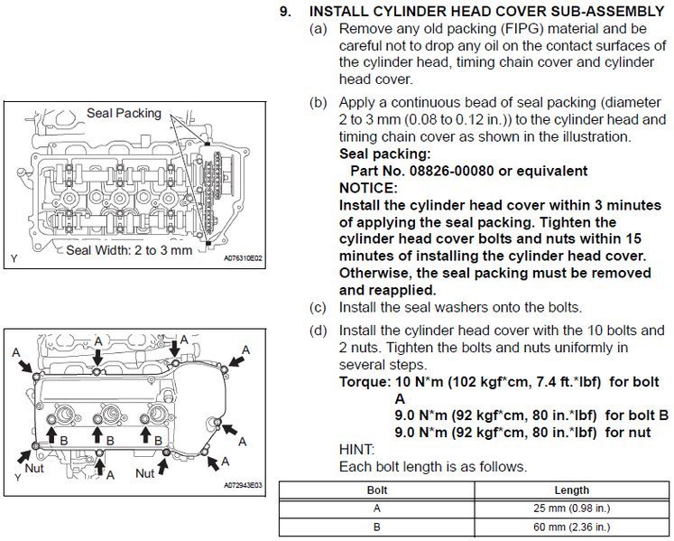

    The important part is putting RTV / FIPG in the correct spots on the head/timing cover.
