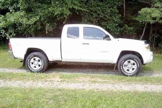

    I got mine from Fat Bob's Garage. 2.25" and it is almost EXACTLY the same as the rear.
    Before
    After

    Looks perfect. Do your have the TSB springs on back? With my front at 2.2" it was 1" nose high with standard TRD OR spring pack.

    No I have the original spring pack on the back. I got the truck at 2 years old, so I figured they had settled about as far as they were goin to until they start saggin, so I just measured the difference between the top of the tire and the fender and got the spacer that was closest to it. Right after I put the spacers on I was only like 1/8" high on the front.
