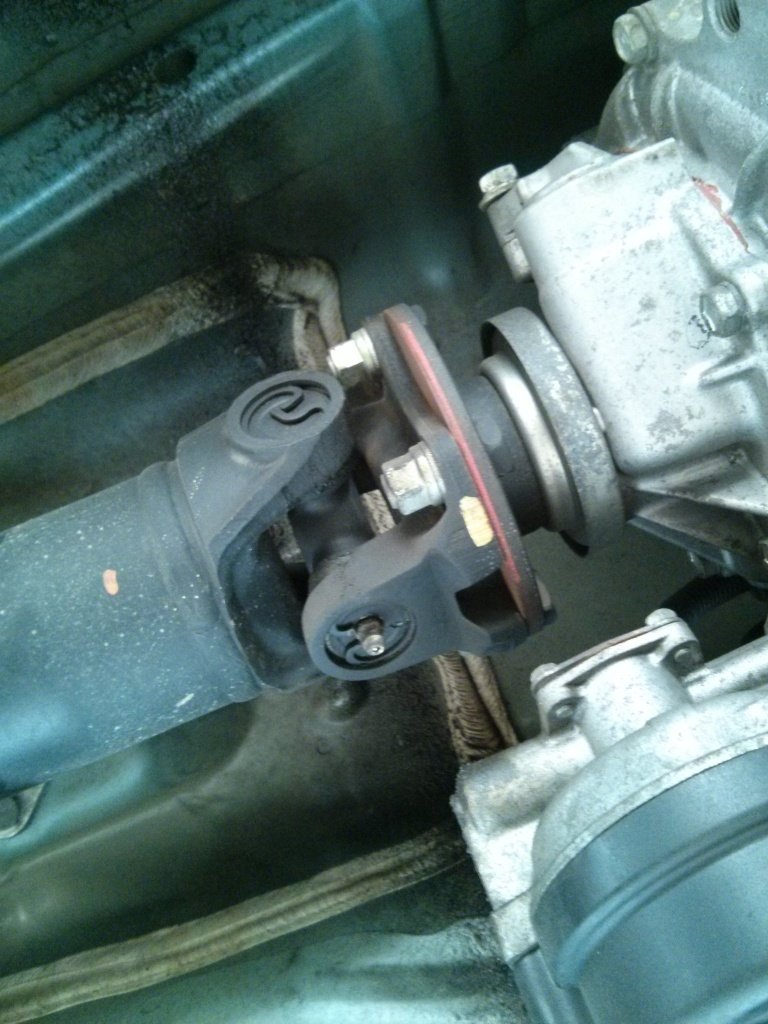

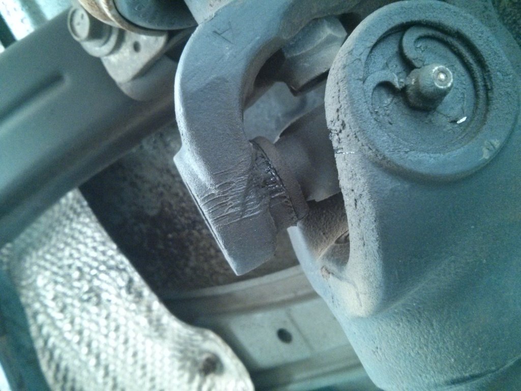

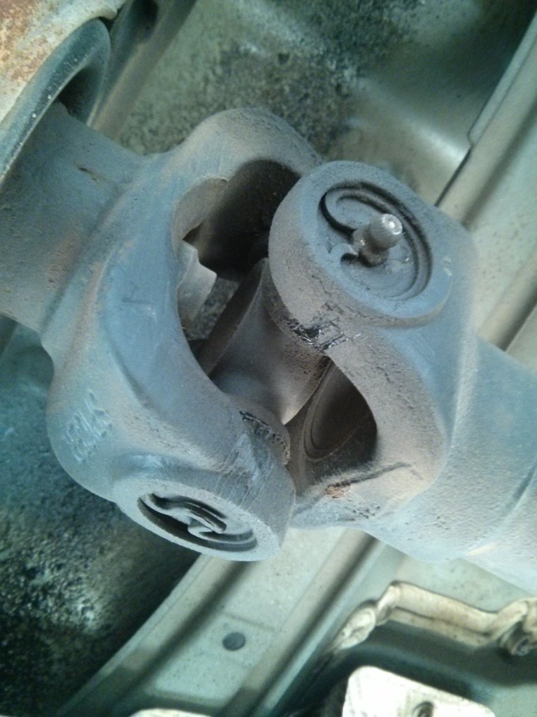

    Took some photos of them and the area around them. It looks to me like its lost grease and oil.

    Your just seeing the excess grease that gets flug around the driveshaft after greasing... nothing to worry about. As far as the clunk/popping sound is it happening only when you first start out while backing up? If so you might be hearing the brake pads shifting... completly normal for these trucks and well documented here.
