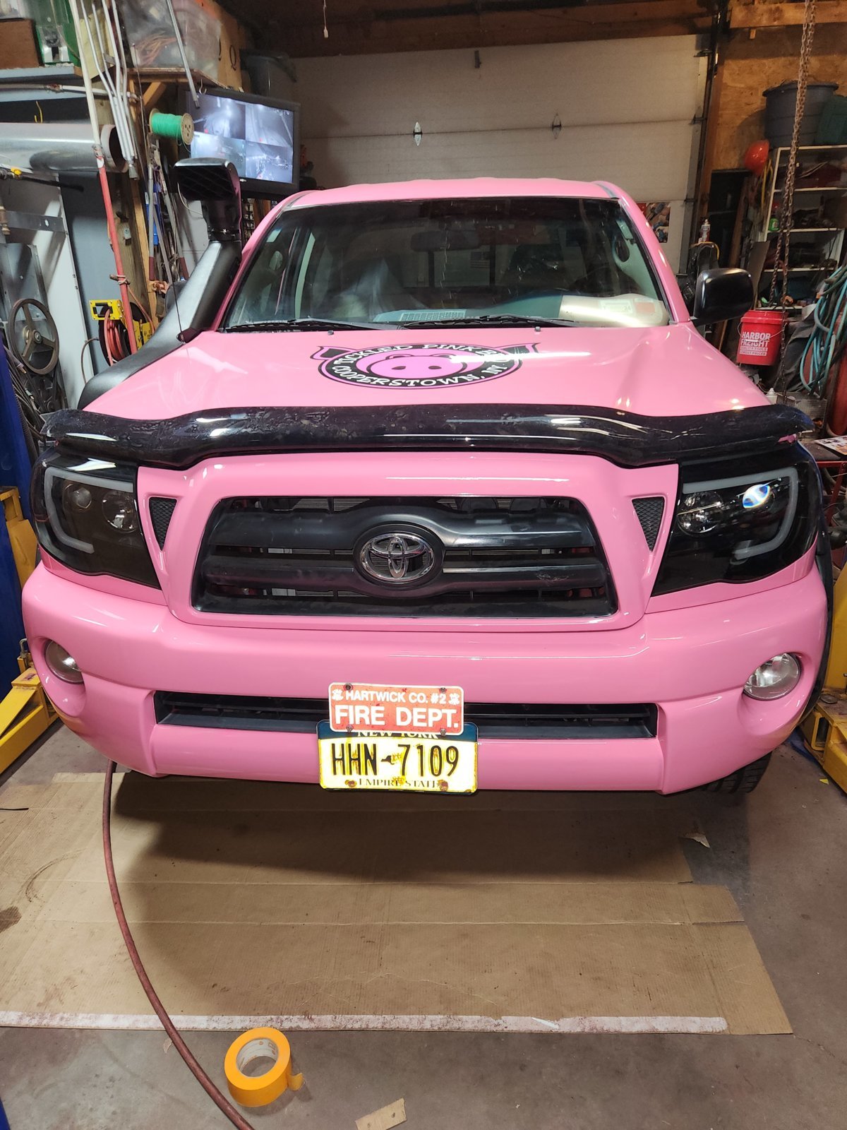

    Well the first thing I did was change all the fluids, then sand off all the peeling clearcoat and repaint the truck, new headlights, new sound system, went with Android to bring it up to date. Still trying to get power to the black wire for electric brake controller. New hitch so new trailer wireing. I know, yes it's pink. My business is called Tickled Pink Bbq.

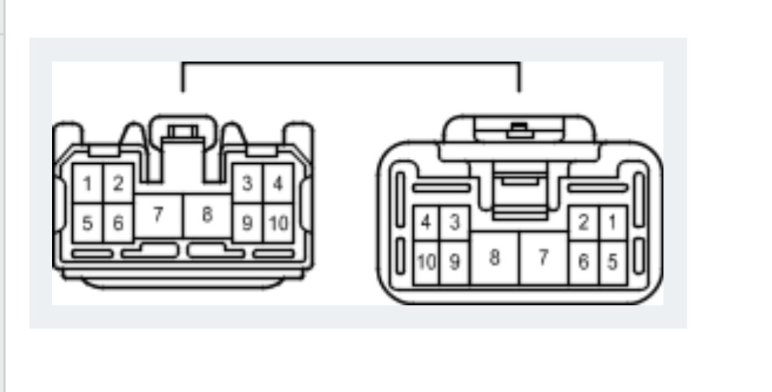

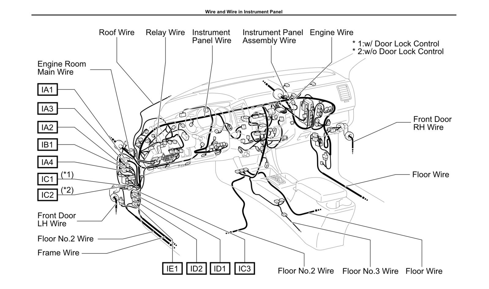

    If power is at the fuse, and the fuse is good.
    Check the IA4 connector pin #1. See if you have powers there

    Fuse has power both sides but no power at number 1

    Thanks for the diagrams

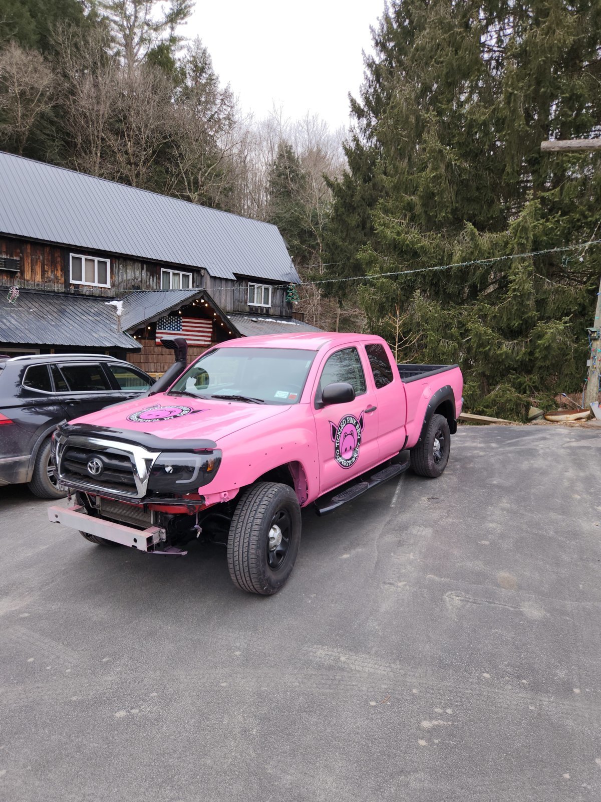

    Front end finished
