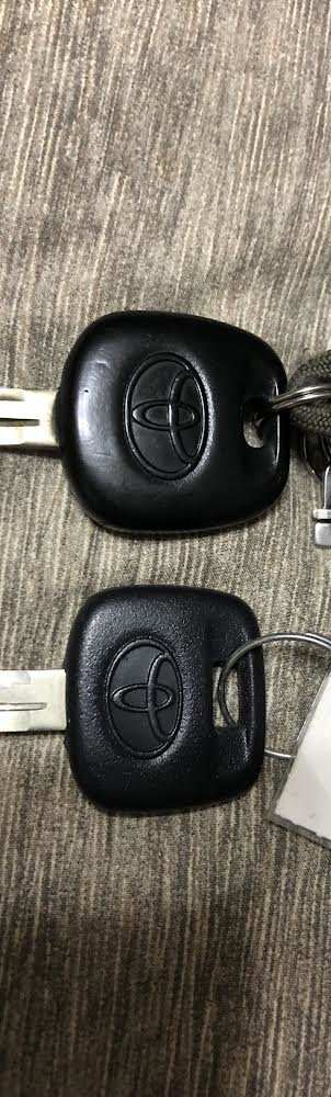

    I don’t know if this would make a difference or not but when I bought the truck, the guy lost the original key so I had to take it to Toyota and they made me a key. They just gave me a plain metal key and the truck ran for about three months before I went out there one day and it wouldn’t start at all.

    So your key looks nothing like one of these?
    The key on the top is what yours is supposed to look like.

    This is the key they gave me
    HondaGM likes this.

    I dont see how the truck ran with that Key:confused:

    Me either.
    AFAIK, all the 4.0L trucks had the immobilizer.
    There seems to be more to the story here.
    Either the immobilizer was bypassed, there is a chip simulator, or key, hidden somewhere close to the ignition.
    The truck isn’t going to start until the flashing key light turns off.

    No chip! If taken to Dealer Fail on Dealer. Should have replaced with OEM key it Toyota Dealer.
    Valet Key?

    Toyota warranty on key supposed to be OEM replacement.

    That key is not starting anything,it's only meant too open/lock the door.

    I wonder if there was another [original key with chip] hidden close to the ignition that moved out of position.

    Nope just turns out I’m the worlds biggest idiot and I found the right key and it started right up
