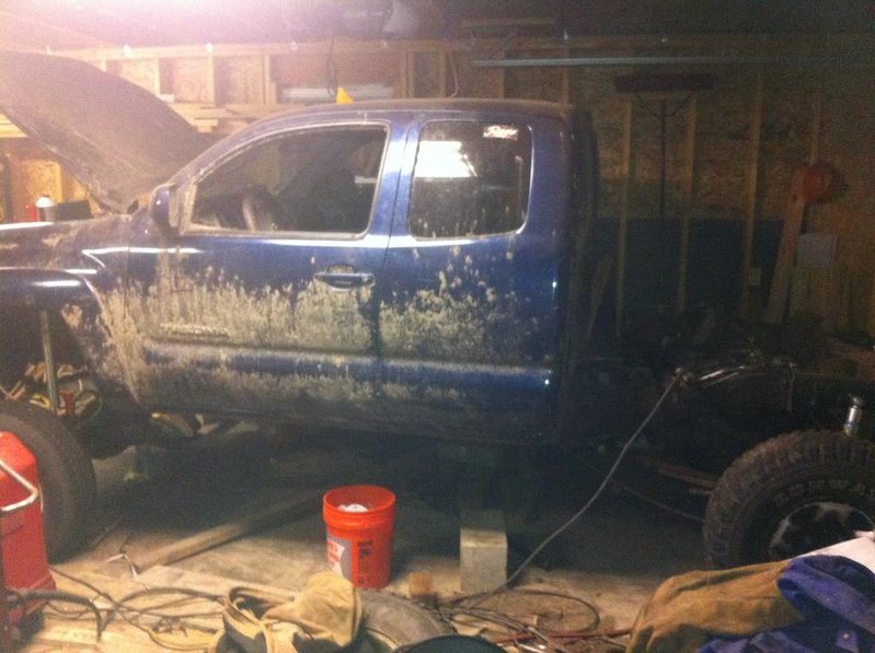

    Not completely finished waiting to get my driveshaft back and just ordered new calipers. Still gotta put the bed back on but for now...

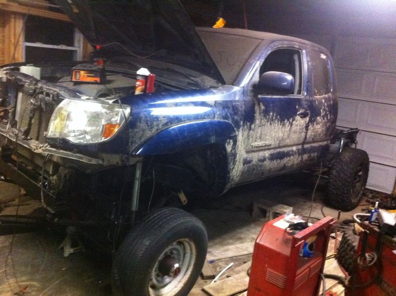

    If I can figure out the photo thing here goes. Rears are 33's front are 31's til I swap over my other 33's to those wheels

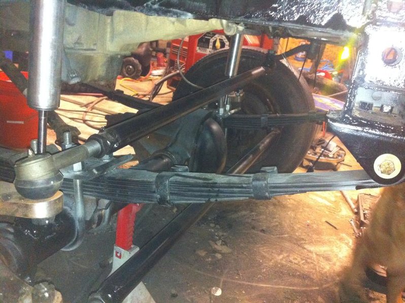

    Front, can't figure out mutiples
