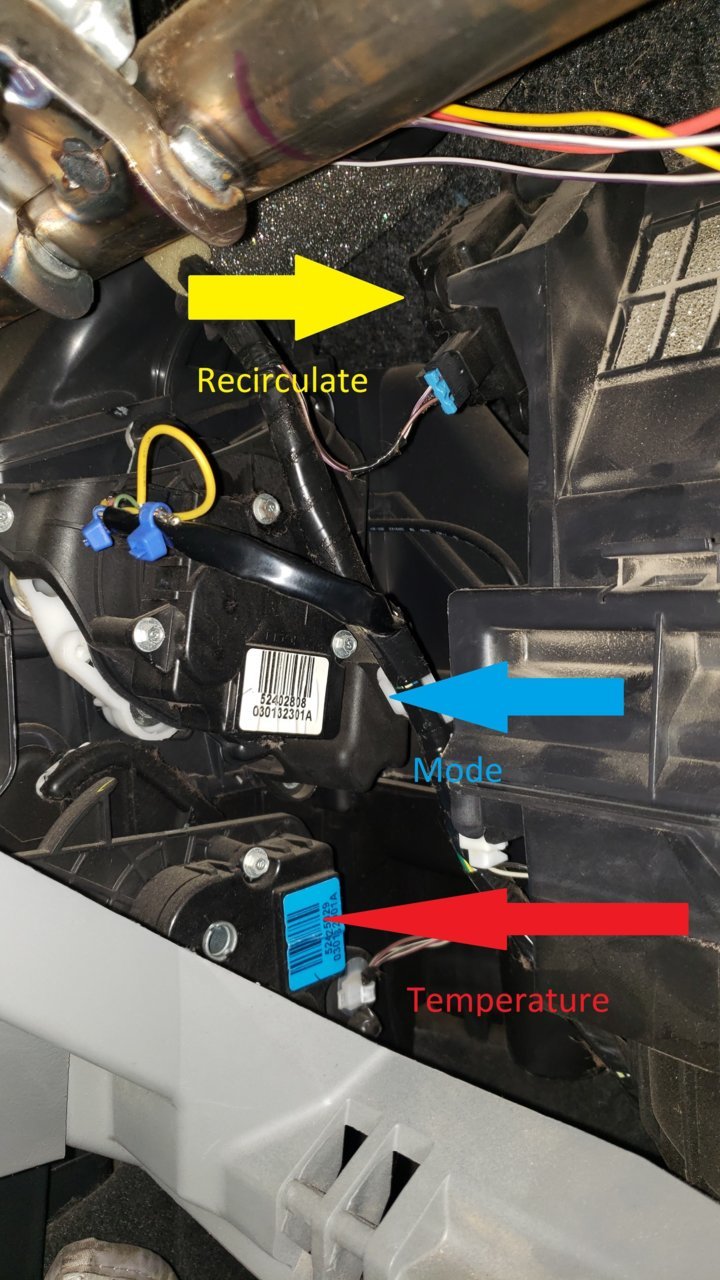

    The Mode Control Servomotor.

    Here you go with floor duct removed.

    See if the notch is lining up as I stated in post #13, if it is then you either have a broken door or something dislodged in the timing disk.

    OP do as @Dm93 suggested and see if the white circle with the notch moves.
    It should move from about 10 o’clock to 2 o’clock.
    If you notice, there are lines there, just for checking it:thumbsup:

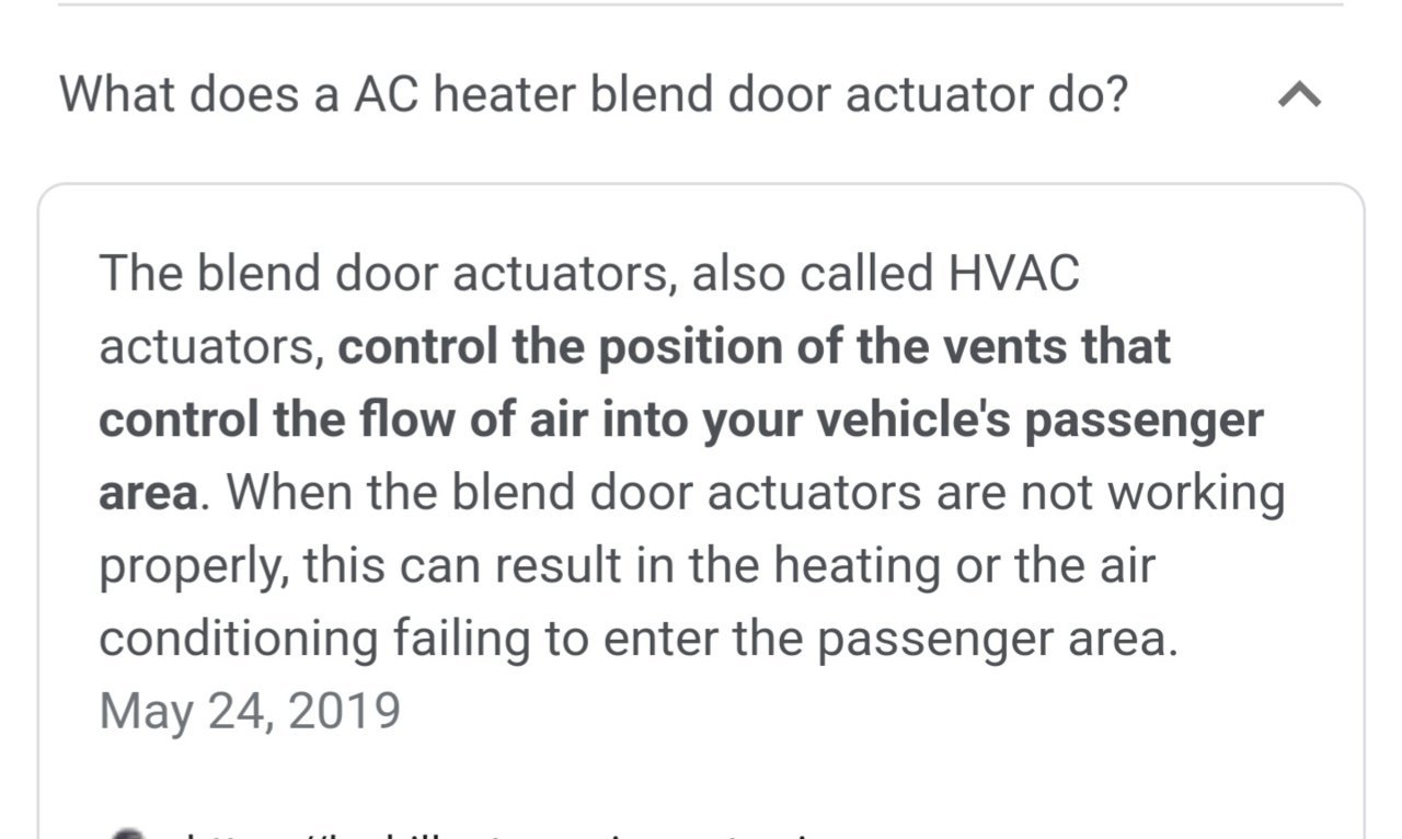

    Might have found the name of the part.

    They are all technically "blend door" actuators but they have different proper names depending on which door they move.

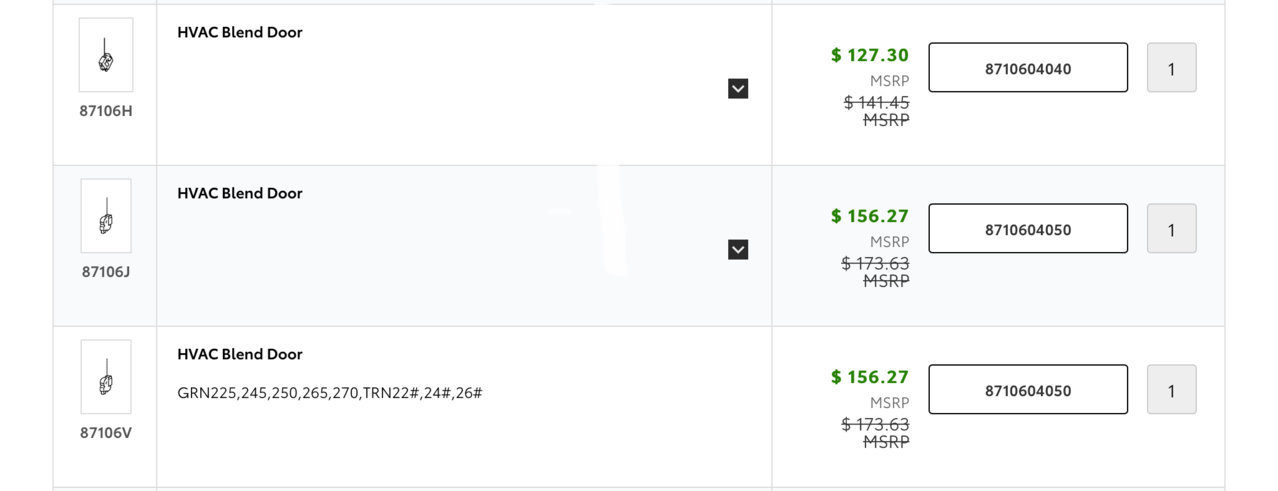

    STOCK
    That right. And if you call and ask for a blend door actuator.
    You have 33.3% chance of getting the correct one.
    Unless you can physically point to it on the screen, the chance you get the right one decreases drastically. Lol

    The best thing to do is give them the part number off the old part if it's available then you know you got it right.
