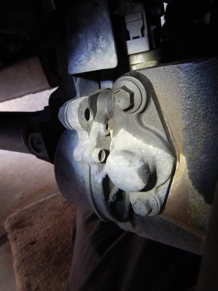

    Update : Battery is at Autozone charging and should be done very soon. But i grabbed a code reader and used a spare battery. It was giving me a 0500 ( vehicle speed sensor ) . It gave no other codes, but how the hell could one little sensor cause all this?? Autozone ordered the part $127 and will be here at 7pm tonight my time ( pst ) . I do remember seeing oil all over my rear diff and where those 2 electrical plugs are. Is that where the VSS is? Or is it actually on the transmission housing closer to the engine?

    This is the rear diff as I mentioned with oil all over the place. Can anyone confirm this is where the VSS is?

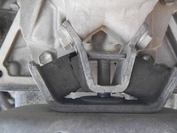

    Oh yeah I also found another nice surprise .... great.

    My guess is that the alternator took a dump and just happened to take out the speed sensor when it went.
    But that is just a guess...

    One speed sensor for ABS at each wheel. Speed sensor for the speedometer is on the tail end of the tcase near the output shaft for 4wd models
