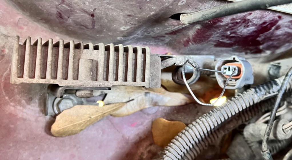

    very interesting. I am out of ideas, you need to put a pressure gauge on the fuel rail, and verify it is a fuel pressure problem. That is as long as when you say "I jumper-ed the resistor", what you really mean is that you jumper-ed the harness plug that otherwise goes to the resistor.
    Very strange that the symptom is such a perfect match, but the jumper does not solve the issue.
