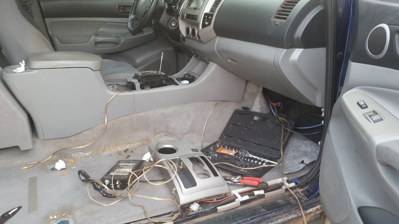

    Here's what I just installed this past week in my '06 Access Cab. I'm super impressed with how hard and how deep this box and amp achieves off of my Kenwood DNX-6960 deck.
    • Subthump single downfire box (you can order for a round 10" or square) - great depth for very large and deep sub magnets
    • JL Audio JX500/1D mono sub amp (500W RMS)
    • JL Audio 10W3V3-2 10" single 2 ohm subwoofer
    • 4 gauge amp install kit
    I used a clean, solid ground spot in the center console to handle the power. Positive cable comes straight from battery and passes through a grommet in the passenger side firewall (fuse installed inline close to the battery). I have no voltage drop at all from this setup, and after running the sub HARD for a solid half hour, the amp was barely warm. Very efficient, and the output shakes my eyeballs. I've had big stereos before, but the acoustics in the access cab matched with this setup really hit some powerful lows after you get your adjustments set right on your amp and on your stereo's crossover settings.
    Here's the box in place. I'm pulling out an old PA amp from under the passenger seat to make room for the JX500:
    Cleaned up and ready for amp install:
    Sub installed in box:
    Ready to put the seat back in:
    What it looks like with seat in place:
