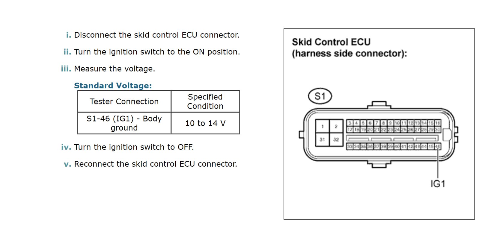

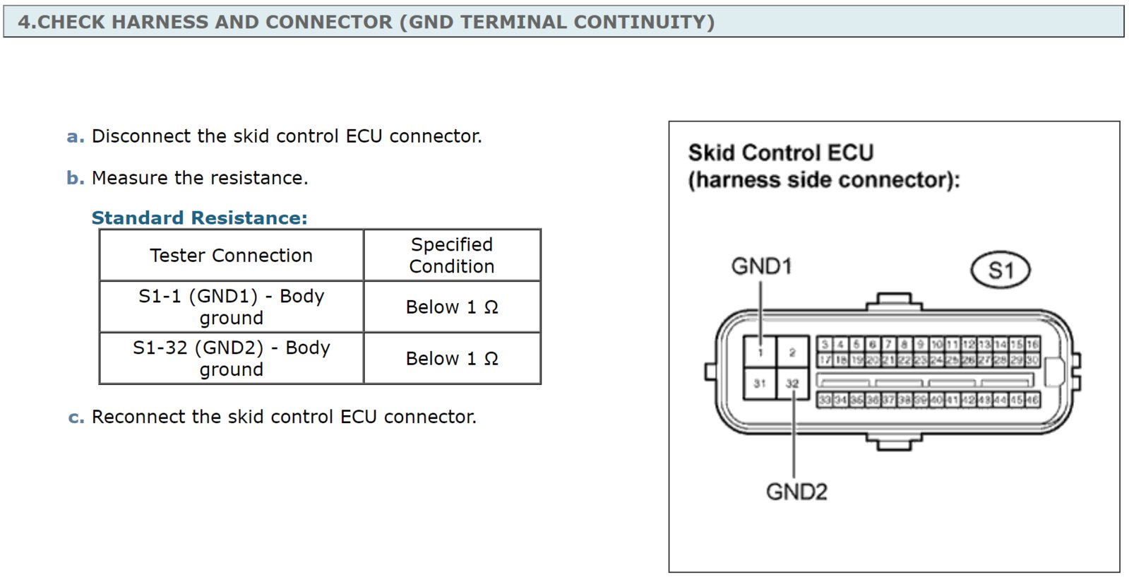

    Somebody hooked up jumper cables wrong and has had abs and brake light on ever since getting code c1241low voltage supply several people( not trained techs ) have been playing with this vehicle 08 tacoma 4.0 auto trans trd they have replaced the ecm and Al the fuses then they called me I can't find pin out on the vsc

    First thing.
    Are you sure the truck has VSC?
    If so, You'll see a VSC button on the dash.
    Next try the steps below.
