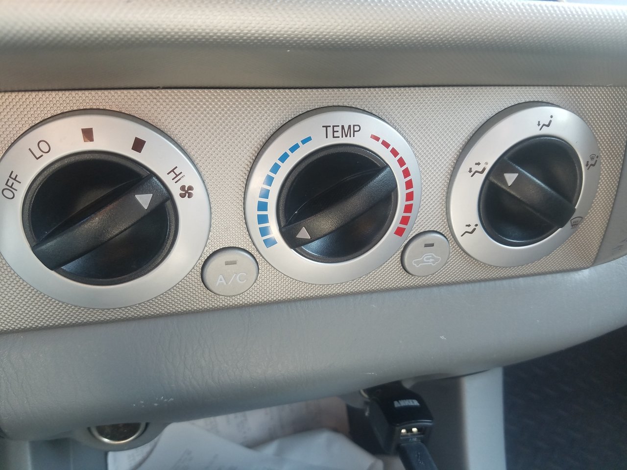

    Hi,
    Today when I had AC turned on and switched between medium and high speed it only worked on high. I was wondering if there was separate fuse for other speeds?
    Thanks!

    Check your wire harness to the fan behind the glove box. Make sure it isn't fried.

    Replace the resistor. It's a common thing. Search on here to find more info.

    OK, so this harness is located behind the glove box and it will be pretty visible if something wrong?

    OK, thanks. I will search for that.
