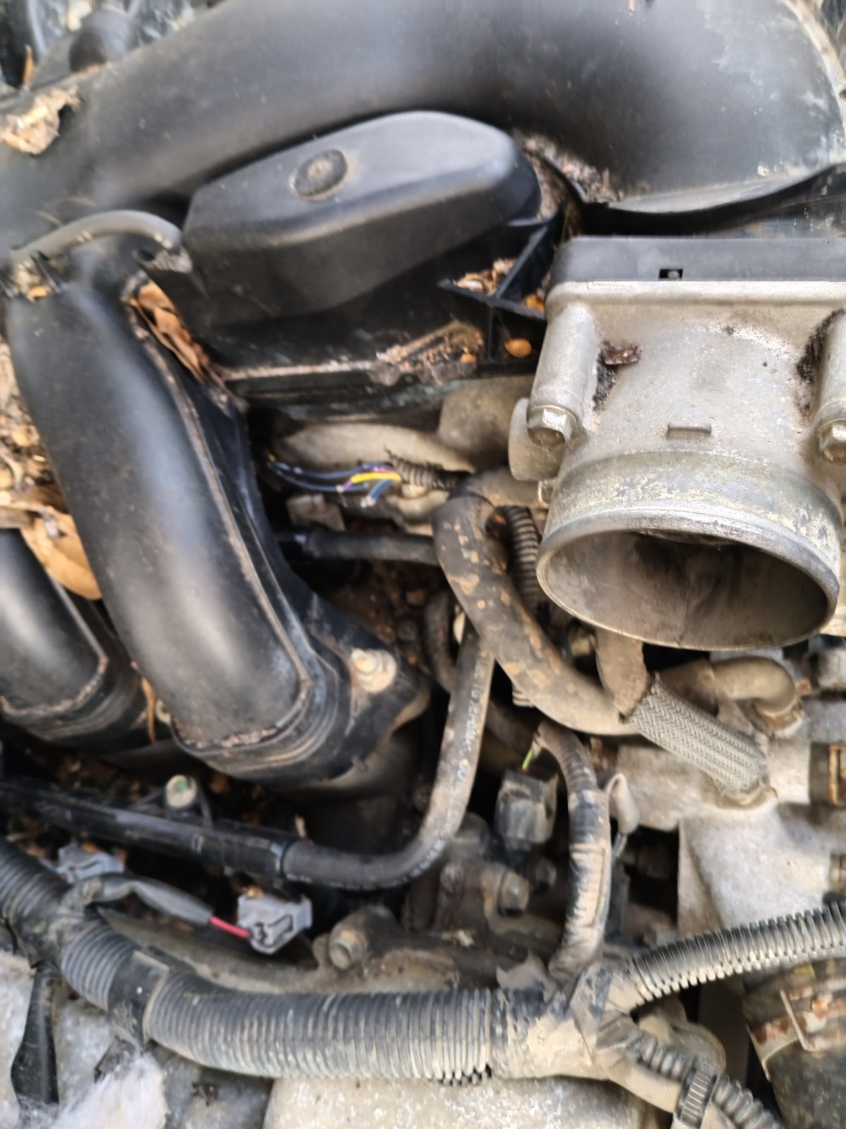

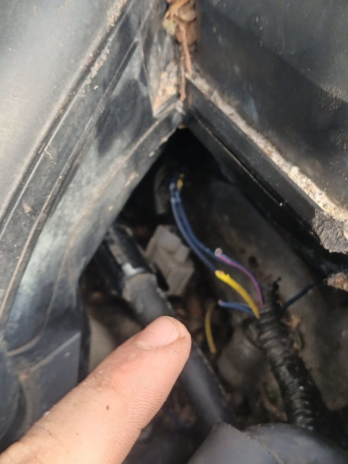

    Sorry this is super late but finally got time and got the truck pulled out of where it was sitting and confirmed yes there was chewed wires and yes I fucking killed that damn rodent that did it stuck a trap inside the engine bay and caught him. So I took my air filter housing off and was about to do the intake but these are the pictures I have and unsure what exactly this wires are called and what they are for. Once I have the throttle body taken off I'll post better pictures but these wires are underneath the throttle body thingy

    I can't see all the wire colors but best guess for the 2 I can see based on wiring diagram the Blue/Red wire goes to the Bank 2 Oil Control Valve and the Yellow wire is the #6 Fuel Injector, neither of which should cause a no-start.
