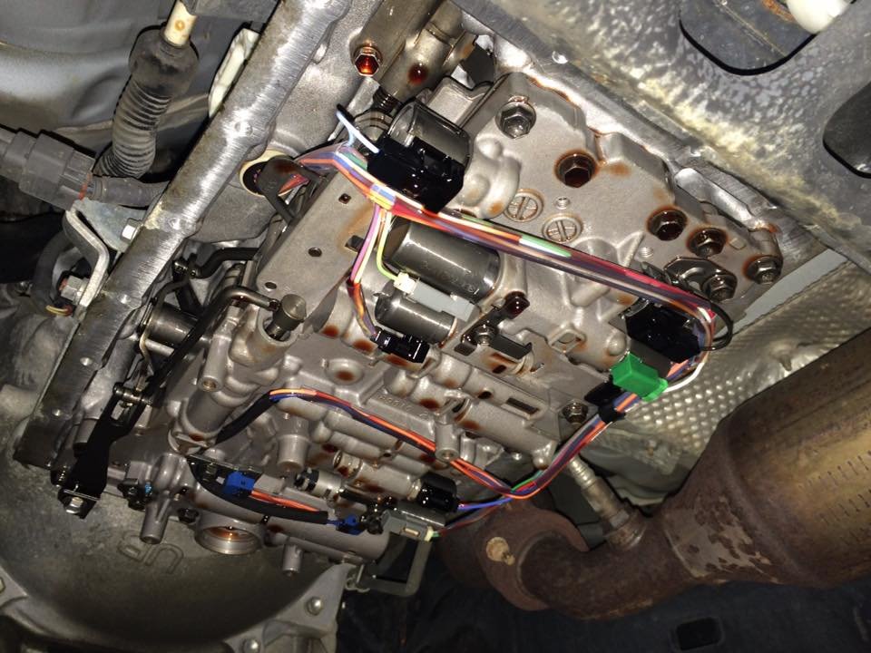

    My '08 has 271k, was a service truck for a forklift company, all services done BUT the trans fluid (because Toyota said it didn't NEED it)
    i bought it at 255k, drove it to 262k and decided to service trans, only because my own curiosity was getting the best of me.
    clean, there was very little debris in the pan, 6 magnets in the pan had some, but nothing unusual or surprising. i was more surprised how much it didn't have in the pan.
    You see the fluid drips, slightly dark but still red, no burnt smell at all. Use Valvoline MAXLIFE to flush and fill.drives well, tows well, trans temps are 130°-170° in normal driving
    I've serviced GM transmissions with 30k that the pan and fluid looked like it had been there for 200k. (and smelled like it).
    If its driving well, and shifting well, you'll have no issues either way.
    the "filter" is actually a fine screen, DO NOT get a kit with a cork gasket.
