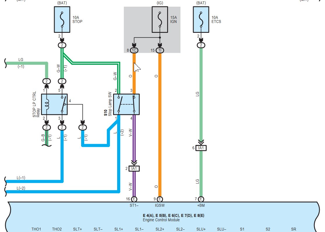

    The below circuit is the Cruise Control Circuit.
    I would check the Stop Fuse and the IGN Fuse with a meter or test light. Do not trust just looking at the fuse.

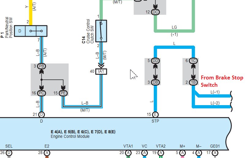

    1B and 1C plugs look to be common between some of the components.
    Just throwing that out there for Jimmy and Muddin.
    You guys are the go to guys on this stuff.
    Thanks Guys.

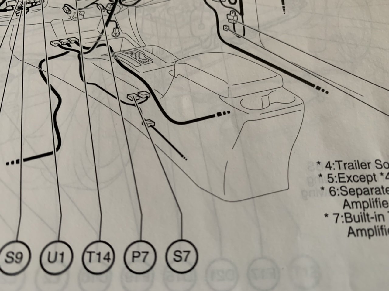

    In case you need to know where the shift lock control ECU is, it’s S7 in this pic. This would be helpful if you exhaust all ideas and need to check voltages at the ECU.

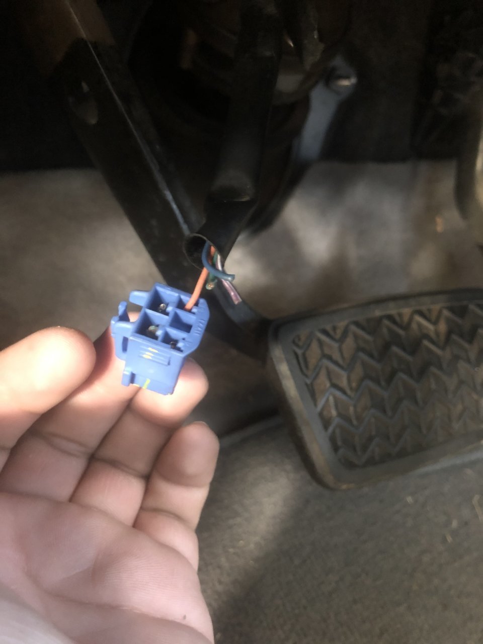

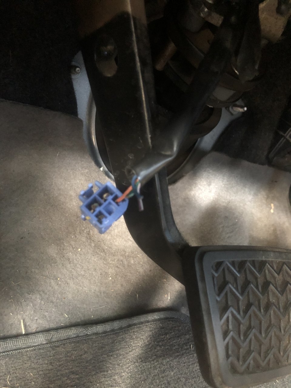

    Ok so I went out and bought a tester light. All fuse lights turned on except the inside cabin tail 10A. When I removed the fuse and tested the fuse it lighted. I then removed the brake light switch and noticed the wires to the connector got severed. At first it was just one but then 2 more fell off. I called Toyota and ordered the wire and connector. I asked if this might cause the truck to stay locked in park and he said no. What do you guys think? Any of you guys replaced this part before?

    TnShooter
    TnShooter The TacomaWorld Stray
    Sep 2, 2010
    #42625
    21,148
    Deogee
    07' TRD Off-Road, Auto
    STOCK
    Yes.
    If your foot isn’t on the brake, how are you supposed to shift from Park?
    If the switch is not working the truck doesn’t see your foot is on the brake.
    So it won’t shift from park.
    At least this is the easiest way for me to explain it.
    Jimmyh likes this.
  17. Feb 12, 2020 at 5:24 PM
    #17
    Jimmyh
    Jimmyh Well-Known Member
    May 16, 2012
    #78991
    14,269
    SC
    2012 Prerunner SR5
    The guy that you asked if that would cause the truck to be stuck in park is an idiot or he didn't understand the question.
    In order for the shift lock to disengage the brake pedal must be pressed. If the wires are cut it will not see the brake pedal pressed or not.
    Now that leads me to ask what cut the brake switch wires?

    Since the wires are cut, strip some of the insulation off the green/white and blue wires. Twist them together and see if the brake lights come on. Then push the brake with the wires twisted, start the engine, and see if you can take it out of park. Don't try to take it out of park with your head under the dash.

    I noticed that I don’t have the cover that covers the column going down from the steering wheel. The cable would hang lower than my buddies which we are thinking would sometimes get caught by the brake being pressed eventually severing it
