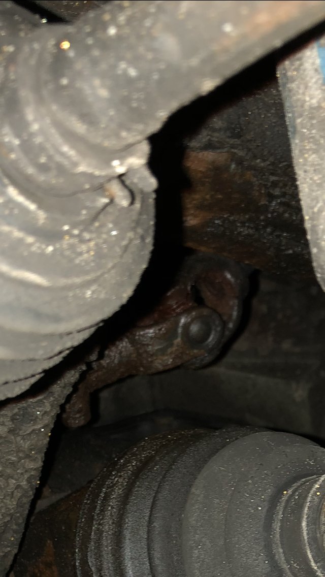

    Check the intermediate steering shaft joint. May need to be replaced.

    This, it is a growing topic plenty of posts on it.
    Crank your wheels left.
    Drivers side above axle.
    Just a heads up maybe it’s just me but!!
    I cleaned kinda, and greased that joint. Wish I didn’t I went from having to turn it where I wanted the truck to go to having a sloppy spot loose floating feel in the steering wheel.
