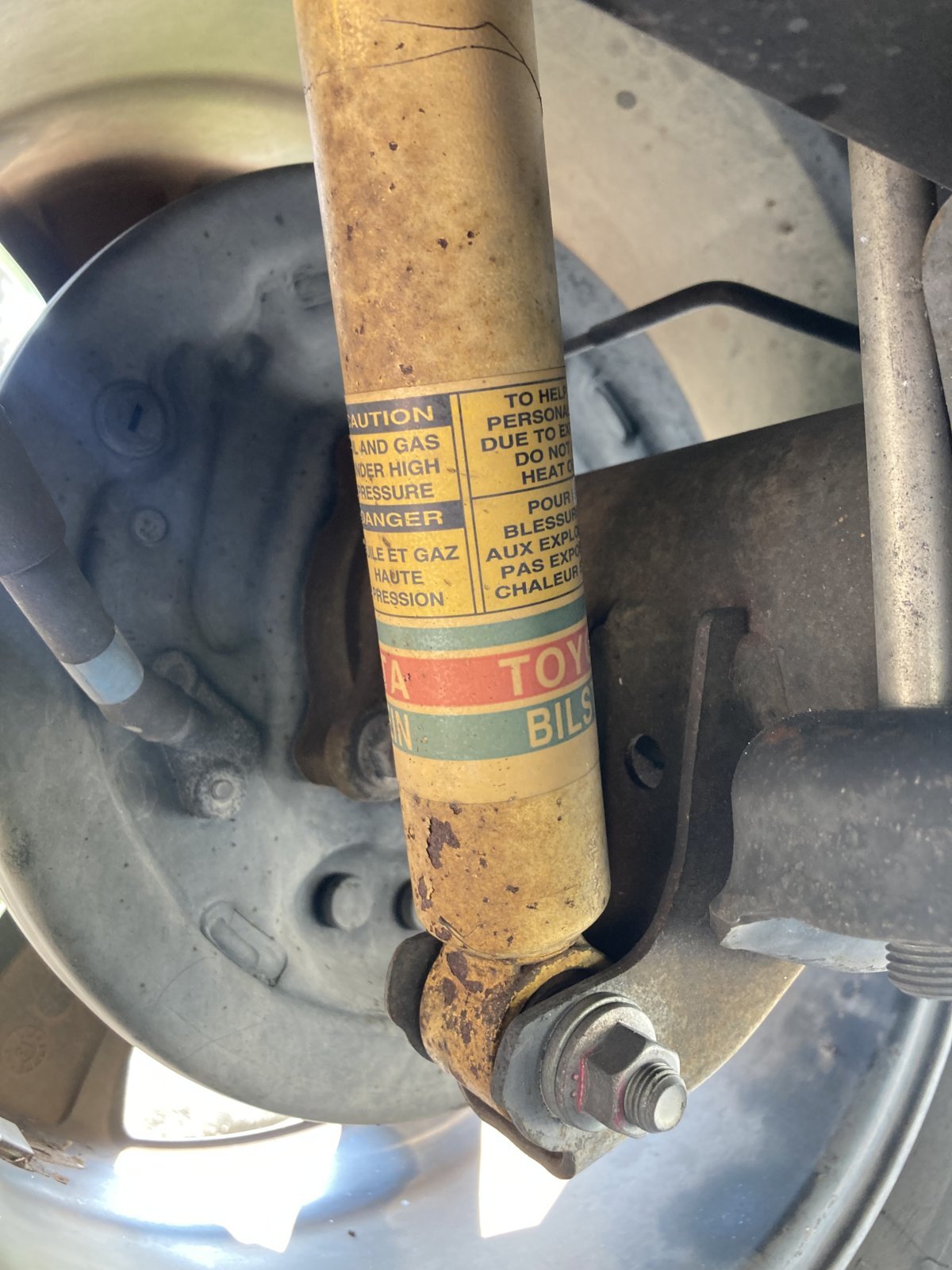

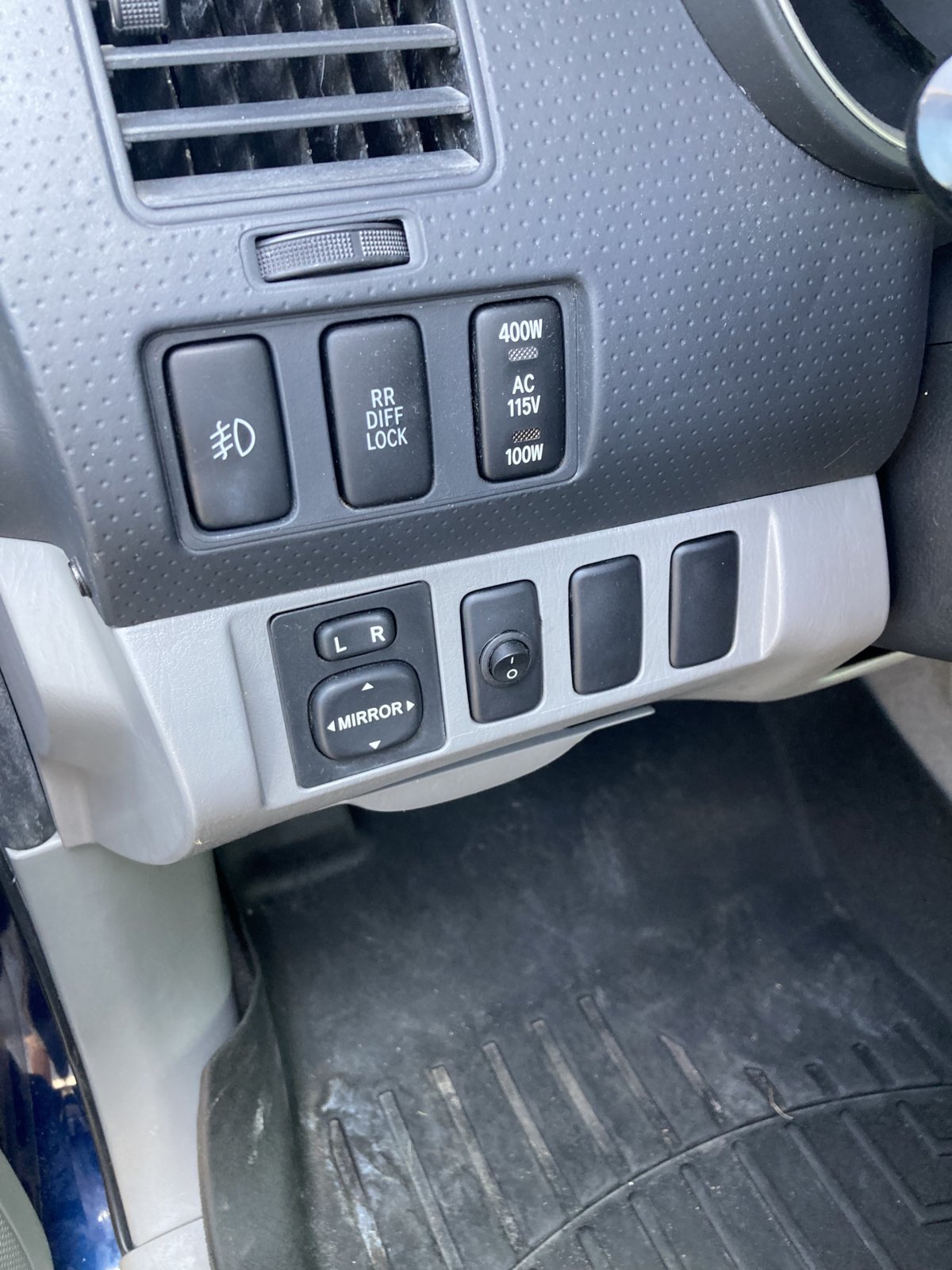

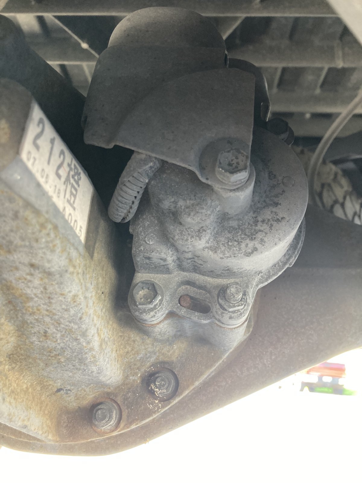

    Apologies for the late response, I have send pictures above (I sent them more than once on accident) but I noticed it also had the Toyota Bilstein shocks that come in the trd off-road. The only confusion is that the vin shows only the towing package and not the trd package.

    Looks like an off-road to me.
    Might as well be…..

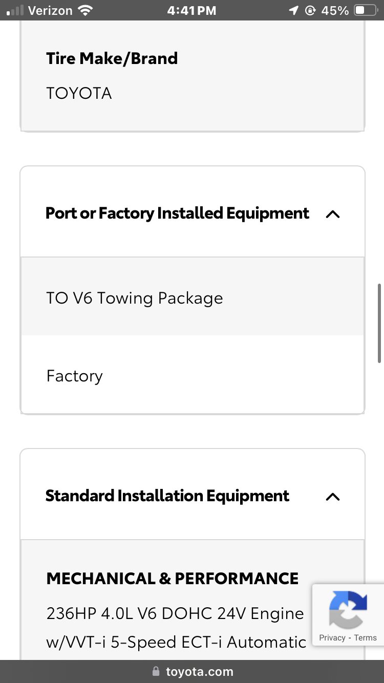

    Yeah that’s why I’m confused.. I’ll post a screenshot but I looked up the vin on the Toyota website and it doesn’t say anything about the locker but all the wiring and the actuator look just as old as the rest.

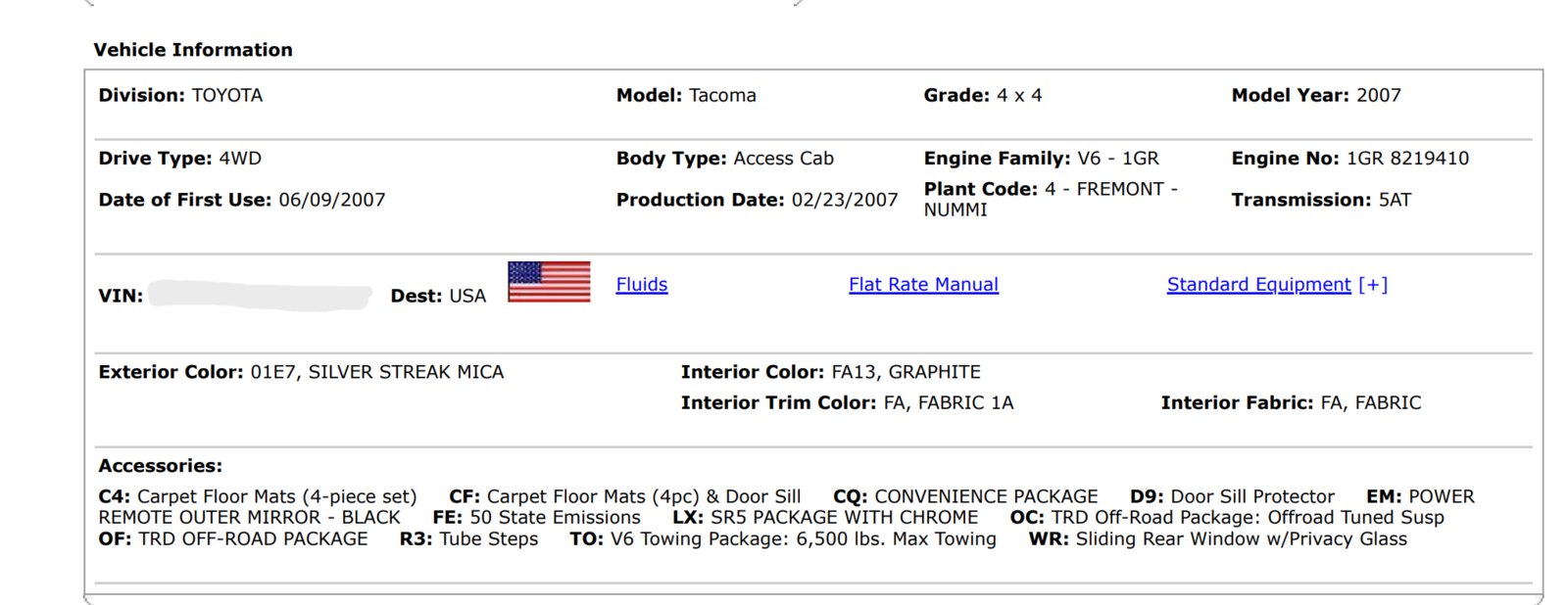

    Toyota changed their detailed specifications a few years ago.
    You need some one to pull an in depth report.
    Here is mine

    Is that the same website or a different one?

    Different. You need someone with access to Toyota TIS.
    You can signup for a 2 membership for $25
    It's only worth it if you save all the service data you while you have access.
    Not sure it's worth $25 just to find out if you have an Off-Road or not.

    I should note, the membership also shows all the TSB and recalls the truck has had done to it.
    So maybe it is worth it to you?
