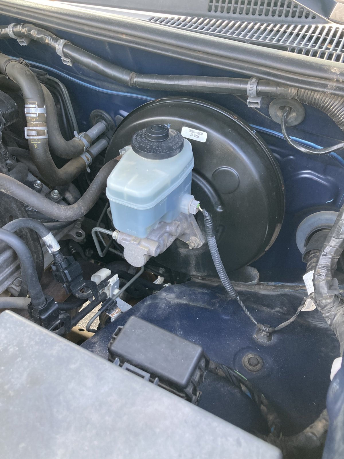

    Share some photos of the brake master cylinder under the hood (drivers side, firewall.)
    I think the TRD OR's have a hydraulic booster whereas most other Tacos of that vintage have a vacuum-assisted booster? Or something like that. An expert will chime in here to correct me if needed.

    Hydraulic only on models with A-Trac

    IMG_5791.jpgIt’s definitely vacuum assist

    My OR has the vacuum system. My truck was pre-09. No VSC or Traction Control

    That's the vacuum type system. But you could still have an off-road.

    A-TRAC (only on 4x4 Off Road TRDs from 2009 and on) requires the hydraulic brake booster.

    Looks like a legit TRD Offroad to me.
    The TIS lookup seems kind of hit or miss on what it shows, some trucks it shows alot of detail but others it doesn't.

    The Hydraulic booster was only standard on 09+ TRD OffRoad models unless you had a pre-09 with the rare VSC/Traction Control option.
