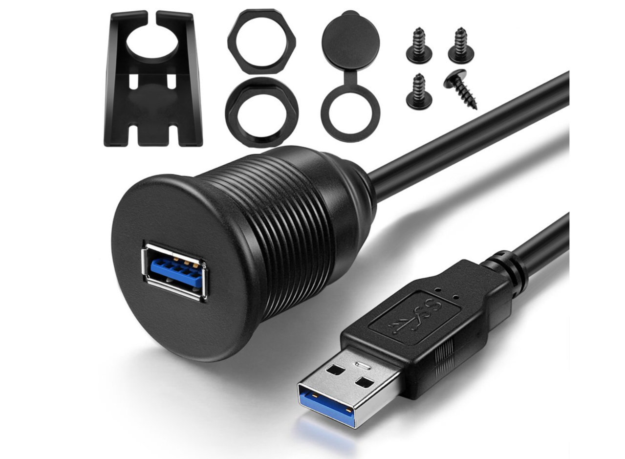

    yeah that was my thinking since I took it out of the dash and couldn’t believe how little space was behind there. I actually have it partially hanging out now bc I can’t stuff it all back there lol. Here’s what I got usb extension wise. I actually ordered 2 from Amazon bc I didn’t know which would fit best. My beneath climate controls are only the 2 cigarette lighter adapter ones. No squares. I’m hoping one of them can be converted to a USB port.
    ICESPRING USB 3.0 Male to USB 3.0 Female AUX Flush Mount Car Mount Extension Cable for Car Truck Boat Motorcycle Dashboard Panel -(3 Feet - 1 Meter) https://www.amazon.com/dp/B01NAMU8KY/ref=cm_sw_r_cp_tai_dHxeEbXE41PQM
    RAYSUN 3 Feet 1M USB & 2RCA to USB & 3.5mm AUX Extension Panel Flush Dash Mount Cable- USB AUX Dash Mount Car Boat Motorcycle (1M USB & 2RCA Dash Mount) https://www.amazon.com/dp/B01HJ6Y724/ref=cm_sw_r_cp_tai_aLxeEbG6GD8RF
