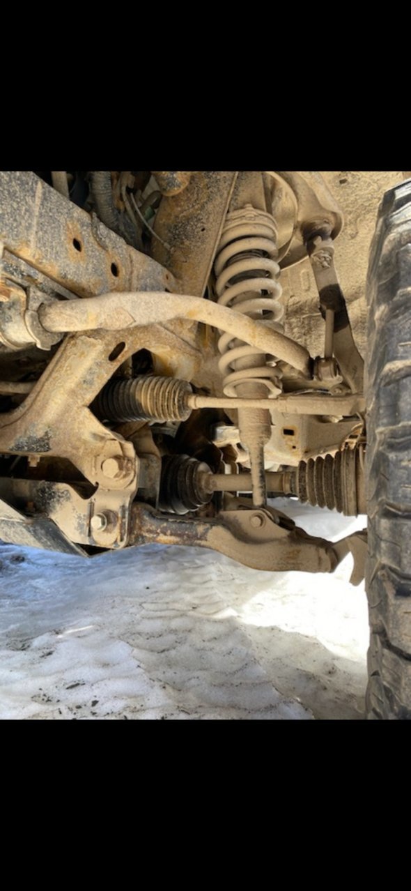

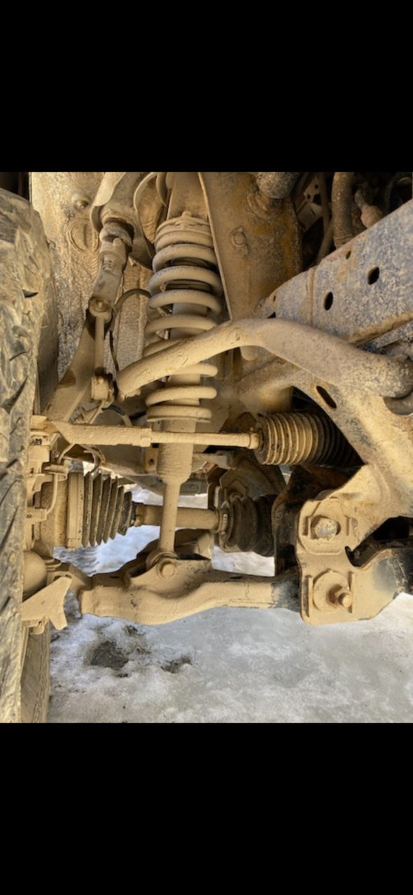

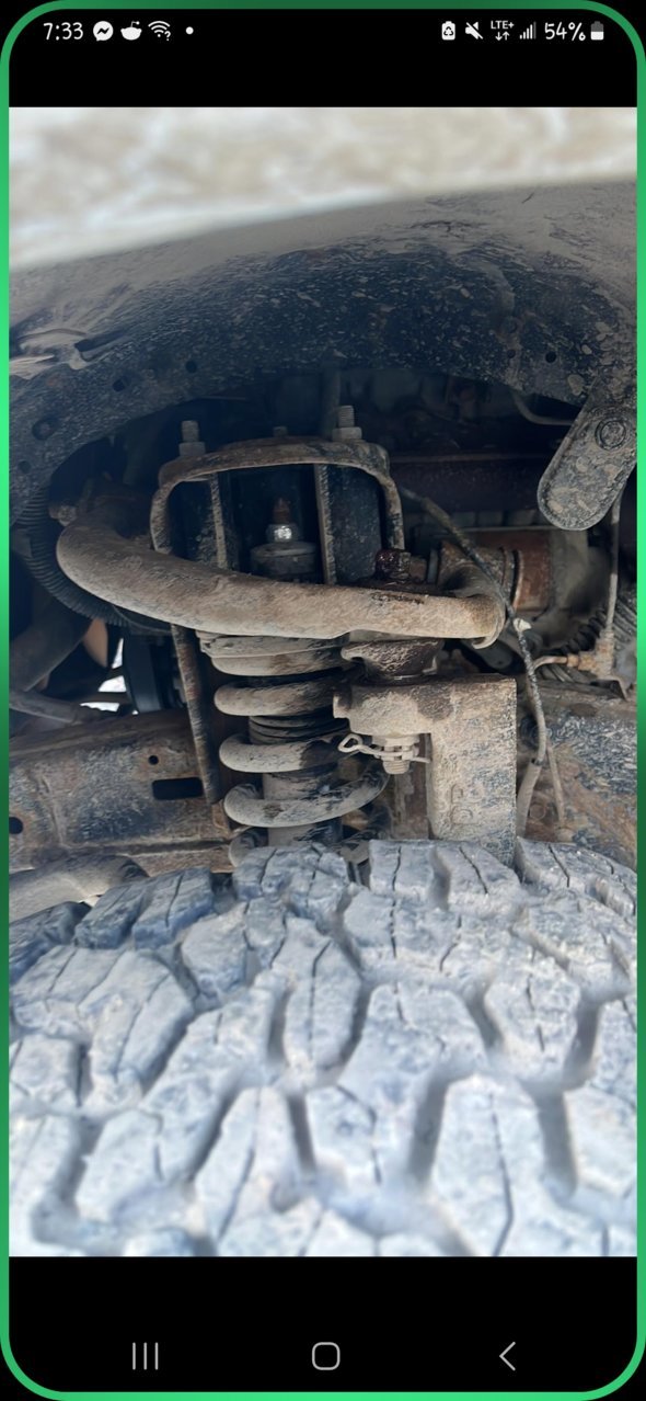

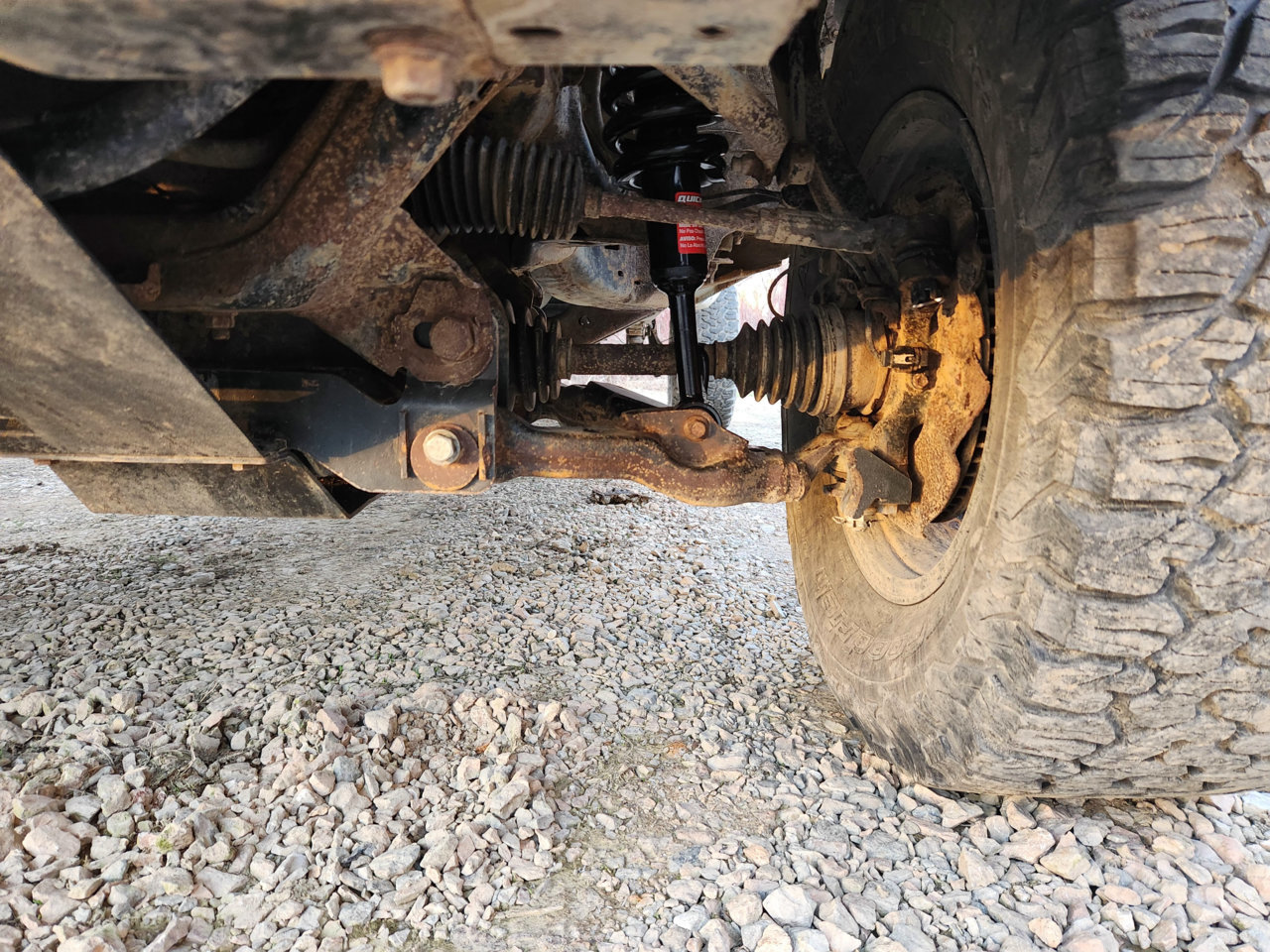

    My dad sent me these pics as my truck is at his house as I parked it after a 4x4 run. He forgot to send the upper control arm pics but I'll try to get them. Tryna get this all done before nightshift starts haha.

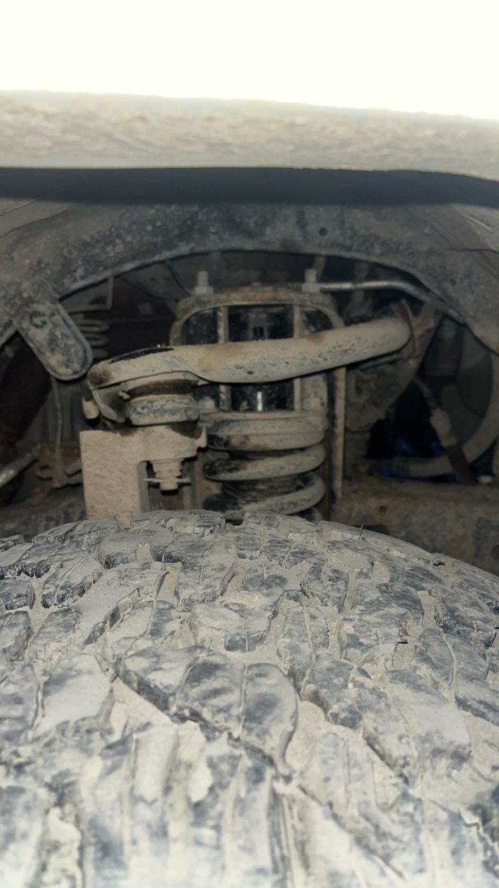

    Here is driver side control arm

    Passenger side control arm upper

    so you are saying that the front is lower after the accident?
    if so, it can be only a couple of things.
    spacer is diffrent
    knuckles are diffrent
    spring is diffrent
    something is very bent.

    Kinda looks like driver side shock is bent

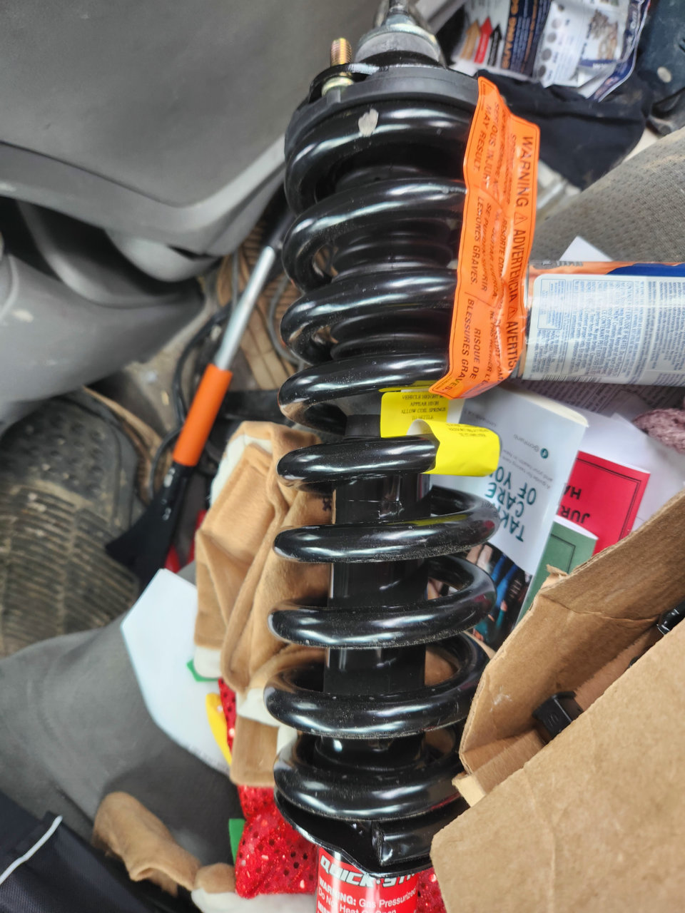

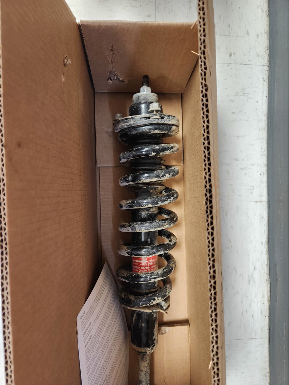

    I've finally figured it out! Canadian tire mustve sold me the wrong struts or Monroe packaged them incorrectly. They were lifetime warranty and I brought them back they had another set in stock and they look the same but what I noticed is the coil has 11 rings on the new ones and the old ones had 8. I installed them and boom axle angle is straight. Also I am aware the right side strut is sitting a 1/4" lower I guess the guy who owned it before me broke the bolt and shoved a smaller one in. Tomorrow I'll be ordering 2 original ones from Toyota to fix that.
