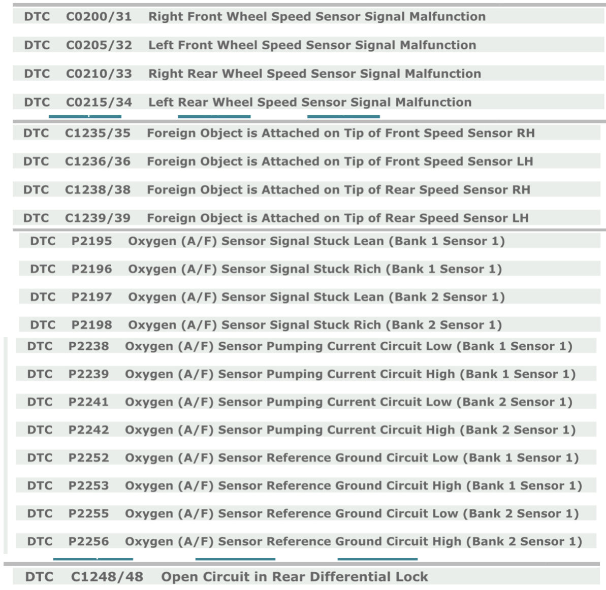

    I have a 08 Tacoma pre runner with 152,000. I purchased it used one owner in 2020 with 119,000. Recently my abs like get came on. The following day my truck would not shift past 3rd gear. Any thoughts on what could be going on?

    Thank you for getting back to me. I have a few codes p2197,p2241,co200,co210,co215,c1238,c1241. I believe my transmission is sealed?

    You have a number of problems.
    They may or may not be associate with each other.
    I haven’t had time to read through the diagnostic.
    But a wiring issue, or abs module malfunction may be at play here?
    That’s a lot of speed sensors codes all at once.

    I don't believe any of those codes would cause a shifting issue, assuming your truck does not have VSC the ABS codes would not have any effect on driveability.
    AFR sensor codes possibly could if there is an actual lean condition but the circuit code appearing with the lean code suggests a failed sensor or problem in the circuit.
    Does it attempt to shift and run away or does it just stay in 3rd and not attempt a shift?

    P0051,and po333 are showing up as well

    0051 and 0333 are indeed on the fail safe list.
    I’ve never had mine go into limp mode.
    But I do know it limits RPM and throttle response.
    Pretty sure it cuts all timing as well?
    I’m still looking, but I think I’ve heard people claim it does something to the shift sequence as well on the Automatic.

    All it says for P0333 is it retards ignition timing.
    If all these codes appeared at almost the same time I'm thinking rodents...:bananadead:

    Yeah. I was leaning that way too.
    Even more so now that there’s a knock sensor code.
    I have no idea why, but they like to eat the wires to those?
    Must “taste” better than the rest?
