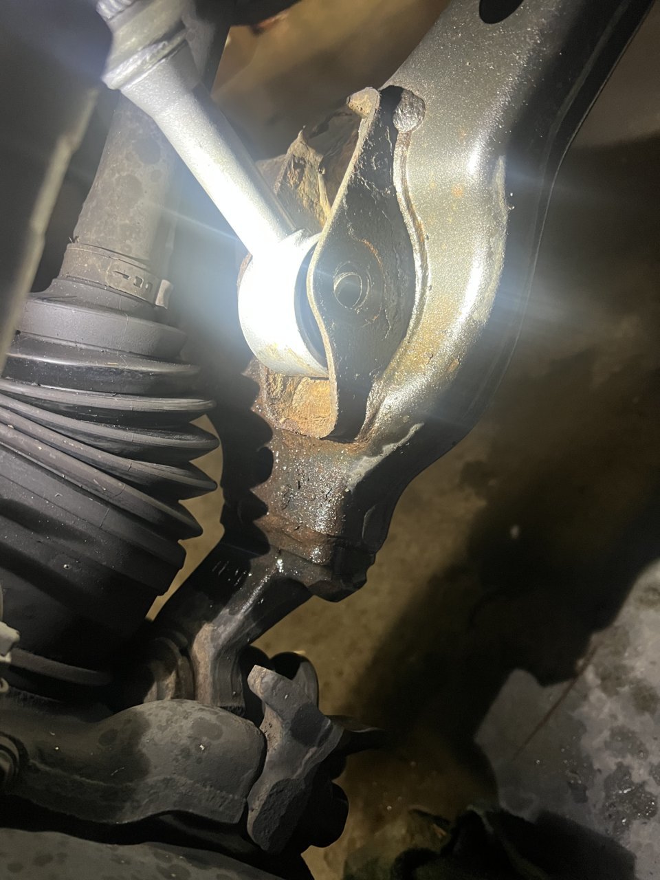

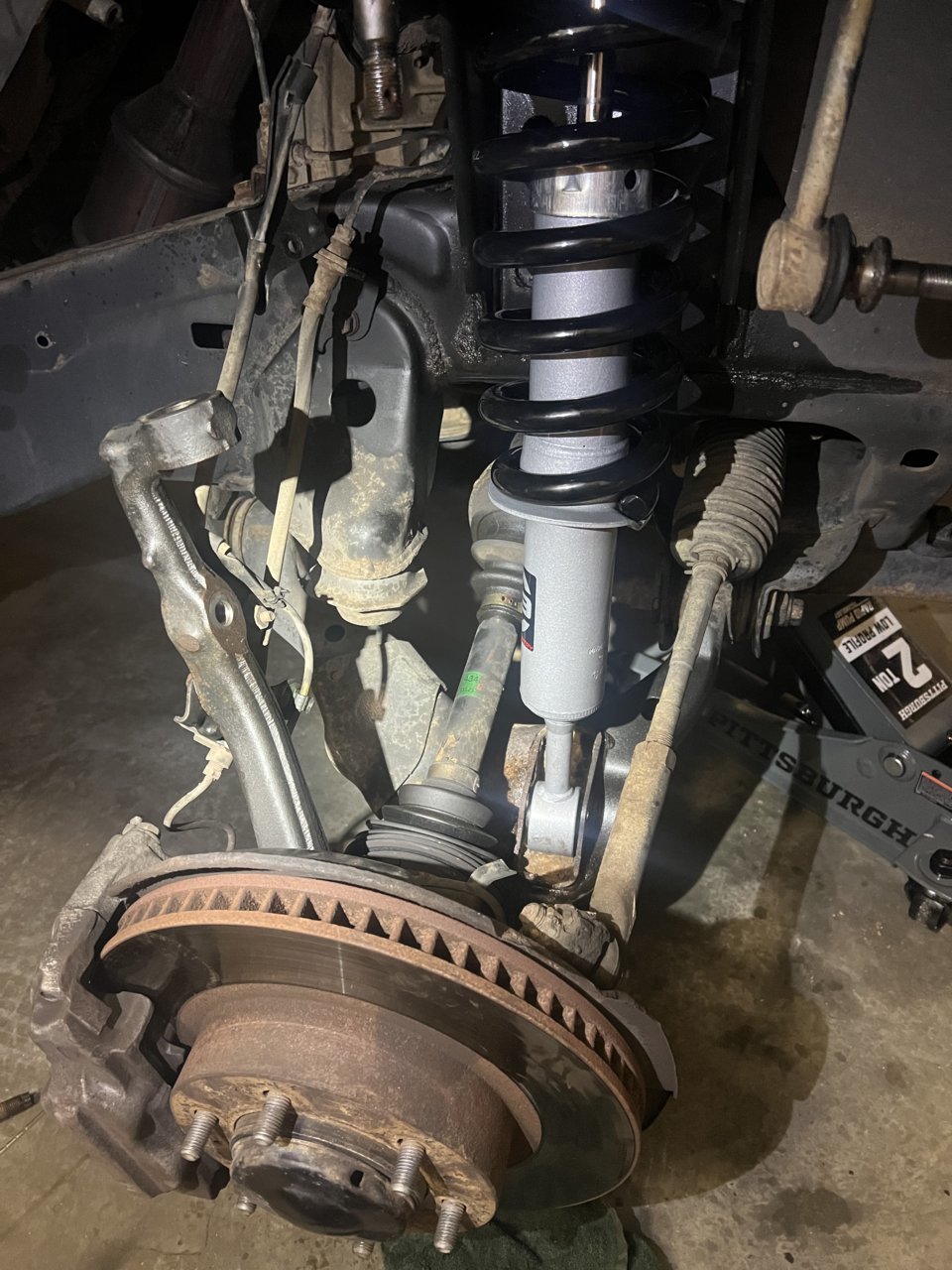

    This is currently what I’m dealing with.

    Lower control arm won’t drop any further and I feel like even if I got the bolt through that it would stay dropped and not be able to reconnect knuckle to the uca
