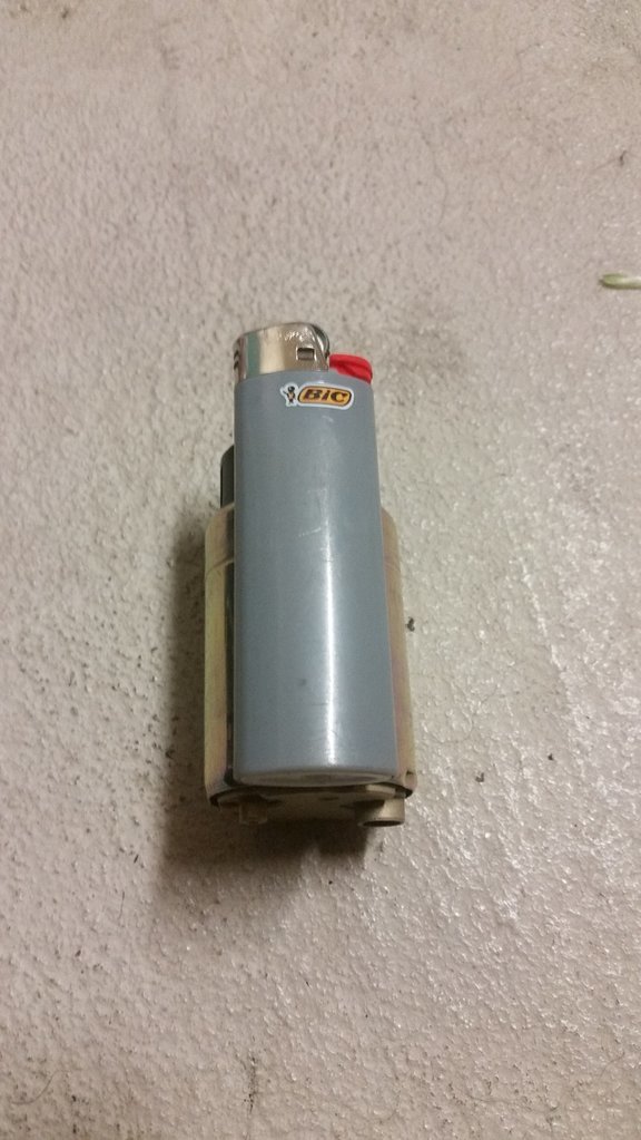

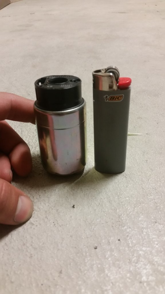

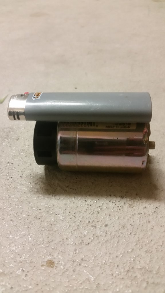

    All I'm saying is that she should be aware that she MAY have a larger issue at hand and should either check it out or get it checked out to make sure she doesn't end up in the same boat as I did that night.

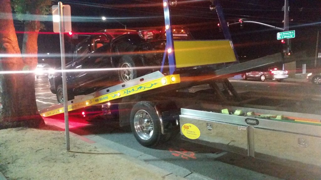

    These were the exact symptoms I was encountering maybe 30,000 or more miles before mine failed. Mine failed at 50K if I remember correctly. I also encountered a ton of knocking and pinging at acceleration.
    Now it is also possible that at mid point or some point in the 2nd gen years they changed the fuel pump supplier, or design, or may have opted for a smaller one. We live in a society where going smaller is in, manufacturers want to try to cram so much into a package and reduce it's size simply to say it is good tech and "look how far we have come." That's not always a good thing you know?
    I see it's not a common issue on the site for sure, as I have been frequenting since 2012 when I bought mine, but it is an issue that I'm sure many don't know about simply because they don't take a fuel pressure tester just for fun and monitor it all at cranking, idle, and as they drive. I'll tell you first hand that a fuel pump was the last thing I would had wanted to mod, and replace on this truck. It was the last thing I would had expected to die on it also.
