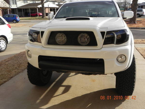

    Got tired of my front plate this weekend so I decided to take it off and I made some color matched plugs to cover up the holes in the bumper. I also added a 13" antenna from antennaX.com.

    What headlights are those?

    FX-R HID projector retro

    Nice. What did they run you?

    I have the FX-R stage IV with phillips 85122+ bulbs so total the kit was about $400 plus the cost of a second set of headlights. These are custom lights that I made they are not plug and play. You can find all the components at theretrofitsource.com there are cheaper options out there but I wanted to have the best.

    Looks BA man

    Thanks man
