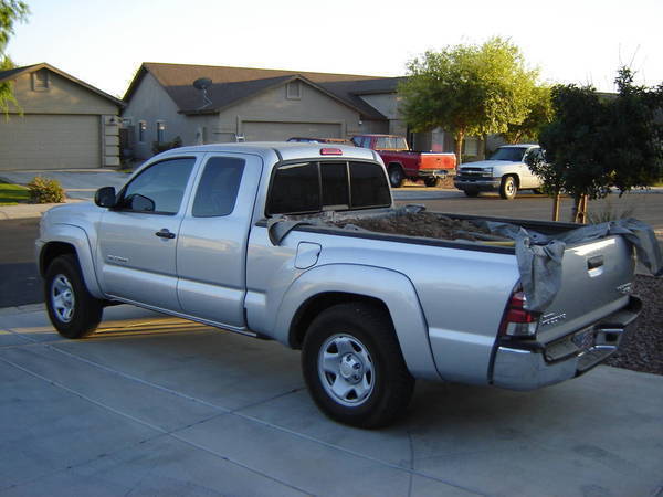

    Thanks for the rep. The ride is no where near as rough as the Ranger I test drove before I bought my Tacoma. It is not a rough ride at all. And trust me, it is worth getting done. Here is proof.
    Even with the bed loaded to within an inch of the bed rails with dirt the truck did not bottom out, and the ride was still as good as it is unloaded. Enjoy.
