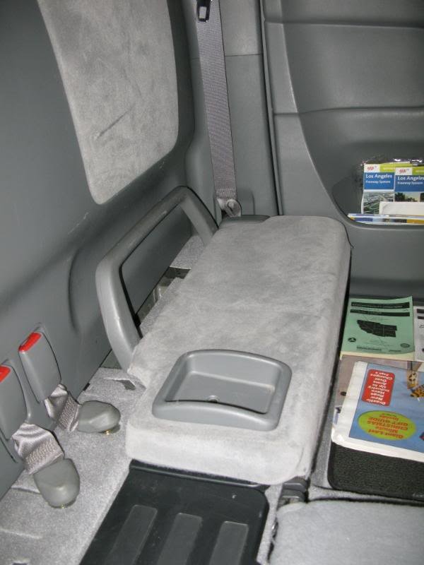

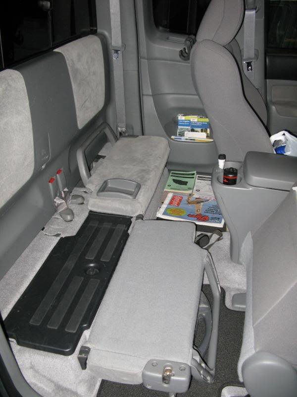

    There is not a washer on those 2 bolts (hump side) if that's what you are refering to. Unless there's a lock washer under it... which would make no sense lol.

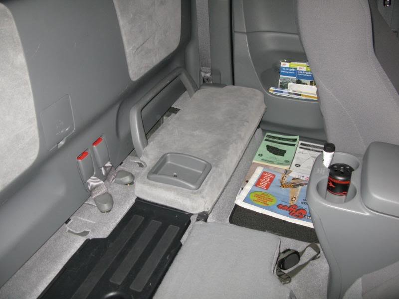

    Drivers side is a negative for child seat (also no latching point above, only pass side):

    So awesome. Thanks for the pics. Seat covers may be a good idea for me. Are those wet okole? Do they allow access to those plastic areas in front of the female seat belts in the middle?

    Yea they're wet okole. The only downside is they make them a bit hard to close and lock (though I could probably mess with the adjustment a bit and make it easier). Still looks better though and easier to keep clean lol. They don't restrict access to anything.

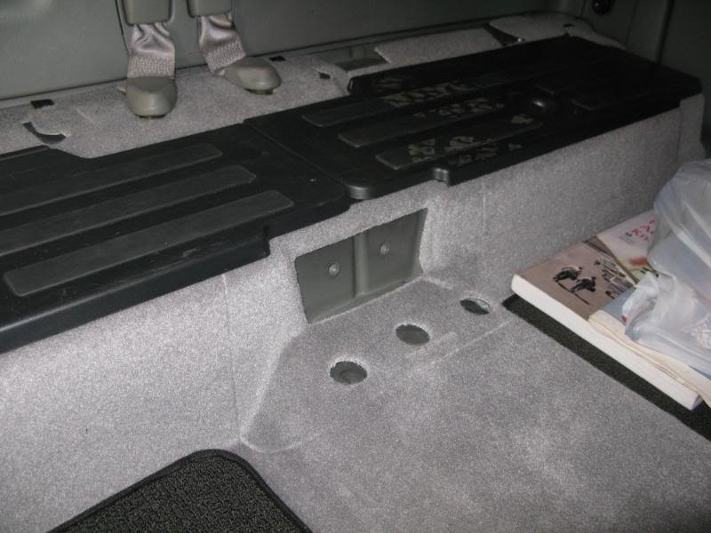

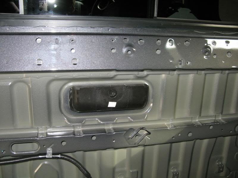

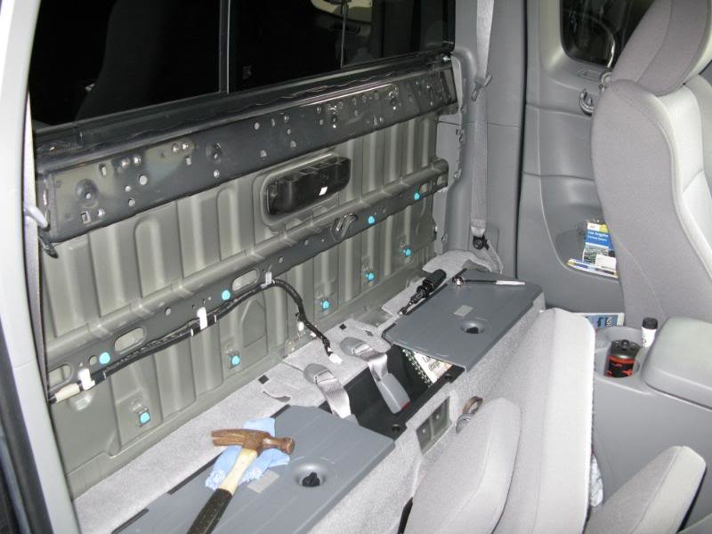

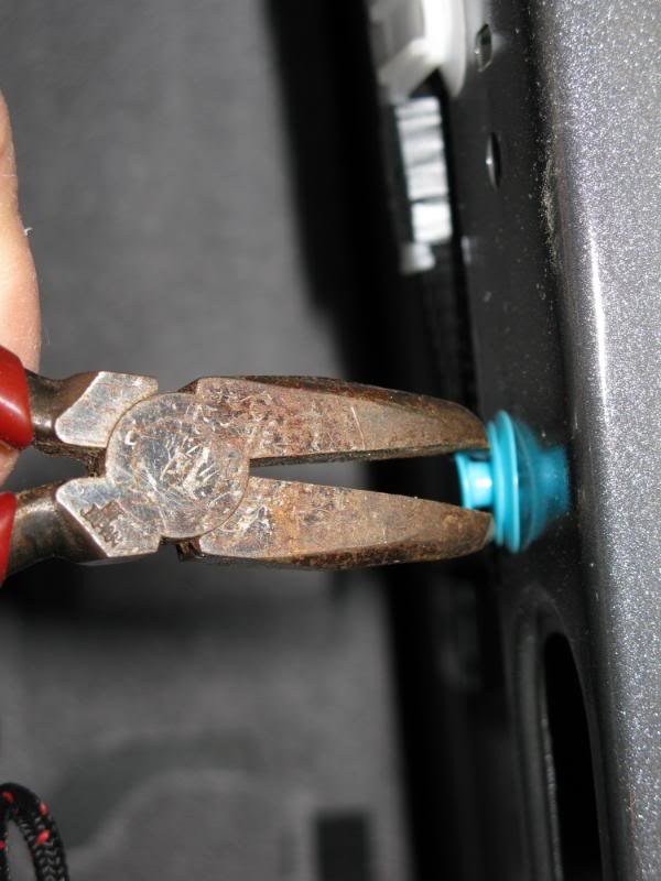

    So here are a crapload of pics:

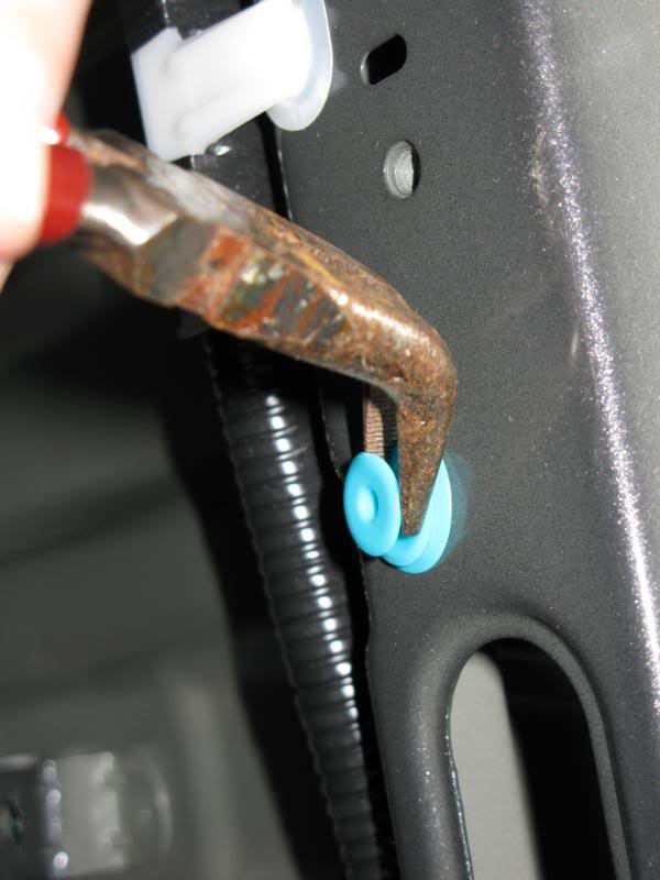

    Pic of the rear bulkhead with blue tabs from plastic cover which need to be removed and put into the new cover if it does not have them.
    Remove the tabs using a curved needle nose (yeah I know it is rusty)

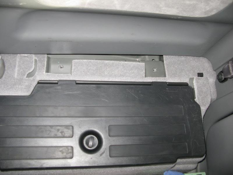

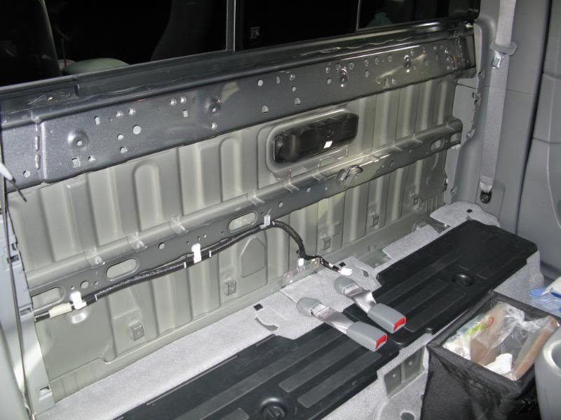

    Rear bulkhead minus blue tabs
    Strange vent on the rear bulkhead

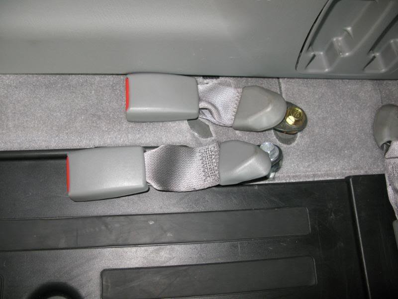

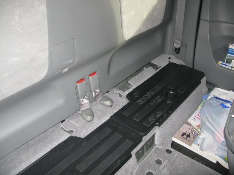

    08(short)-09(long) seatbelt comparison
    Bulkhead cover, storage covers, seatbelts installed. This pic shows the empty spaces where the 09 middle cubby is bolted and the carpet is missing from where the 08 has carpet at the mount point for the seats.
    09 Driver side seat showing missing carpet compared to the 08

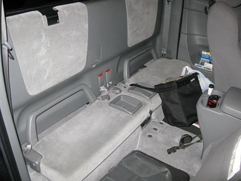

    When I saw the new config rr AC seating, I thought I wanted to swap out with someone with 09-10 but that was before anyone had chimed in about the practical usage of that area. Seems as tho Toyota tried to make it a shorter version of the DC. Didn't work IMO. Might be better for someone with small kids riding with them often enough to justify it, and I mean small kids. It would be better seating for them than the 05-08 setup, again IMO, but other than that wasn't gonna do swap just so I could haul a person on occasion to lunch while at work without them having to crouch like they are on a camp crapper. Too bad, someone else with an actual back seat can drive, and they do so another win for me. I don't have any kids small enough that the rear will do any good being set up like 09-10 so I just quit thinkin about the conversion in reverse to what has been done here. The flat area when both sides are folded down came in real handy when moving & is equally handy on road trips to secure/weather proof some items. Guessing to make swap complete you'd have to swap out carpet as well to not have the naked spots. Here's what the whole thing looks like with WO covers.........
