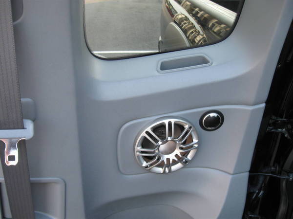

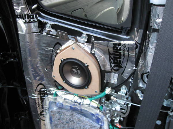

    this is what i did for my 09
    jdg, Norton, Key-Rei and 2 others like this.

    Bass, what kind/size of speaker is that?

    Hey bass mechanic, read your complete write up before doing mine and was afraid to do something that complicated! It looks factory, whereas with the speaker grills showing, mine is obvious that it's not. Did you end up with a big gap between the speaker and the panel, or did you use a thicker mounting baffles?

    MB quart 6.5 inch

    yes i just made a spacer out of MDF, you can buy the taco tunes ones but a peice of MDF and a jigsaw takes only about 5 minutes to make and less than .50 in material to get the job done.
    being that i have installed for some time i absolutly did not want the look you ended up with, i went for more of a factory look.
    these are simple to make as you can see, you need a heat gun to soften and form the plastic and some grille cloth. i used GM style trim push pins found at lowes home improvement center.

    Hey bass mechanic, when you did your grills for your rear doors, how did you form the curve for the door profile and what thickness of material did you use? I have some 1/8" ABS and have tried a first attempt at doing it by free hand. I was quite happy with how it went but being a finicky one, not quite happy enough that I would use it. Did you just do it free hand or was there some other way to do it. I even tried to make on more bend in it to extend back further than you did with yours but because of the other curve it jus would not quite work. I am wondering if there is some way to protect the door panel from the heat of the heat gun and just lay it there and heat it up till it forms itself?
    Any suggestions would be a great help as I think I am pretty much there with what I need to do.

    the material you have is fine to use, after you cut the shape out, use the head gun on a bench to heat the plastic untill its elastic, or floppy, or how do i describe, almost ridged?
    you only need to head the end thats going to be curved then with a towel press the peice onto the door panel, i would suggest not cutting the hole in the panel untill you have a grille made for this step.
    lay the plastic against the door panel and hold with a towel and press it there for about 2 minutes.
    the door panel being much cooler than the ABS will quickly cool the peice and at the same time retain the shape.
    if you want to extend the peice around the corner you certainly could do that however i think after its covered it will look tacky as it will only make it more obvious it doesnt belong there and it will require additional pins to secure it and prevent rattles.
    also when you put the grille cloth on notice that it likes to streatch in 1 direction more than the other. the key is to stretch it tight from top to bottom to it will lay against the curve and also wont bend your plastic like it will if you pull it tight from front to back of the grille. you should use little if any tention front to back so it will lay flat.
    do not spray adhesive on the front of the ABS, only the back and only the areas of the grille cloth that will be sticking to the back. if you get it on the front it will stick and show imperfections. you want the cloth loose on the front so it will float and not bind on the front. it will also hide the hole in the grille a lot better if its not stuck to the front.
    you do realize that you have to drille your holes for the puch pins first and install the pins in the grille before you cover it as the heads of the pins are behind the grille cloth and in front of the grille. i picked the black GM style ones from lowes because they are very thin.
    you need to also drill the holes in the panel using the grille as a guide to make sure they line up.
    the very last thing you should be doing is covering the grille with cloth and then once set, install the grille by pressing the exposed pins on the back of your grille through the holes in the door panel. you want to try to install the pins in their holes at the same time or it will be difficult to get the other pins to line up.
