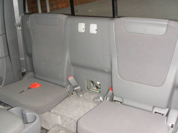

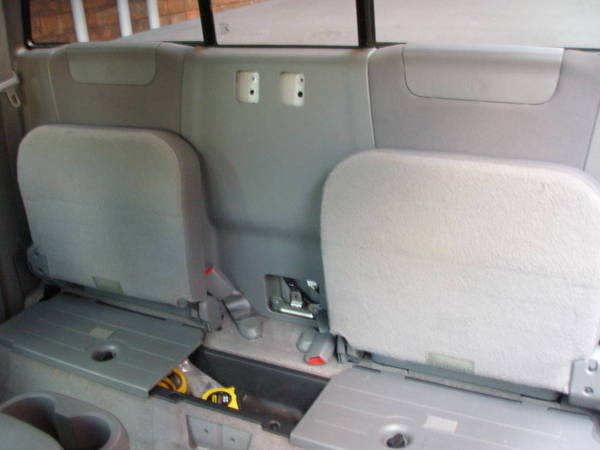

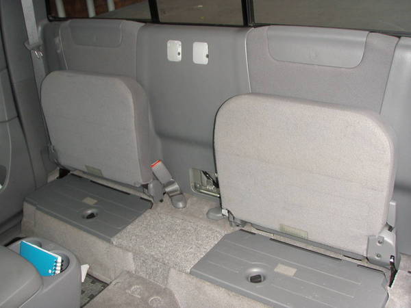

    Here was the problems:
    1- Rear headrests blow.
    2- Stock sub is too big.
    3- Rear centre console is retarded.
    Therefore I did this: (With help from this thread: http://www.tacomaworld.com/forum/2nd-gen-tacomas/55771-09-rear-headrest-removal.html)
    Now I had some new problems:
    1- No cover for storage
    2- Lots of holes
    3- No sub-woofer
    4- No seat belt keepers
    For problem 1 I decided to build a cover;
    For problems 2-4 I'm still undecided.
    Any thoughts or suggestions would be greatly appreciated.

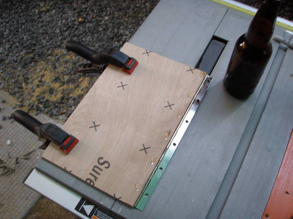

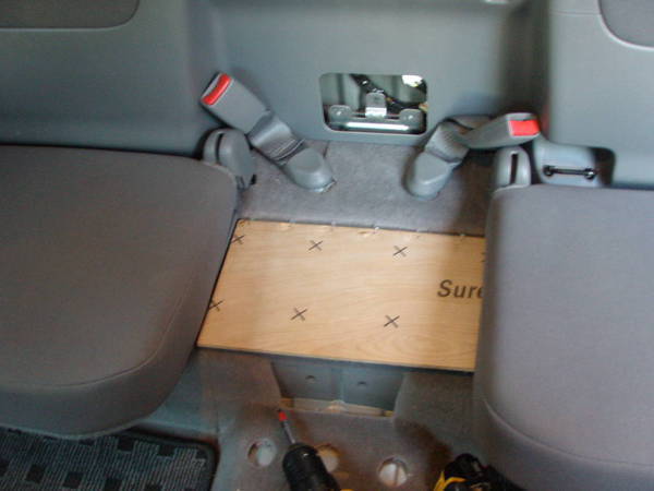

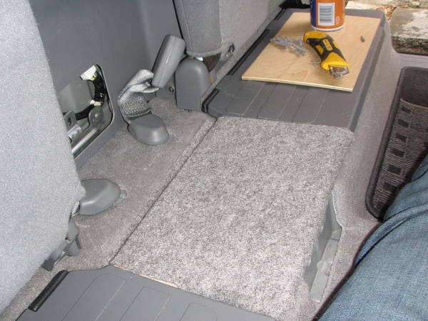

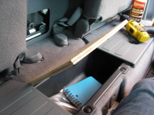

    As I mentioned I decided to build a storage cover. The project is only halfway, however has reached a "functional" stage.
    To start with I need the following tools:
    -Cordless drill/driver
    -Table saw
    -Grinder
    -Hacksaw
    -BEER!
    And used the following materials:
    - 11 7/8" by 7" of 1/4" Plywood
    - 11 7/8" of piano hinge
    - 7 woodscrews
    - 7 self-tapping metal screws

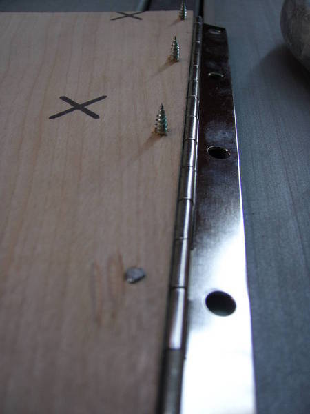

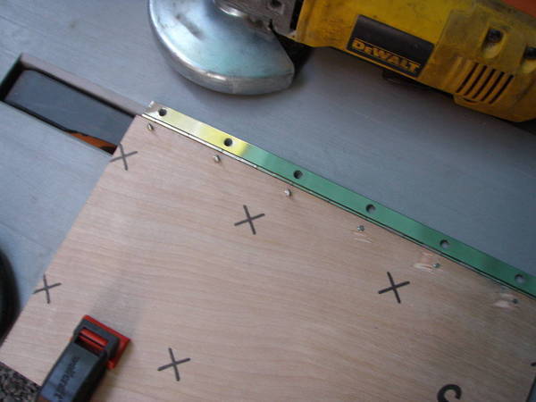

    Phase 1: Cut the plywood and hinge to size, screwed them together
    Phase 2: grind down the screws
    I'm aware I chewed up the wood a little, but that will be covered once I upholster it

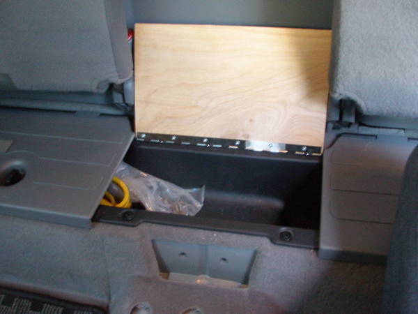

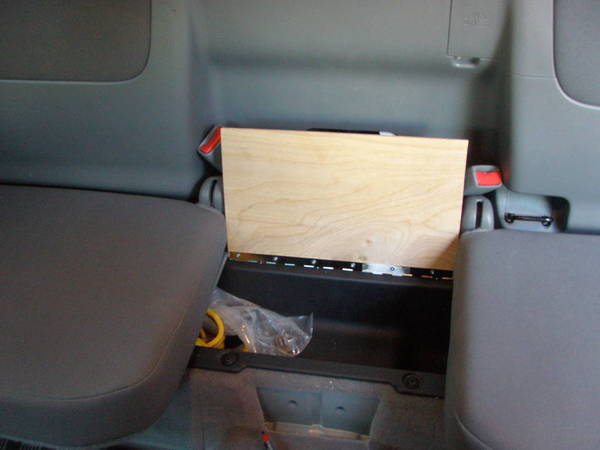

    Phase 3: file down the nibbley bits to make them smooth
    Phase 4: Self-tapping screws into the truck
    From here I need to find some upholstery to match the interior, then I will cover the hatch, latch, and the holes from the console. (I'll post picks once completed)
    Gratuitous Action Shots!!!

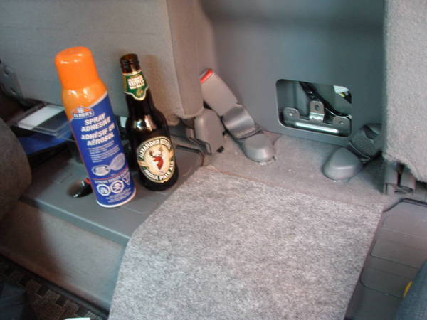

    Alright, first of all, finding this stuff was a massive pain, but I ended up finding it in Ottawa at a place called "Rockland Textiles" if any of you plan to do something similar I recommend you check out your own local textile places.
    New tools needed:
    Scissors
    Knife
    Carpenter's glue
    Spray Adhesive
    New Consumables:
    Another 10 5/8" by 7" 1/4" plywood sheet (Everyone else just buy 1/2")
    Fabric
    To start I added another 1/4" of thickness to make my new lid level with the stock ones in there I just used wood glue and screws:
    Next I cut the fabric a little wider than the lid and started to glue:
    Once that was done I left enough lip to wrap along the sides, glued them in place and trimmed the rest (the bottom is not covered) Giving me this finished product:

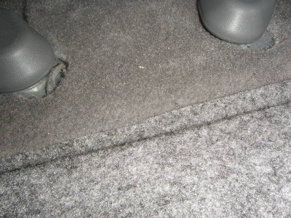

    You may note the left side has the fabric trimmed back a little more, this was due to some binding issues with the stock lid.
    This shows the slight discoloration between the new fabric and the stock, but it was the best I could find in local stock:

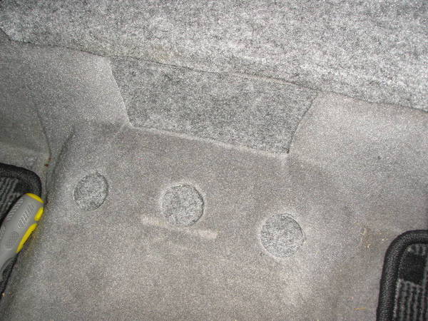

    Once I was done I decided to slip some pieces of the fabric behind the holes, figuring it would look better than an off colour patch:
    And some finished product action shots:
    Next weekend I'll figure out what I'm going to do about the holes in the plastic, and some sort of seat-belt manager (suggestions welcome)
