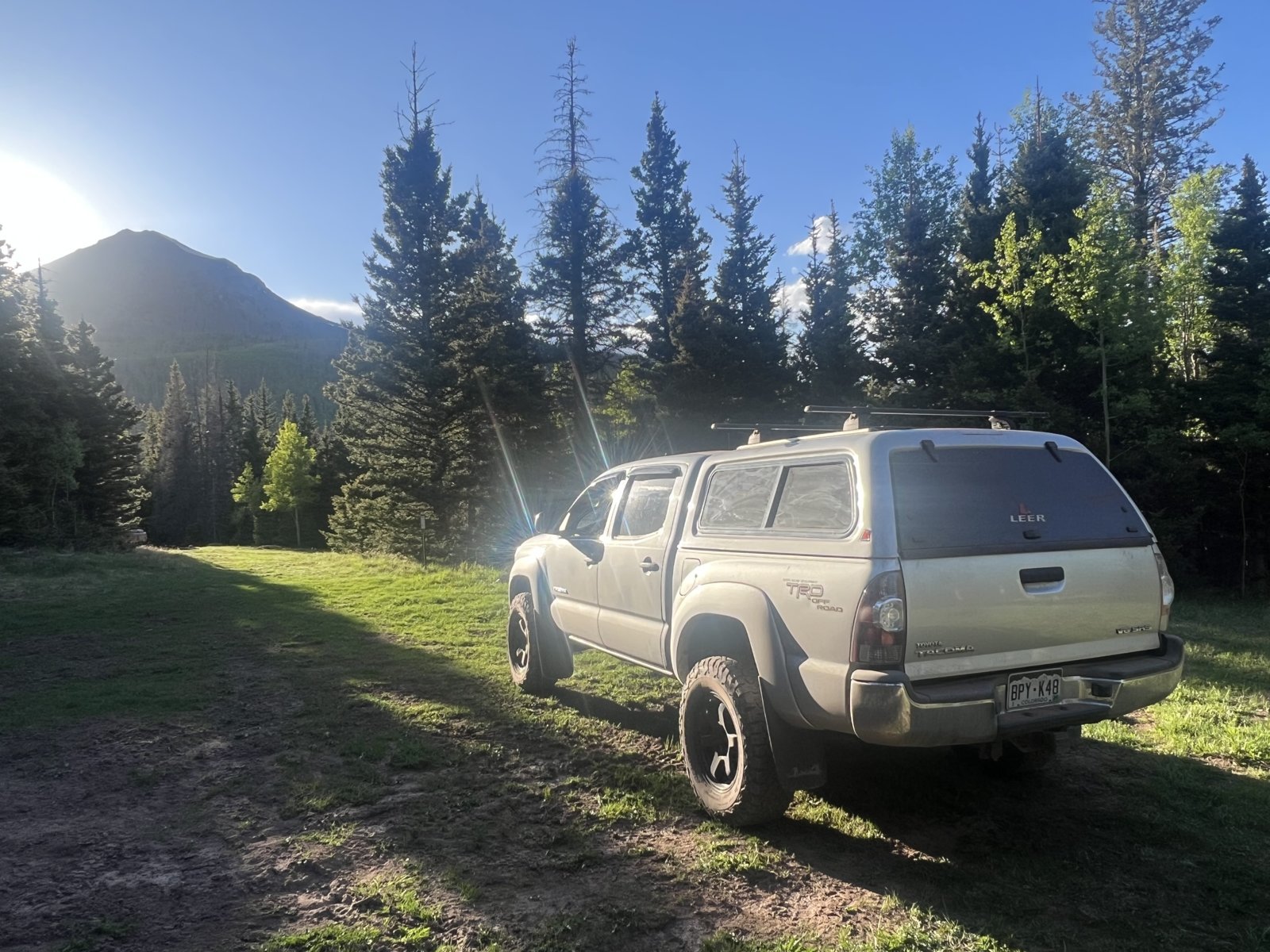

    Hey there,
    I just rolled over 200k (!), and I was wondering what maintenance I should do to my Tacoma for up-keep. I live in colorado and drive on quite a bit of washboard and rocky roads.
    I get an oil change every 3k and recently did my power steering and front dif fluids.
    I just want to make sure I’m doing as much preventative care so I can get another 200k out of it!
    thank you

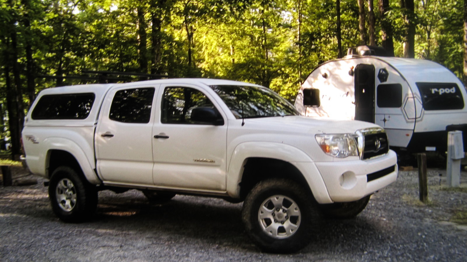

    Nothing special. Just keep doing what you've been doing.
    I do like how you have your truck set up, yours and mine could be twins. Mine is an 07 with 247,000 miles.
