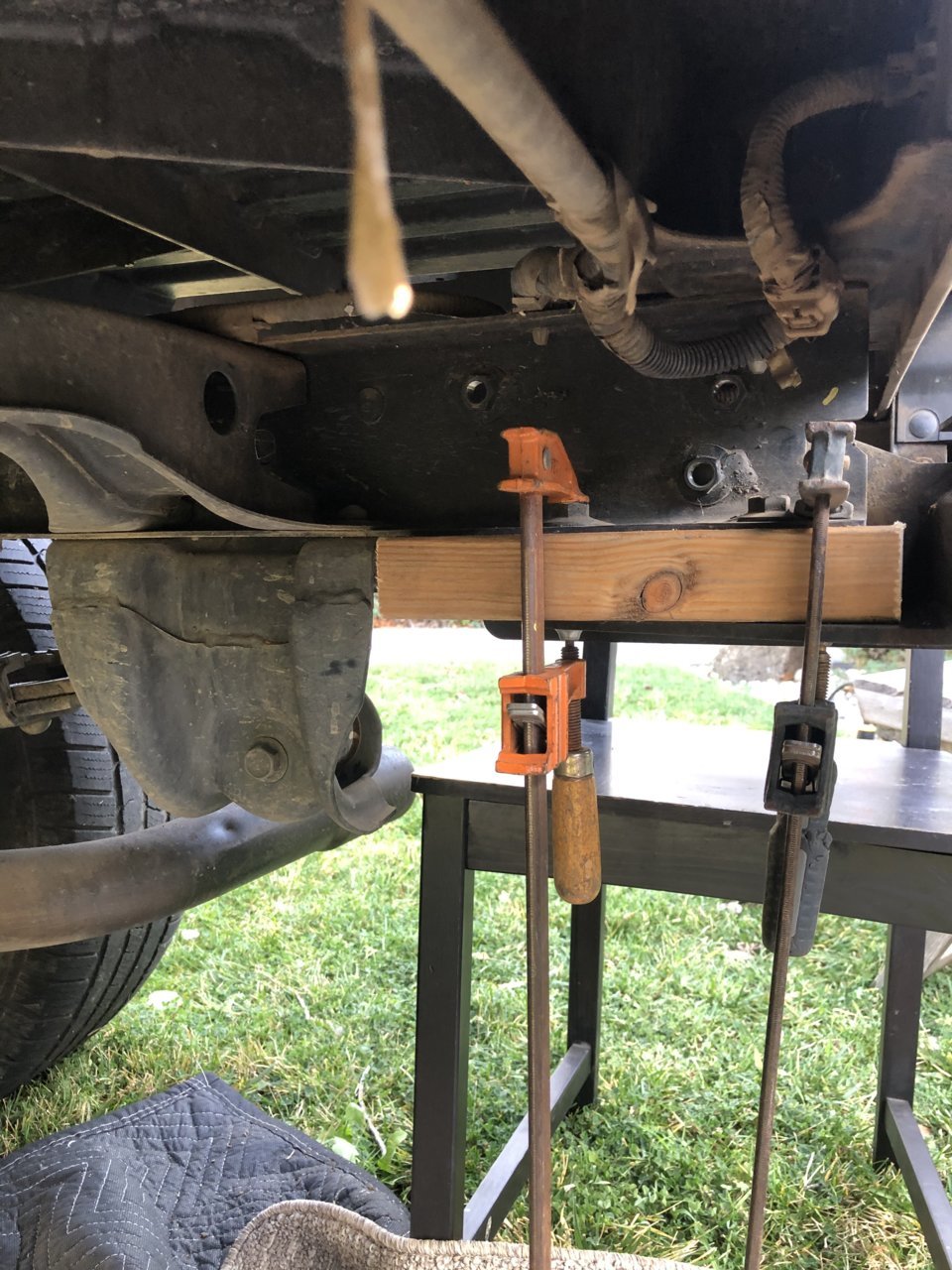

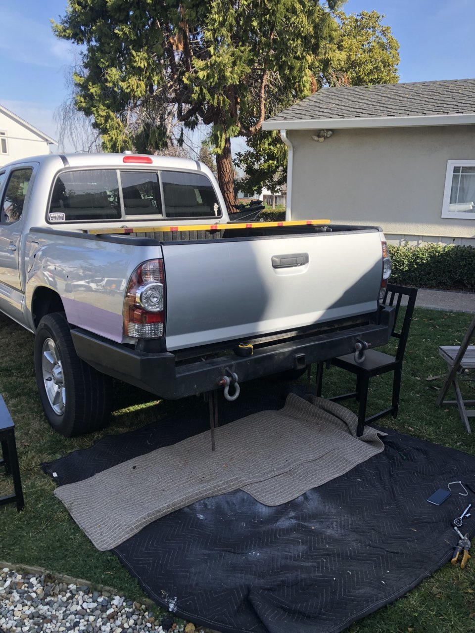

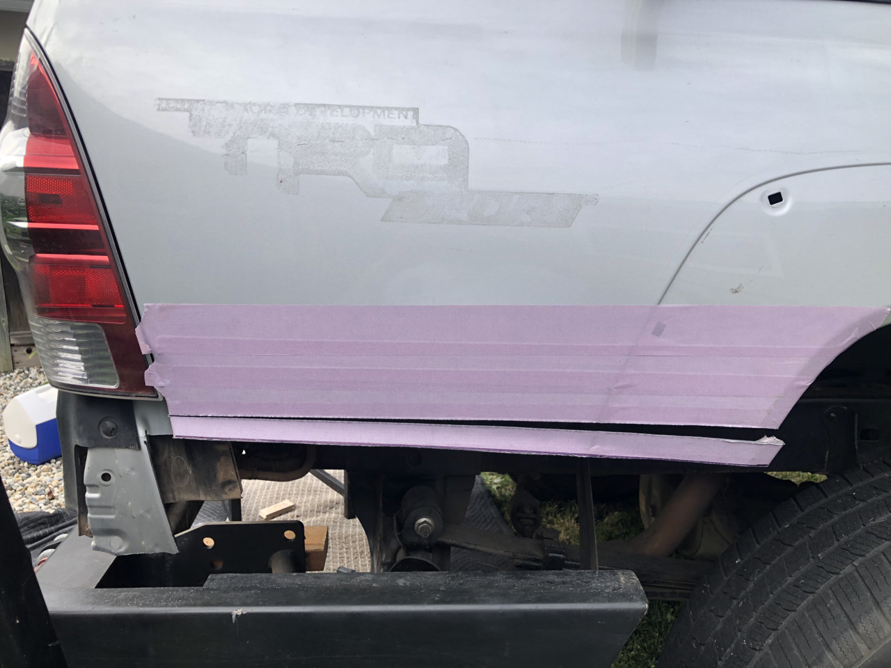

    Solo rear bumper installation. Rough cut at 18.5” from top of bedsides then spaced off mounting points on frame by 1.5”. Clamped in place measure 1.75” for a consistent .25”margin.

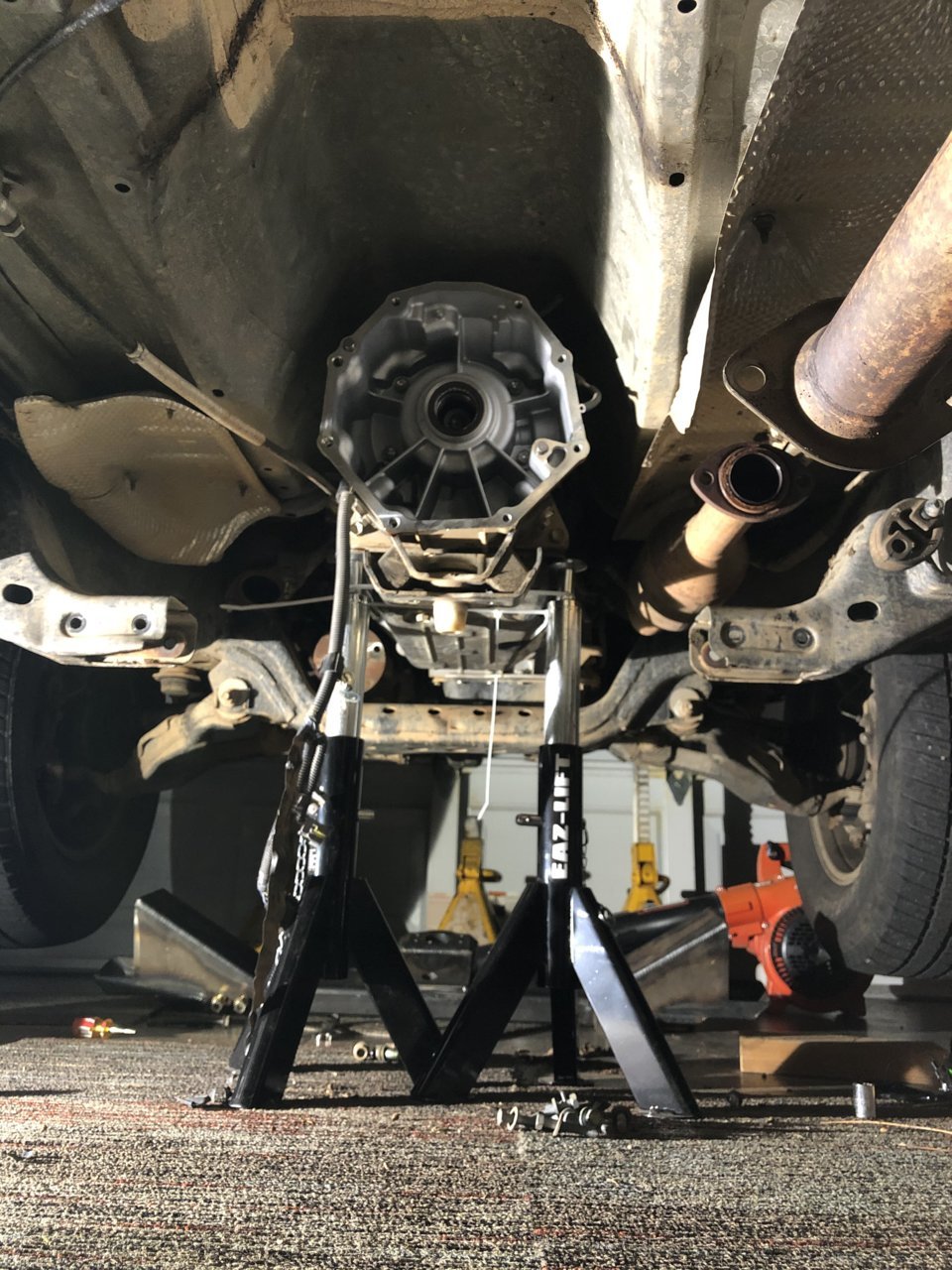

    Decided to tackle the dual cases and new crossmember. Pulled the tcase out and surrounding crap. Getting ready to cut off stock crossmember and prep for the new one.

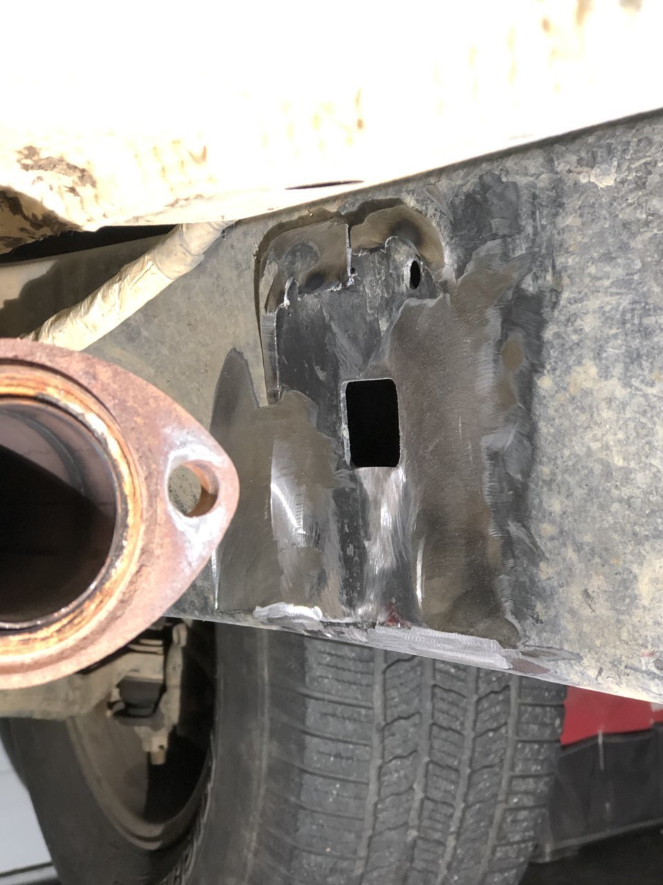

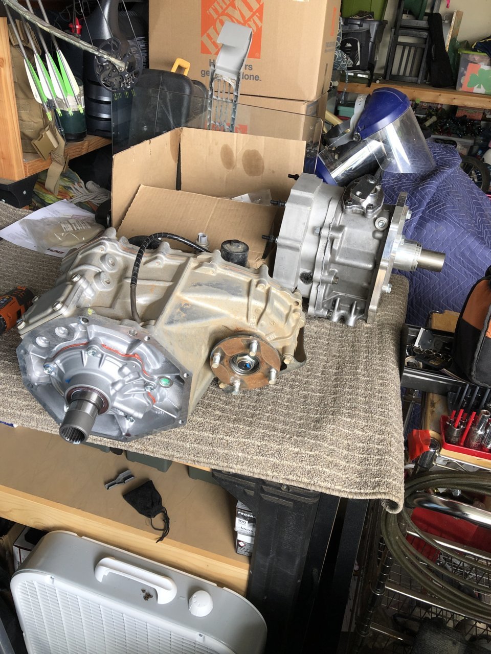

    I have the passenger side 80% cleaned down to the frame. The top portion takes a while to grind down. The cases are ready minus removing the coupler off the stock one and bolting the two together.

    2007 Tacoma TRD Sport
    Is that the TG trail creeper?

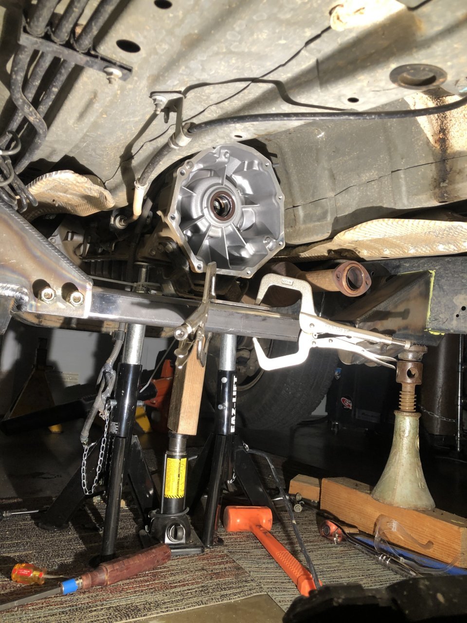

    I have the new crossmember temped in there. It will have to be lowered a bit to clear the extra length. I will deal with the center section later to adjust the height difference.

    Nice cross member with link bracket. Built it yourself?

    I got it from Califabrication. It’s really beefy. I have to modify the center section cause I’m going dual cases though. Also I’m not sure how the front driveshaft is going to interface with the center section adding 8.5” of length.

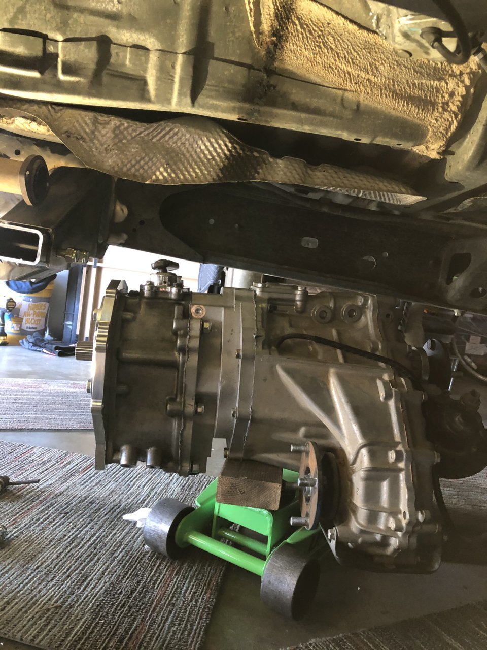

    I got the dual cases in. It went pretty smooth. I am going to have to rethink the center crossmember section down the road for the swap but I’ll just use this one modified for now. I need to order a new rear one piece driveshaft

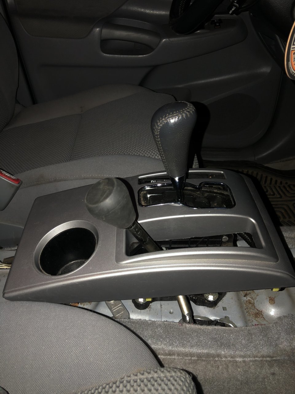

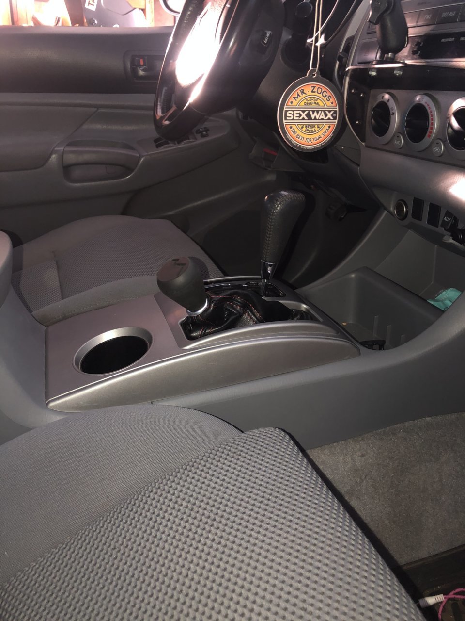

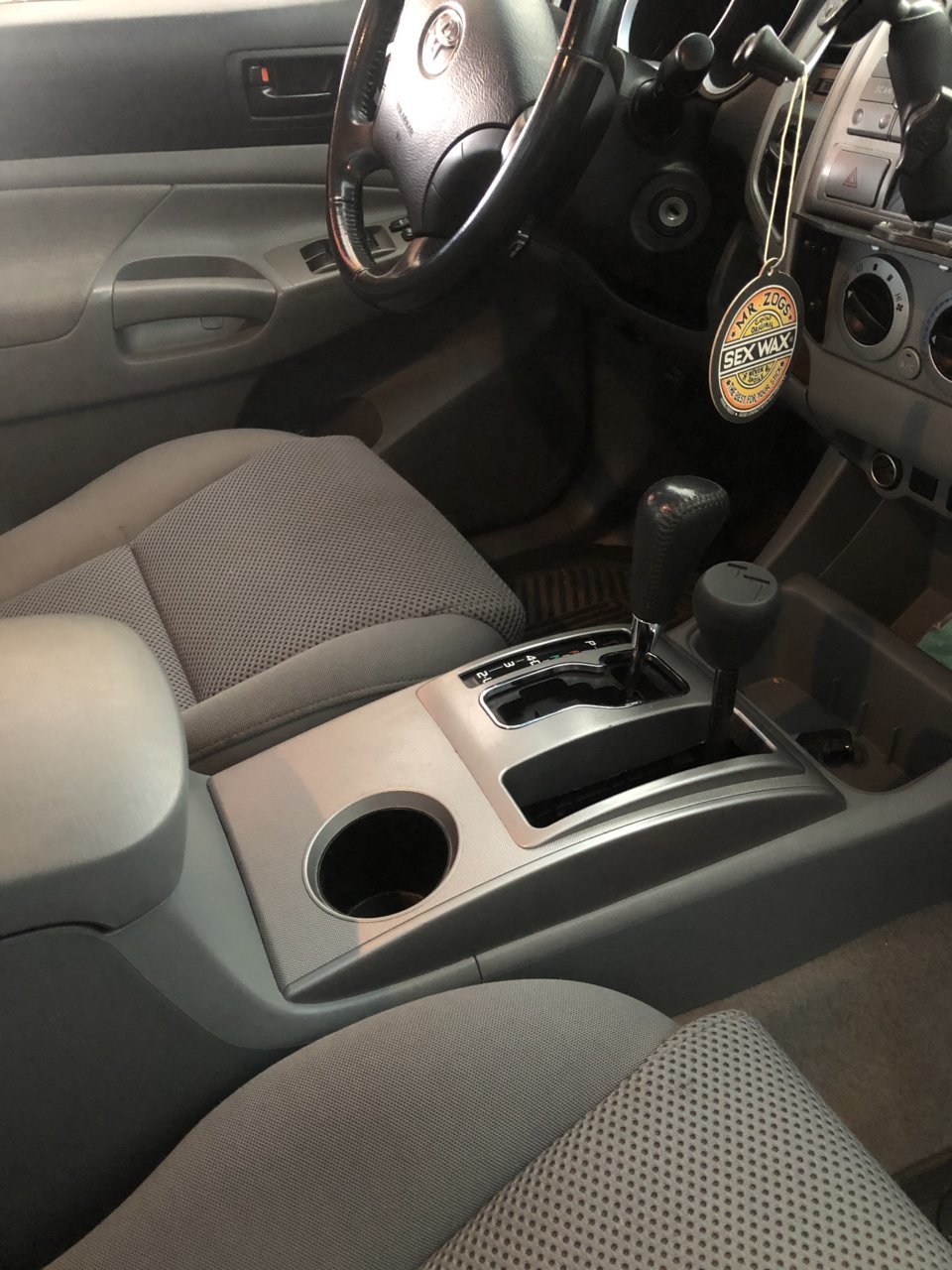

    I modified the shifter to fit properly through the pencil holder without hacking it wider. Trail gear instructions tell you to cut wider than the pencil holder but that would look terrible. E73AAE54-AD1B-4798-9D51-8E02FCF00C79.jpg

  17. Feb 22, 2021 at 8:17 PM
    #17
    bhigbee
    bhigbee Well-Known Member
    Jan 20, 2020
    #316760
    573
    Barney
    Hayden Id
    Wrecked 07 DCSB
    35s, flatbed, rhino liner paint, SOS front bumper, JD Fab lca pivot, JD Fab inner fenders and some other stuff.
    Looks great, how it should have come from the factory.

    Looks great. I ordered a shift boot which should come tomorrow
