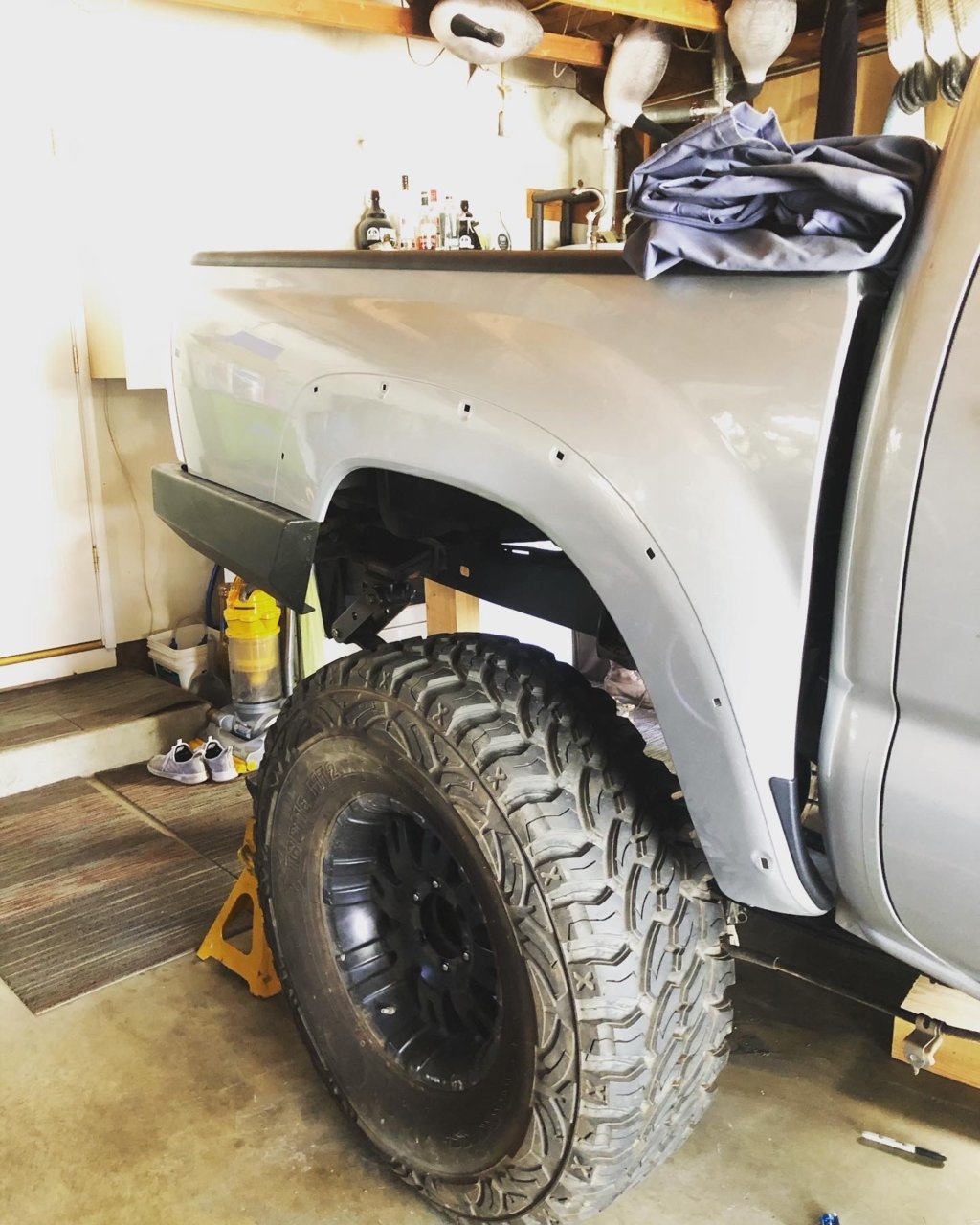

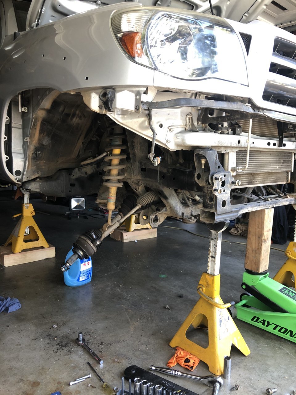

    Finished the Chevy swap. I put my wheels on and now I’ll move to the front and start cutting it apart. 6893B69F-F736-436E-958D-3BF015AD0C3D.jpg

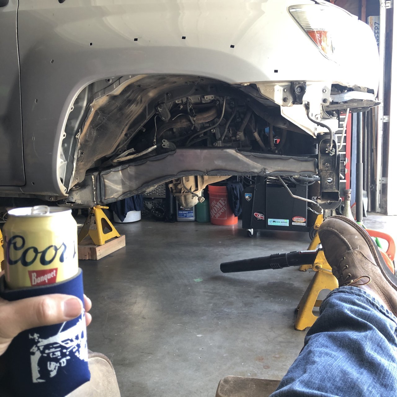

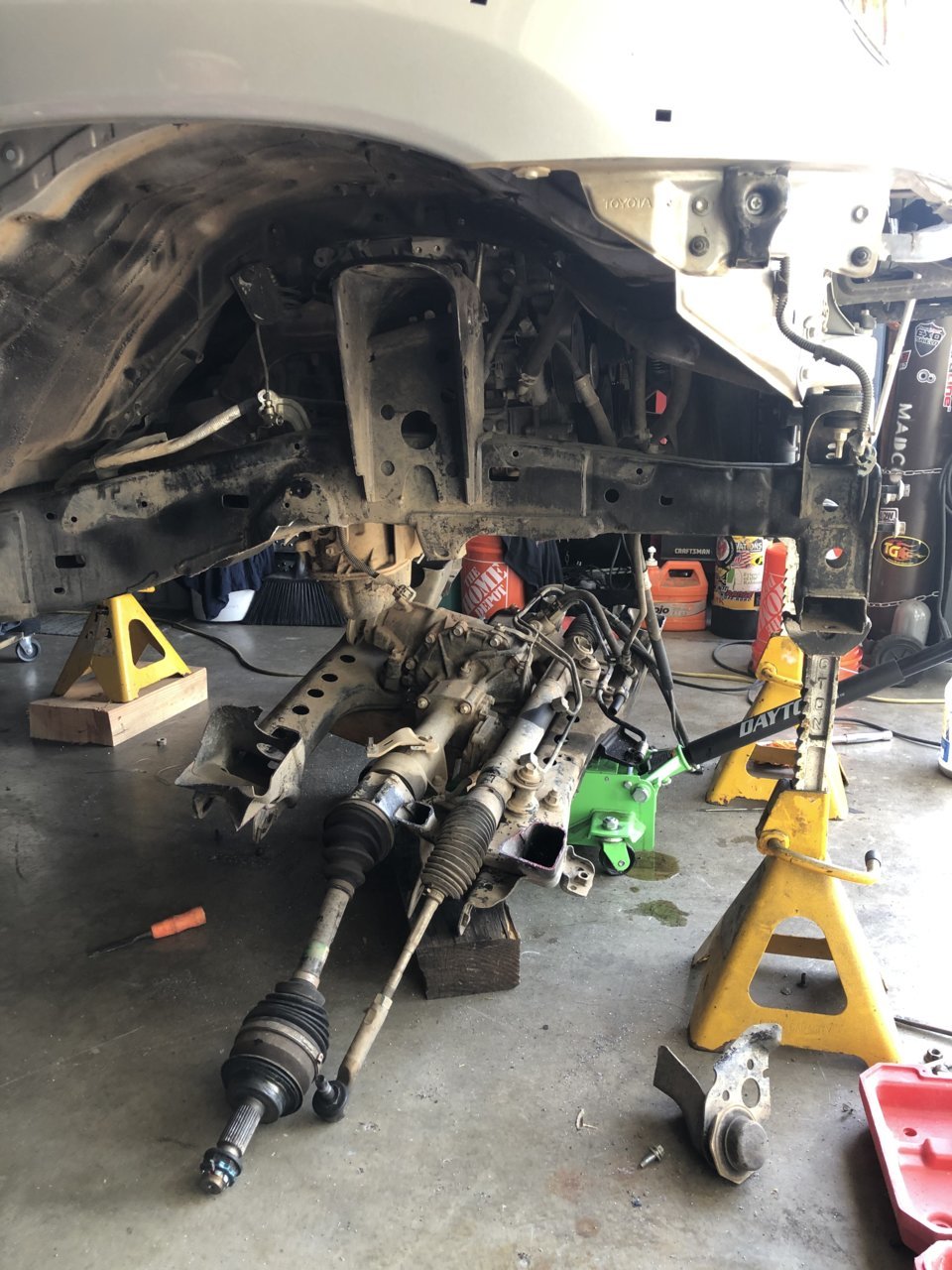

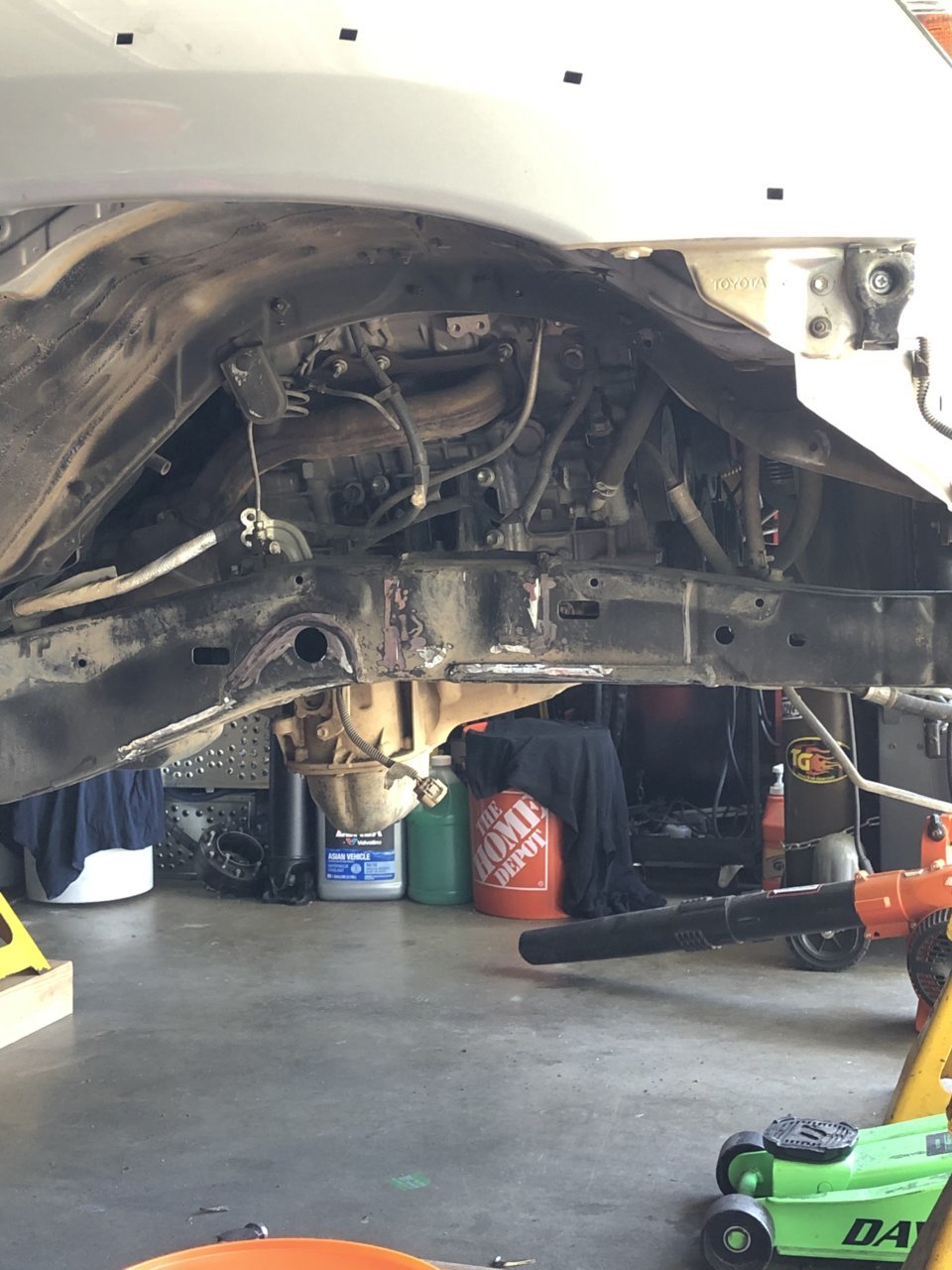

    6F0CE562-FA37-4FEB-B030-8885F90ED75C.jpg I started breaking down the front end.

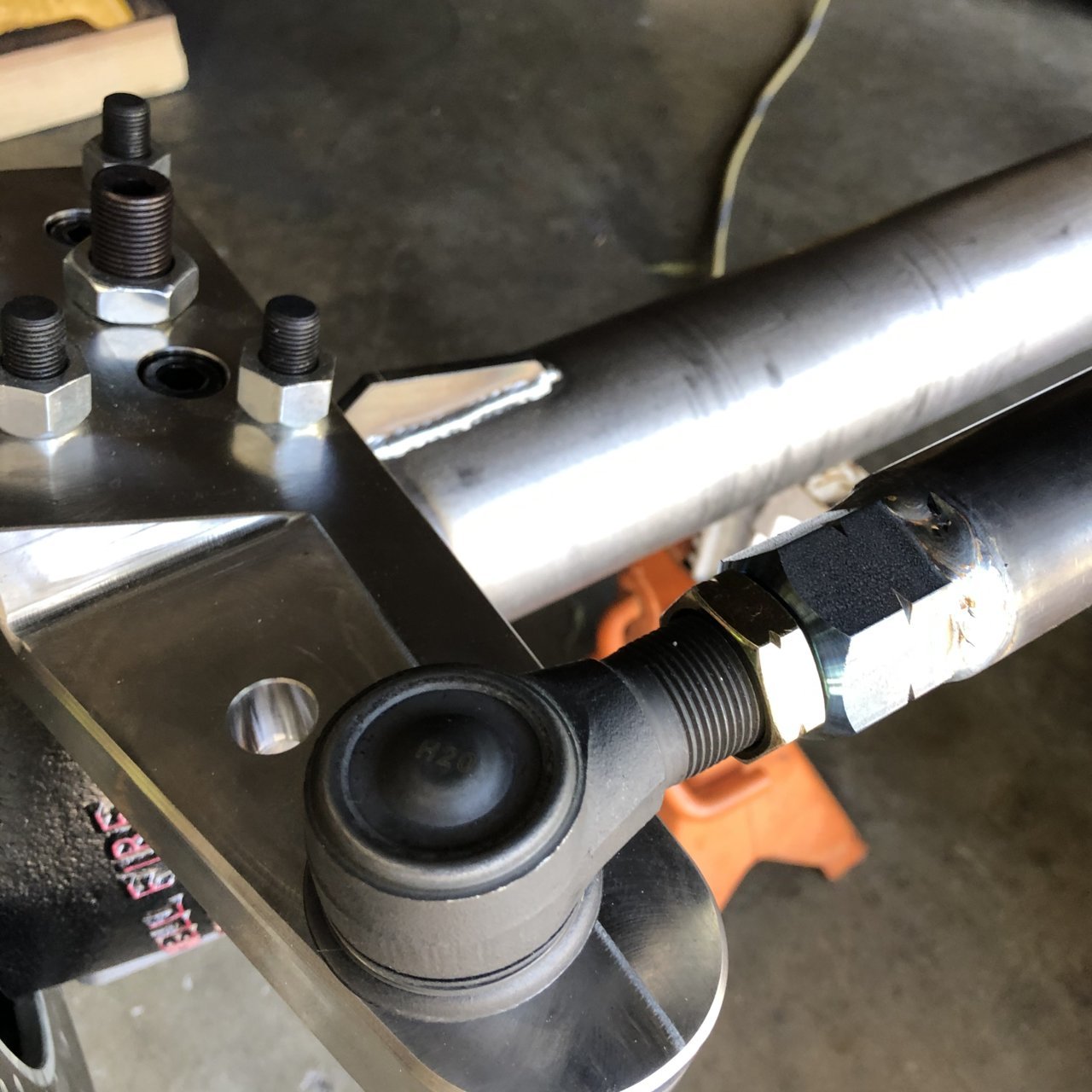

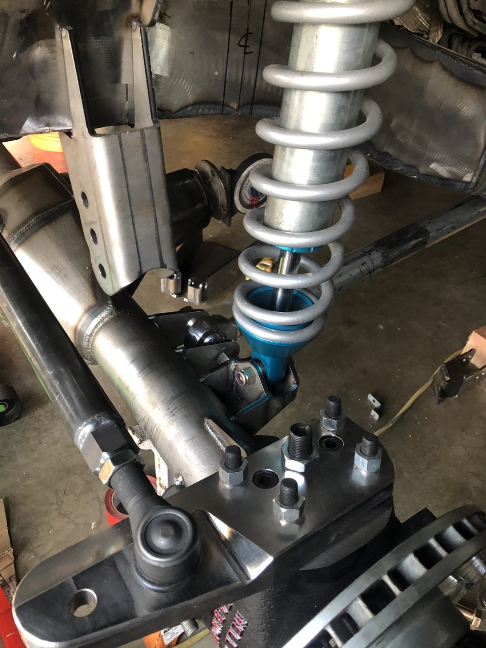

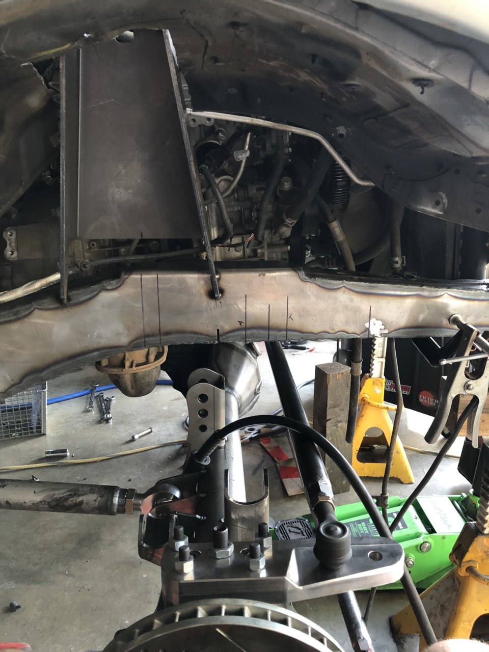

    I got the tie rod on and the axle under the truck
    10F7F1E5-6646-43F7-8512-87A908621457.jpg 011286EF-12B9-4F01-8F20-392A78EDBEDE.jpg

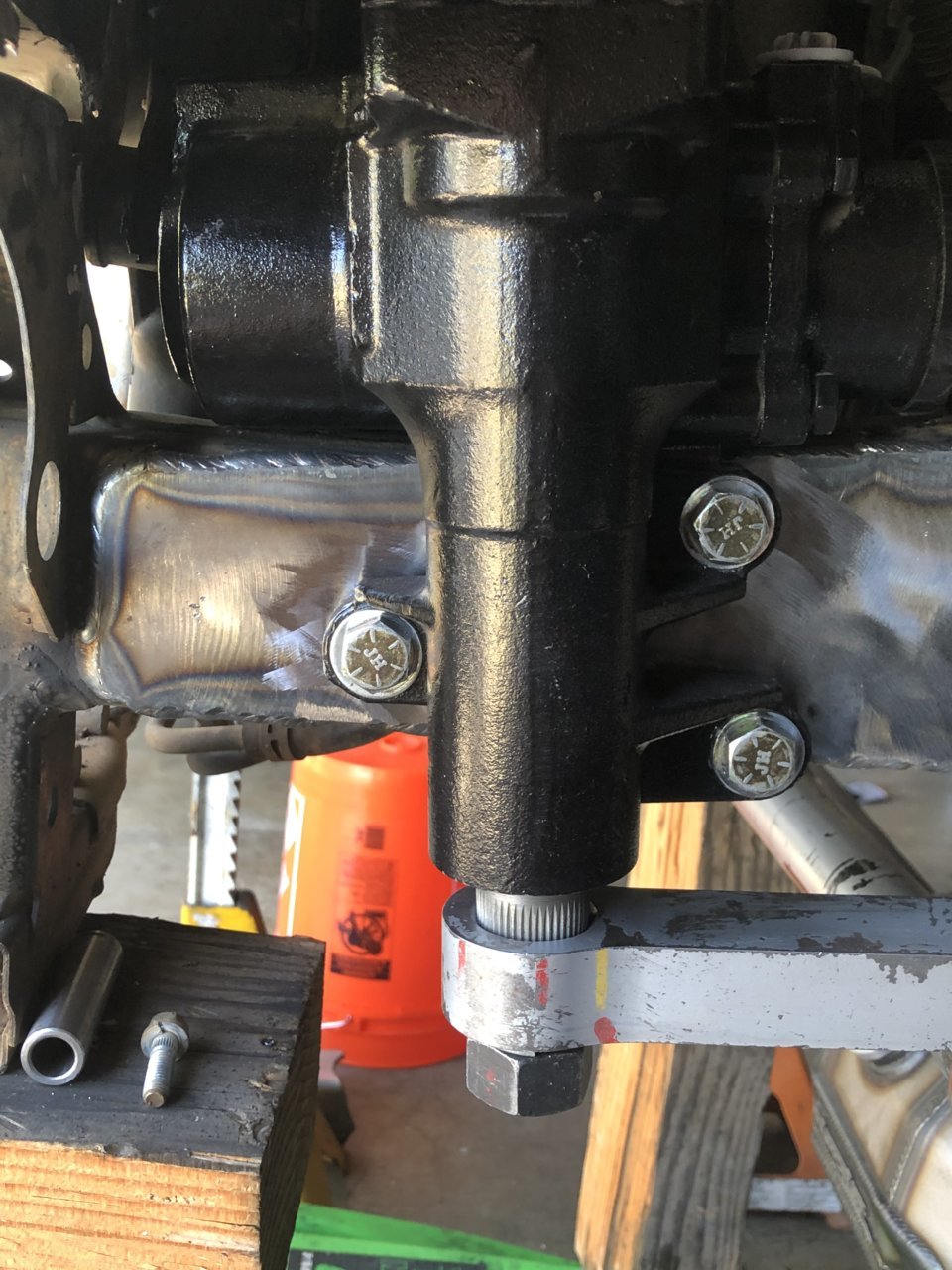

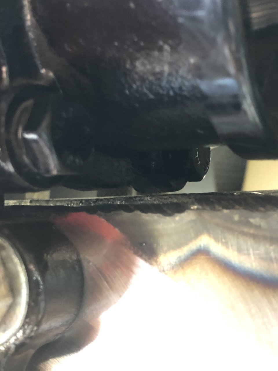

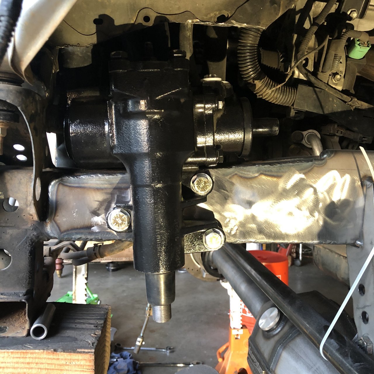

    I mounted the steering box today. It’s sleeved and welded on both sides. 6FE3A895-3201-4903-AFFE-C735356E5AF2.jpg 324000D3-F41C-4FFE-95C7-BE6AADE31906.jpg

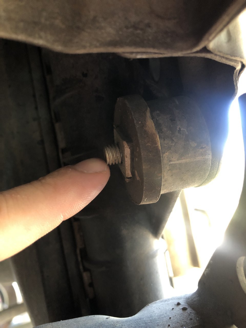

    did you use the WFO Concept frame plates? if so, did you use their bolt holes for the steering box?

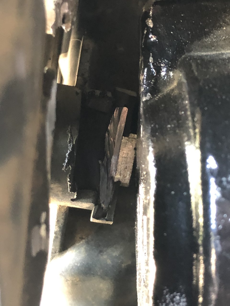

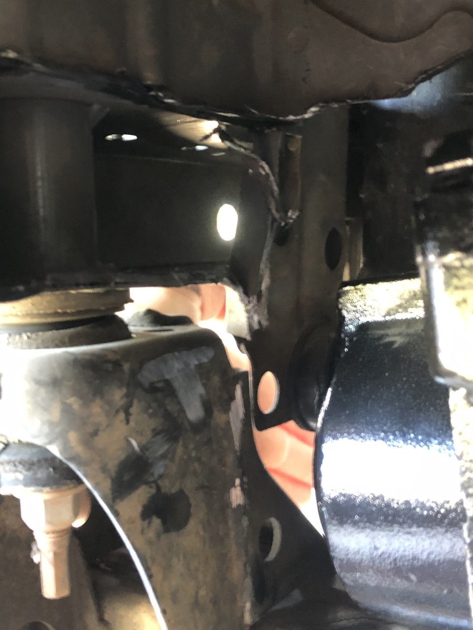

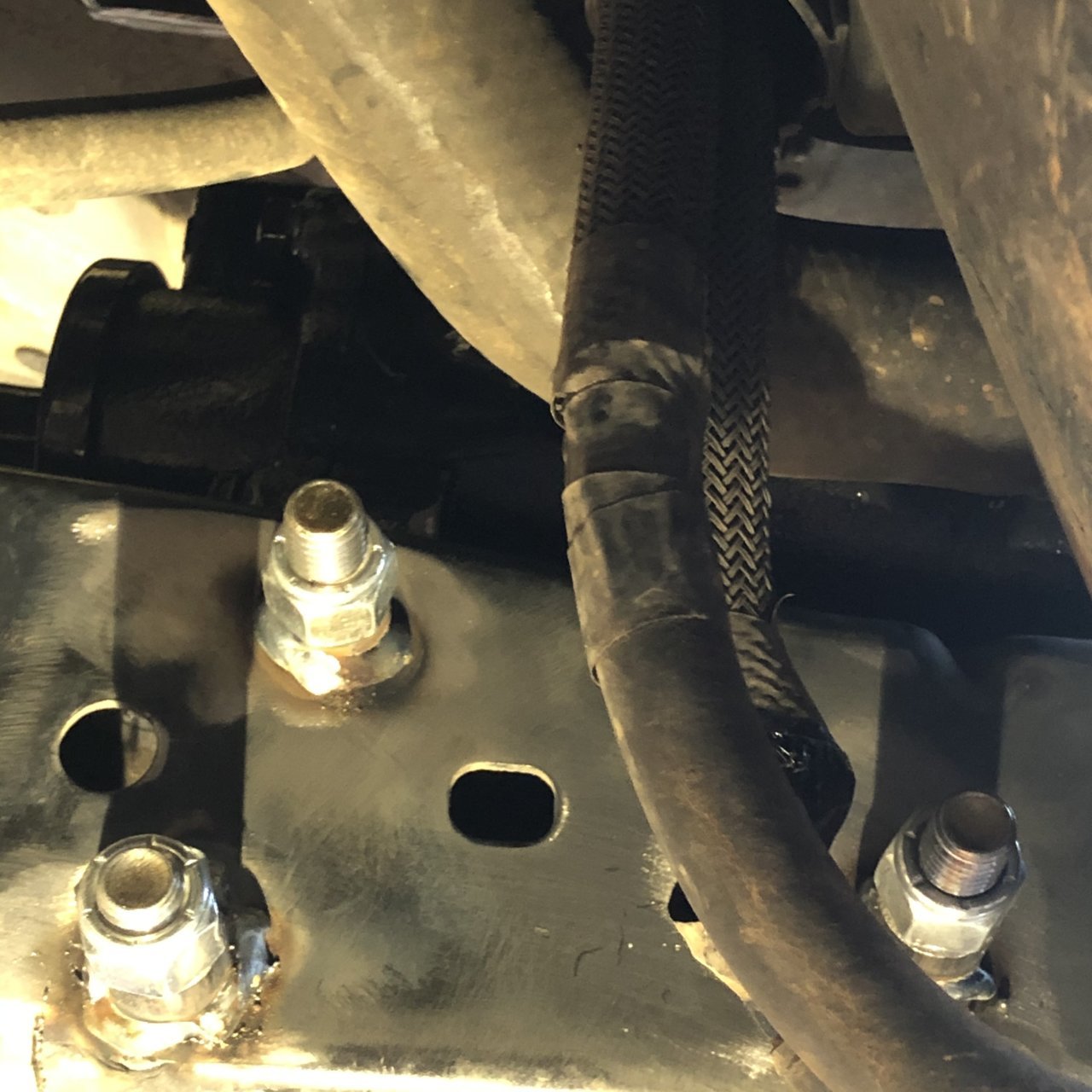

    Yes I did use their frame plates and I did use their predrilled holes with the plates pretty much maxed forward. Make sure that you set the frame plate high enough to mount the steering box obstruction free and clear the frame. It’s very tight. It’s a real fun time drilling trough the frame keeping the holes square and sleeving the holes with 3/4” o.d. I had to also slightly clearance the radiator bracket and bushing. I’ll take pics later.

    At the very minimum cut the excess threads off of the radiator mount to get that box pushed as forward as possible.

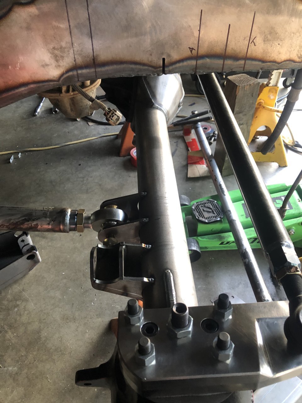

    I’m currently spotting all my housing brackets and the. Going to cycle everything.
    89AB4D45-79D3-4373-AE77-72FD9C1ED6F9.jpg 5AE8D7F2-B2FE-4007-BF48-1869B8DA4673.jpg
