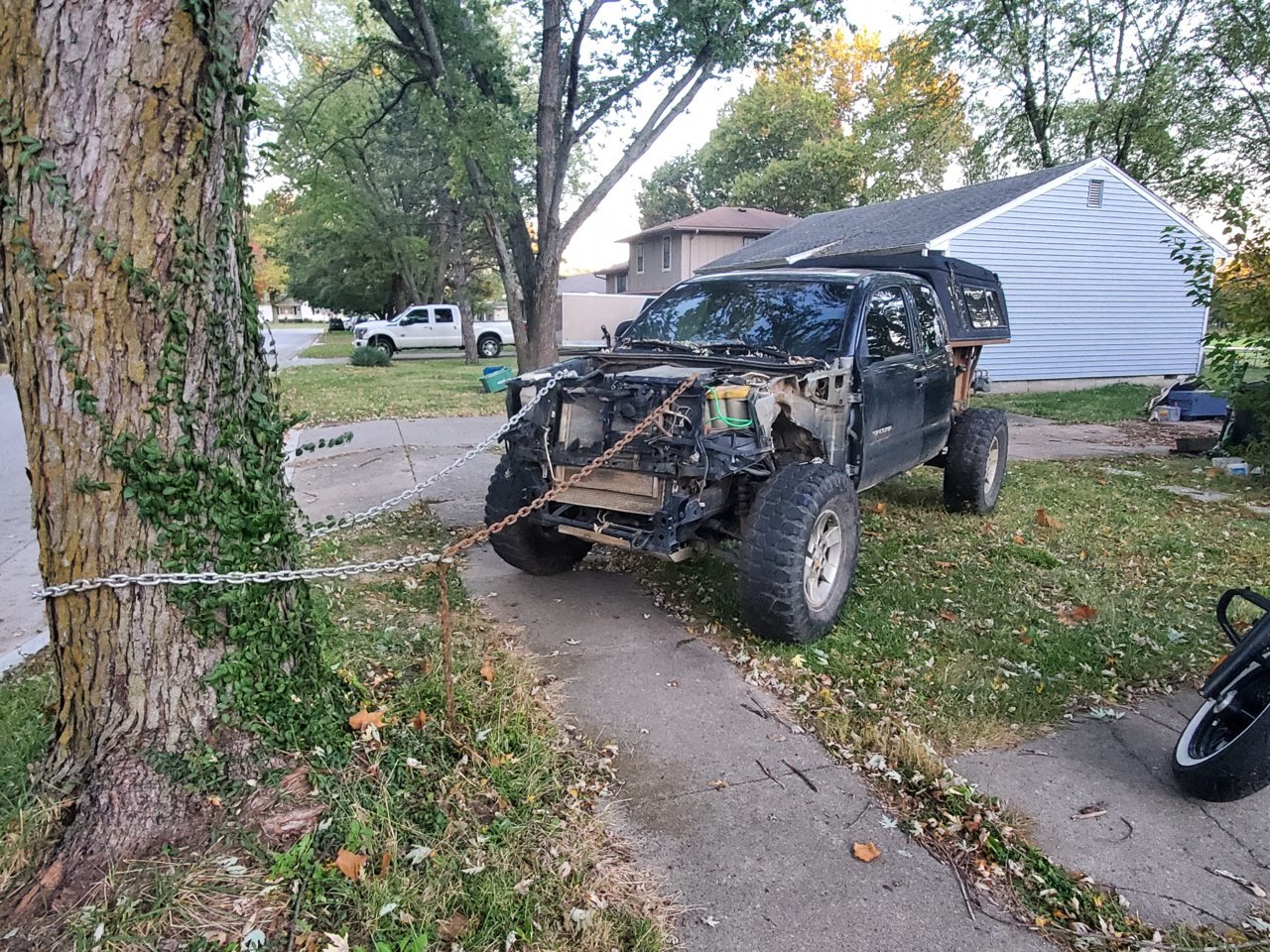

    Thanks. Im actually using an fzj80 elocker front end and keeping the radius arms for now. All of my mounts are arriving now so its getting real and fingers crossed I actually get to drive it out of the shop at the end of 9 days ha. Going to do myself a favor and relocate the radiator and condenser to the bed to allow for the axle to be moved as far forward as possible.
    Truck got cut off and fubar'd but i bought it back from insurance. Gonny be my buggy sooner than later now.

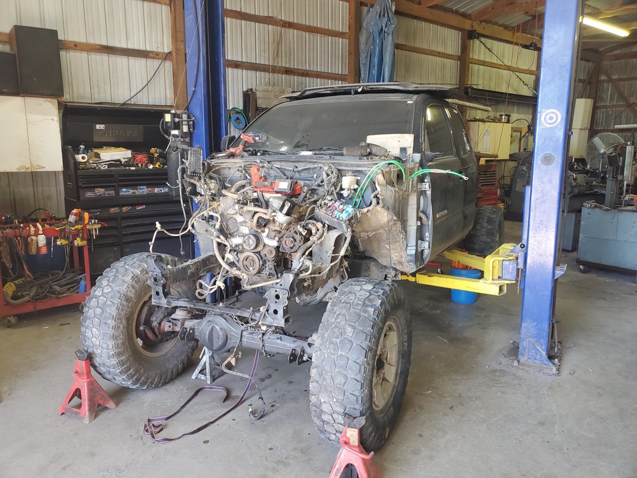

    Well no turning back now. Hoping to have the mounts and everything tacked in by tuesday so i can articulate it and see what binds

    I’ll get it in the morning. If I Moved my motor mounts higher to raise my engine up that would’ve given me more room so the panhard wouldn’t smack into the engine block. That would’ve been nice so I could’ve gotten a little more uptravel without increasing the front end ride height. I have 3 up 10 ish down. At full stuff it eats a little shaft so I left 1” shaft showing at a flat full bump. With 3” uptravel it is a little bumpy but I don’t give a shit. It’s a truck. It doesn’t have much body roll at all so it can corner well going fast.

    Thanks. 3” up. Moving the motor mounts upwards and raising the engine would give more uptravel. I didn’t want to fuck with all that crap. The issue is with the panhard bar and how close it is to the engine block. Hydro would be cool to get rid of the drag link and steering box, pitman arm space issues but I drive my truck on long distance trips so I went hydro assist.
