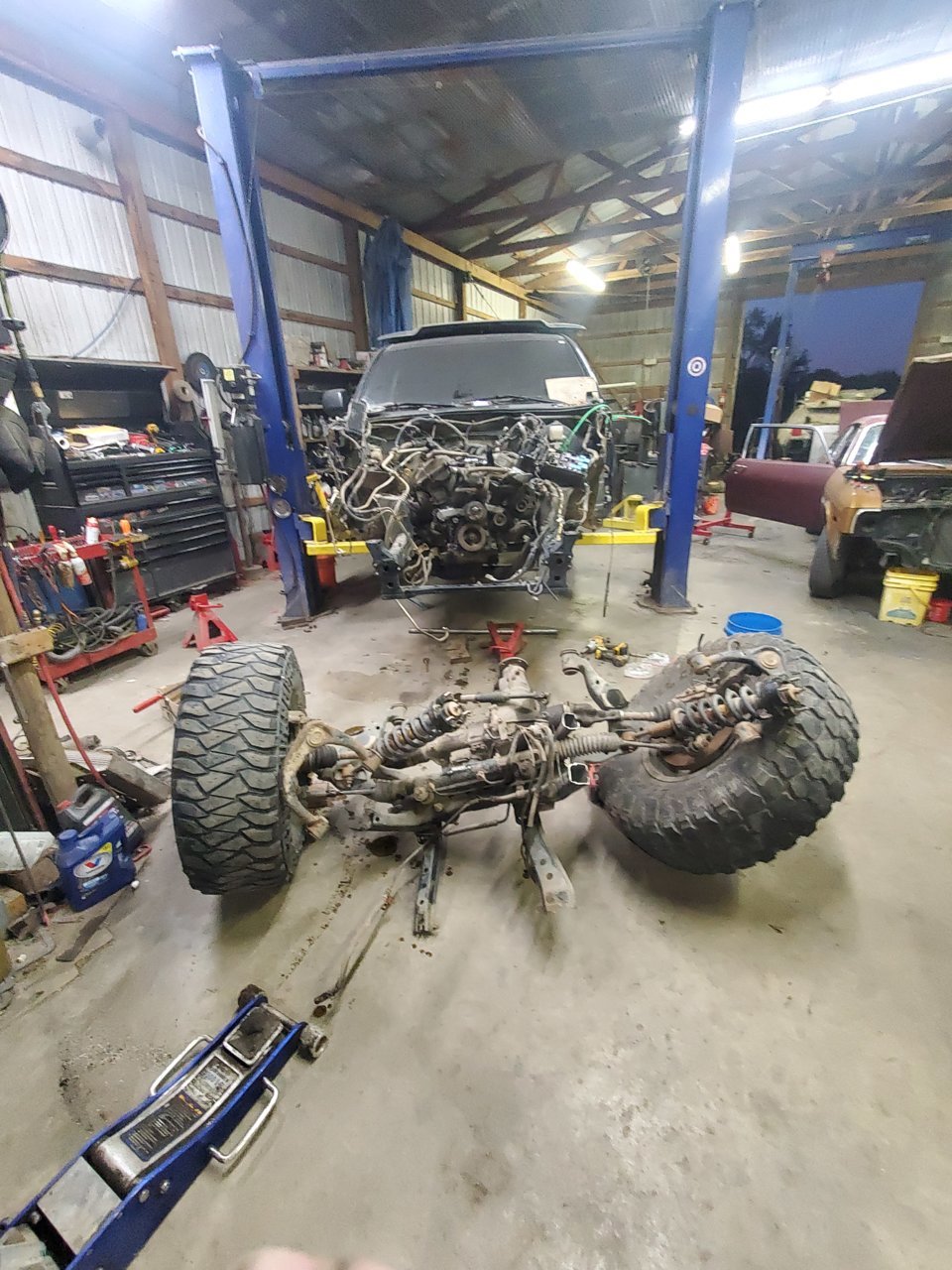

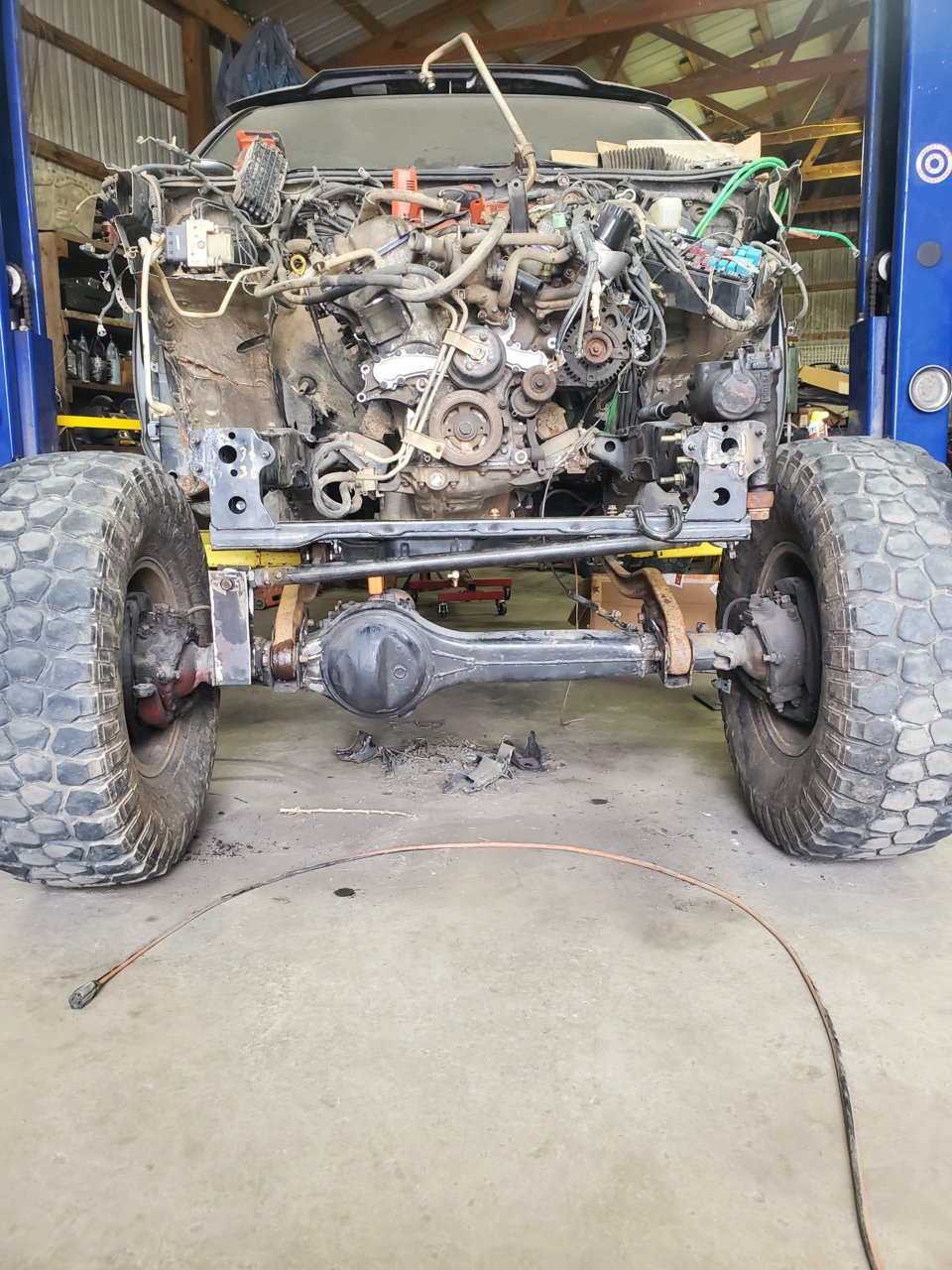

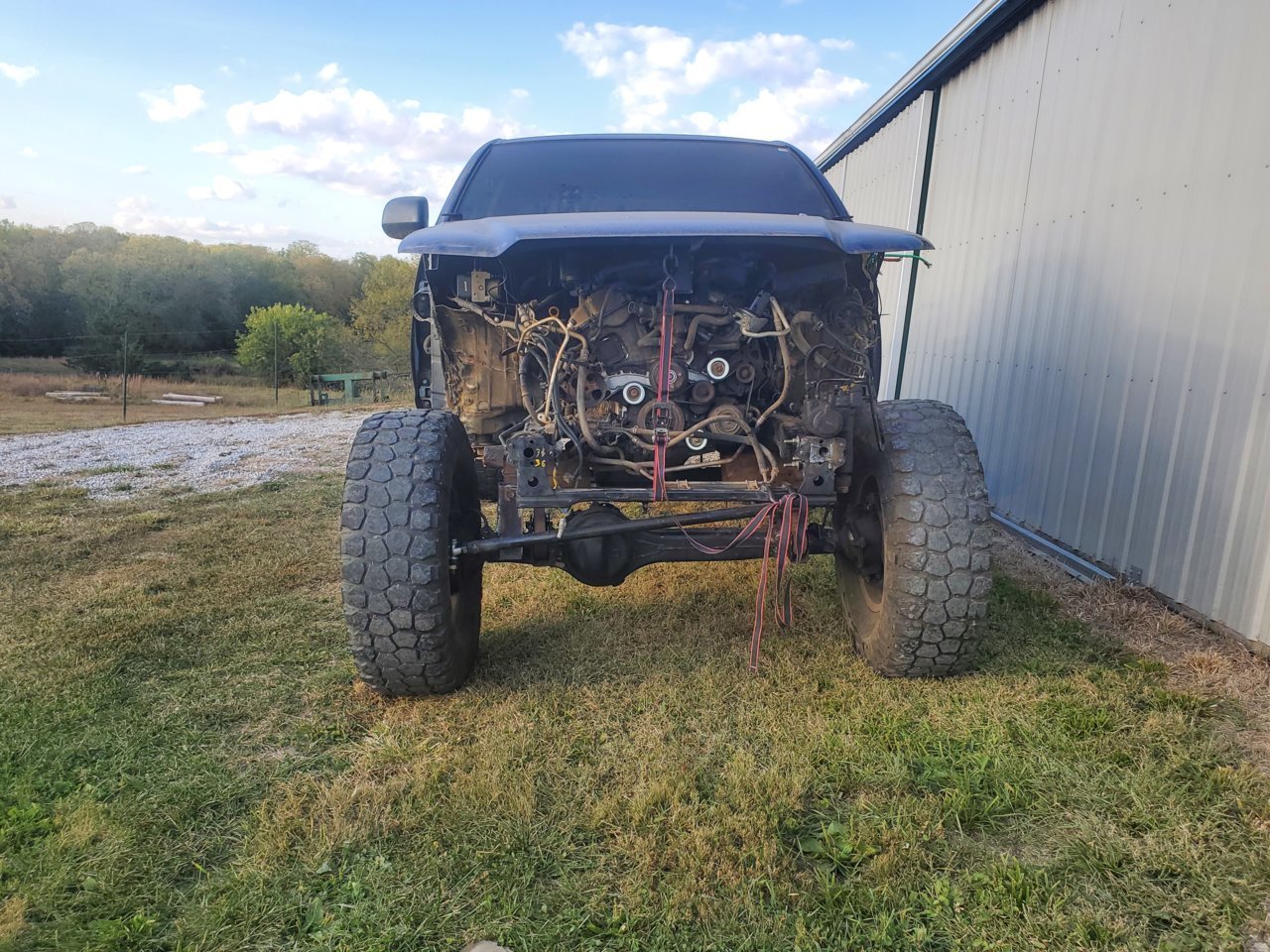

    Going good got everything tacked in just need to burn everything in now. Tuesday turned into Friday as i had to flip the radius arms which i was hoping to avoid, but the pinion angle would have been so much worse had i left it.
  8. Oct 9, 2022 at 4:38 PM
    #148
    T1TITAN
    T1TITAN Well-Known Member
    Jan 7, 2019
    #278498
    263
    Kansas City
    2008 ACLB aka Treehugger and 2005 ACLB Treehugger 2
    Treehugger- soon to have 80 series axles front and rear with dual rf1a tcases Treehugger 2- Bilstein 6112/5125 jba ST High Caster UCA OME Dakar Heavy leaf packs with Fireastone RideRite bags
    End of day 9 and it left the shop. May have 6x6 blocks for shocks but those will go when the coilovers get in next month. Not bad considering i didnt even have an engine installed when this started.

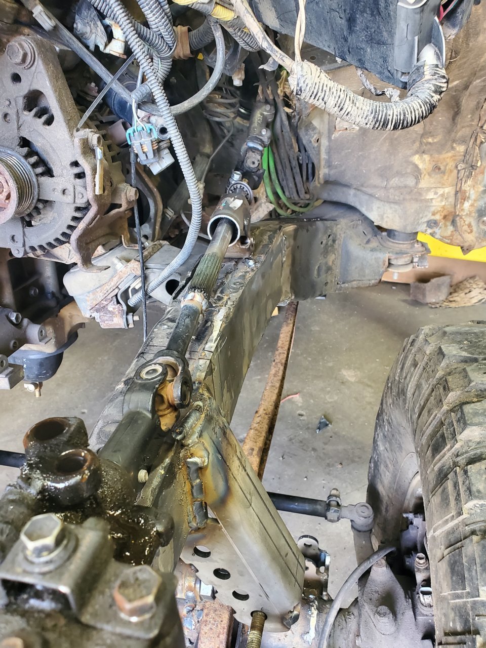

    Steering is not finalized just tacked in as i didn't have time to fab the mount for the bearing to mount to. Steering shaft is actually the original shaft and parts of a 2nd spare steering column.
    Still need to clearance the oil pan, install shocks and towers, do the tcase conversions, swap the rear axle and make driveshafts. Once all that and the radiator is mounted its going for a test drive at the local park. Then we'll start on the cage.
    Sorry for hijacking the post Pdugan6 yours and another thread were huge inspirations for me to do this. Take care all.

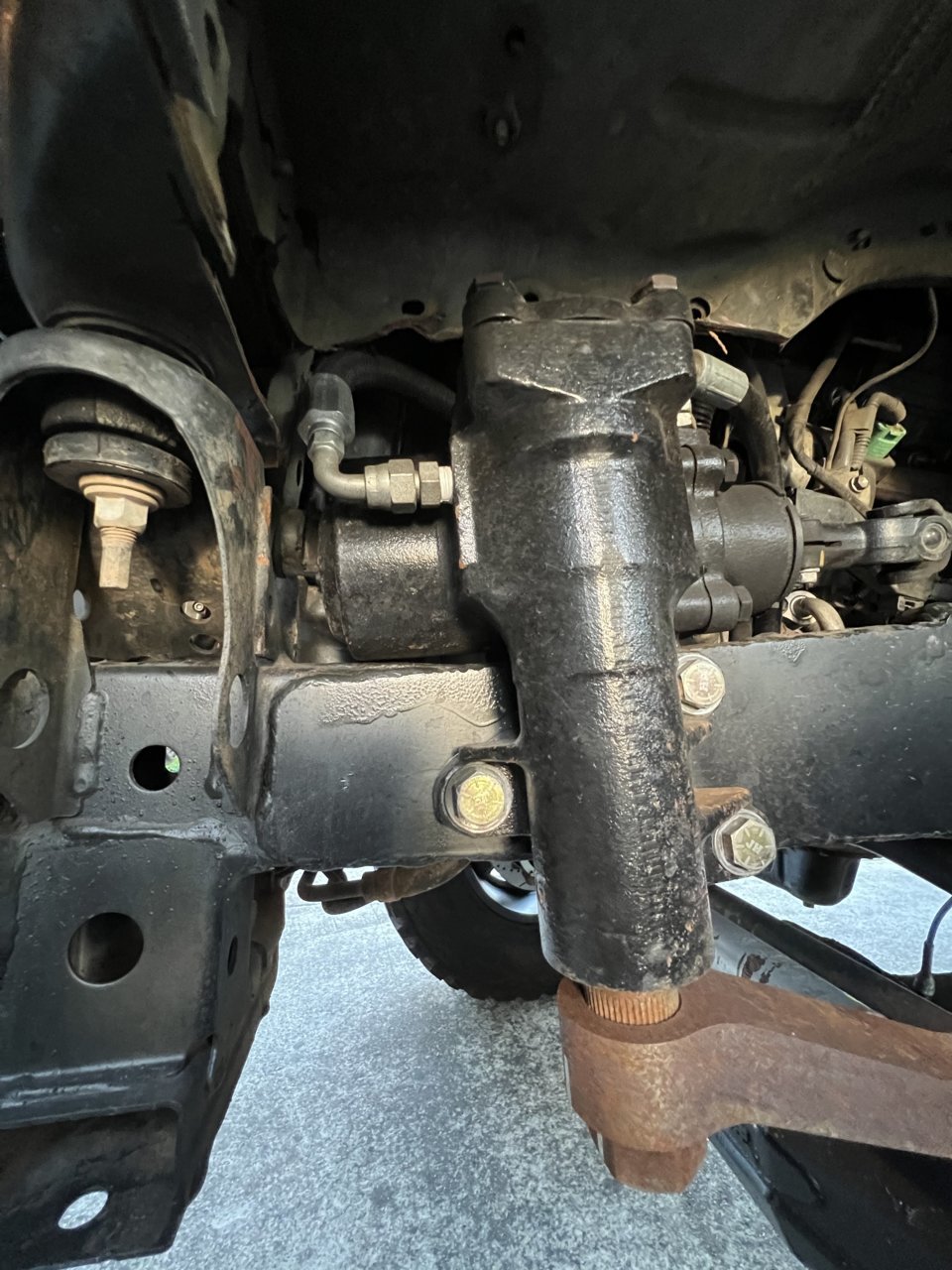

    So you have a dual case? how did you get clearance for the front drive shaft? I want to use Martec's 1 ton SAS setup but I just bought a taco box and dont know how it will (if it will) clear the link/trans support.
  12. Feb 4, 2023 at 4:04 PM
    #152
    wrmathis
    wrmathis Dark Lord of the Sith
    Sep 10, 2008
    #9126
    9,451
    Bonaire, GA
    2006 Tacoma TRD OR 4x4
    parts and stuff
    i would try using their trans crossmember under the crawl box instead of the transmission. the 2 mounts should have the same bolt pattern that bolts the mounts to the crossmember. that should allow the drive sshaft to clear the crossmember. the Links that come with the martec kit would have to be re done to account for pushing the crossmember farther back

    I didnt think of that. As long as nothing is in the way further back, I could do that. My thought was maybe doing a atlas instead of the taco box but now that you say that, I may just stick with it.

    3 link solid axle 2011 Tacoma 4x4

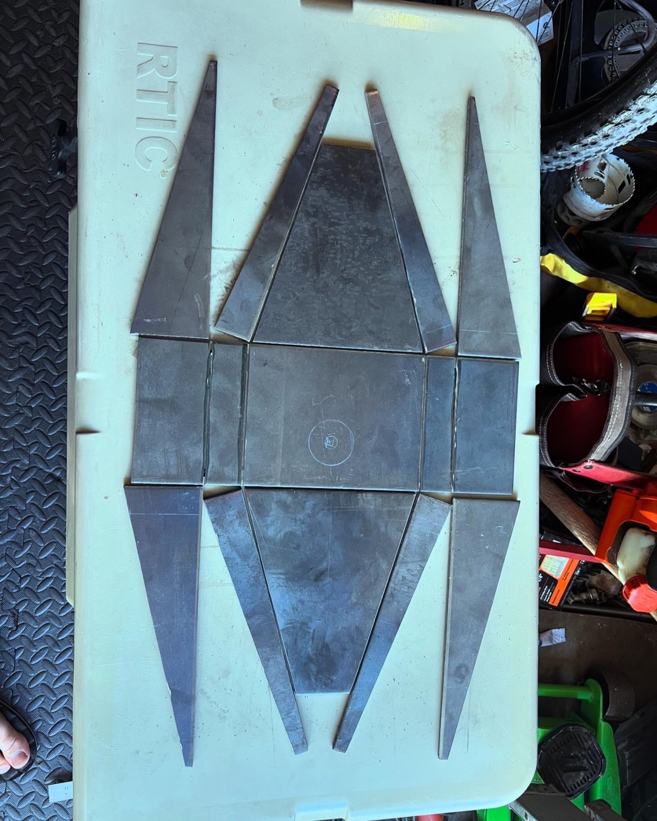

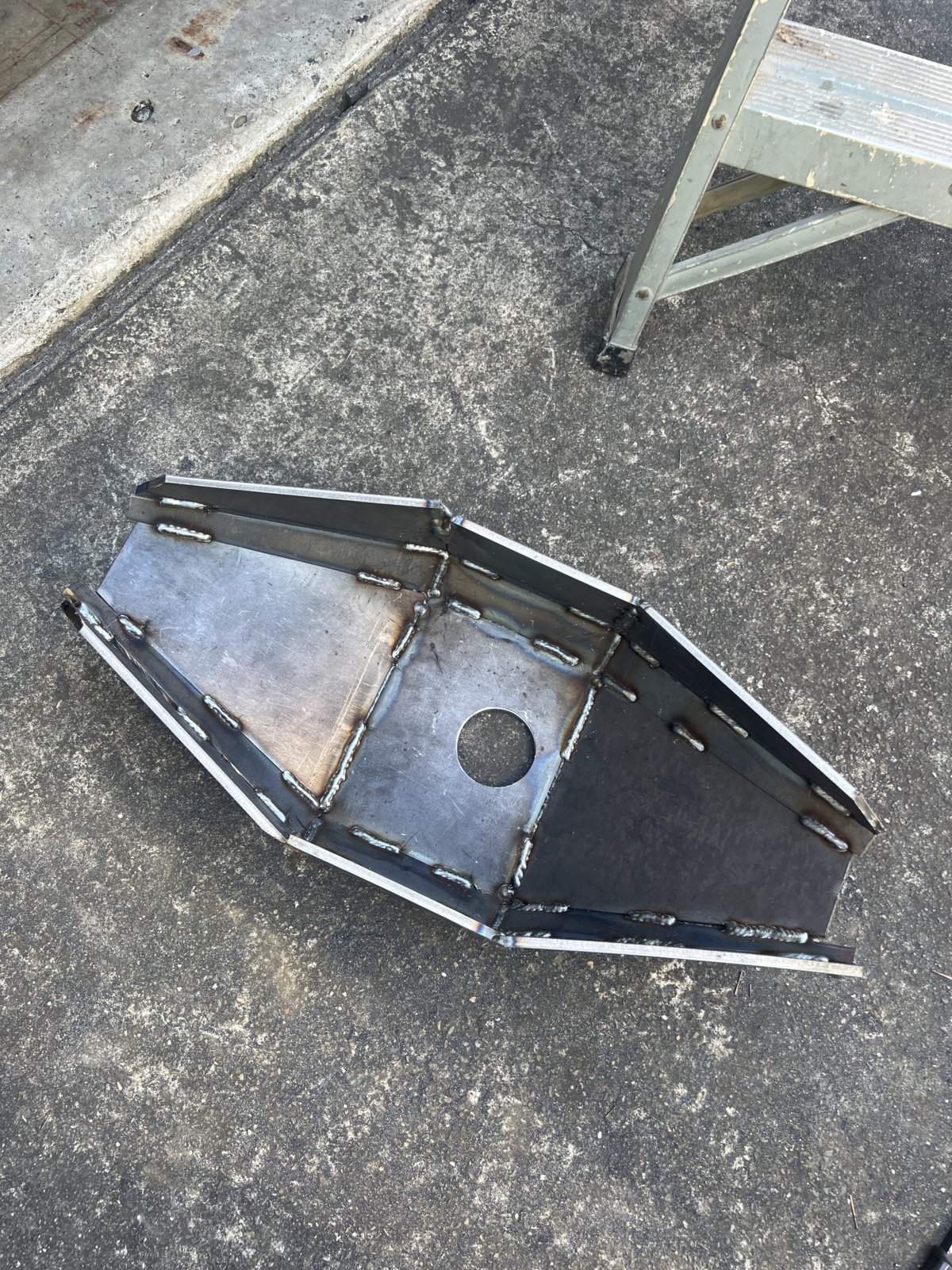

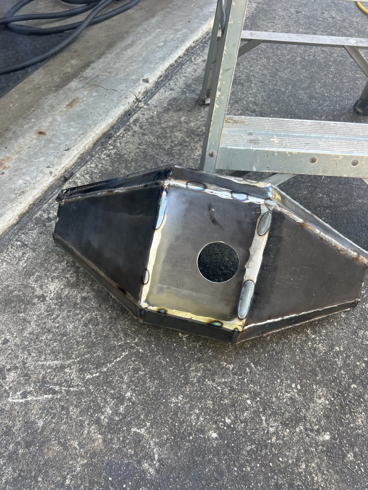

  18. Aug 12, 2024 at 1:47 PM
    #158
    Pdugan6
    Pdugan6 [OP] Well-Known Member
    Aug 11, 2013
    #110271
    1,489
    Patrick
    Sunnyvale California
    Been wheeling slick a few times this summer. Lots of contact on the diff and housing going through the gauntlet. I am in the middle of fabbing up diff protection.

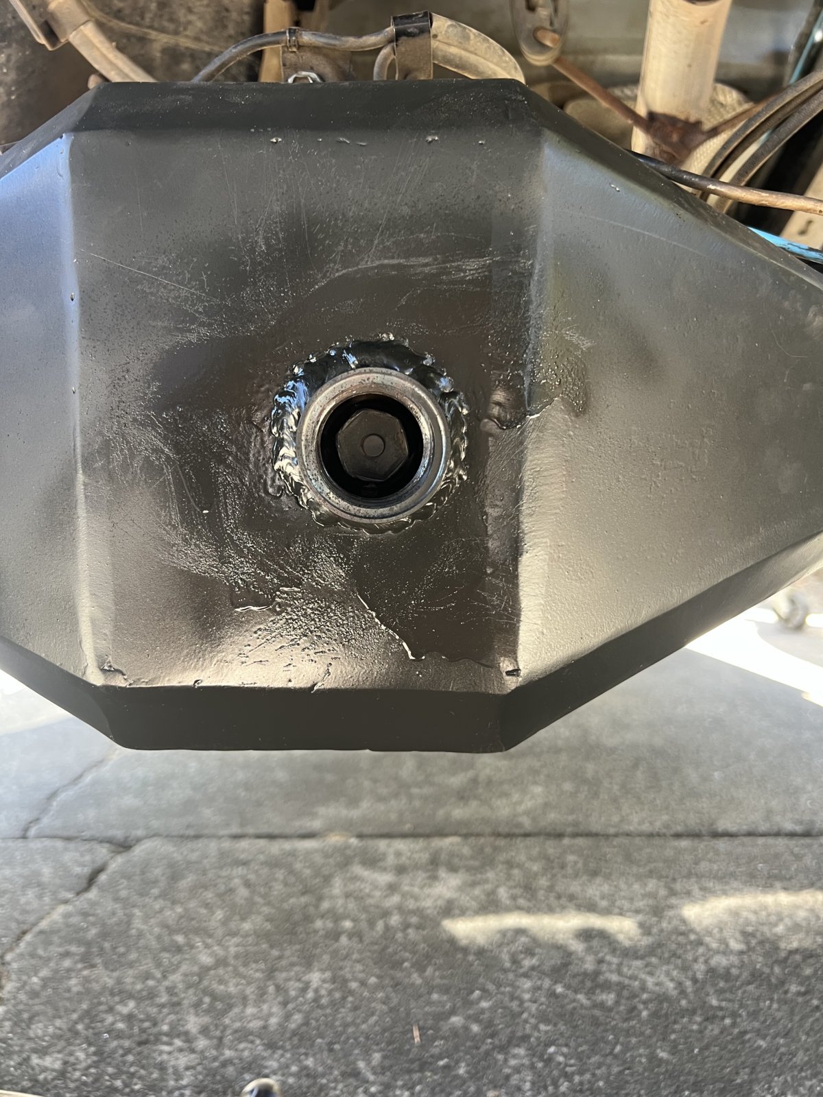

  19. Aug 14, 2024 at 1:26 PM
    #159
    Pdugan6
    Aug 11, 2013
    #110271
    1,489
    Patrick
    Take off the fill plug to get to the fill plug.
