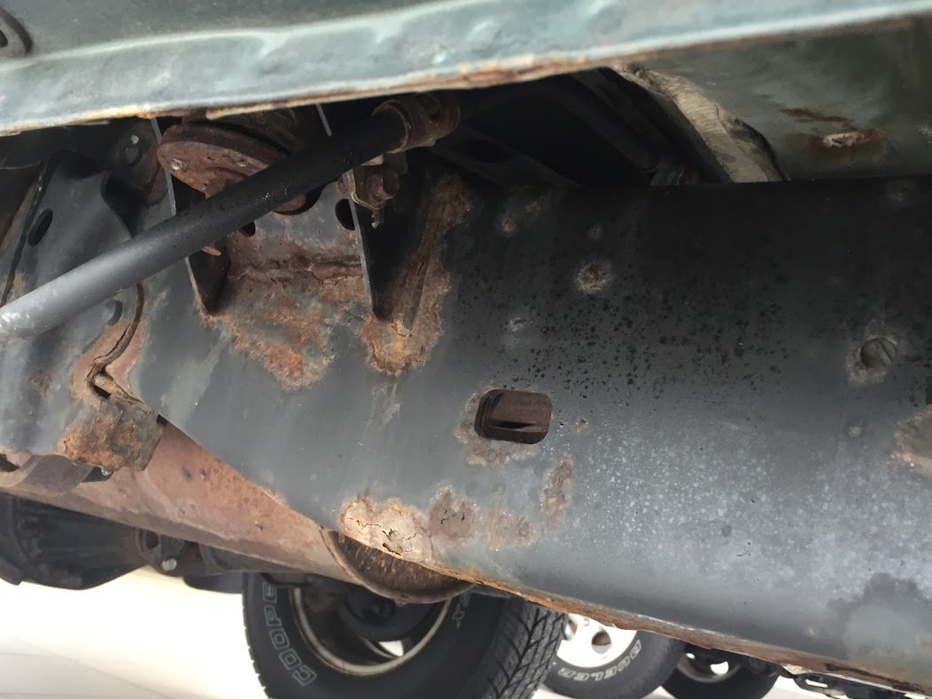

    I am looking into purchasing an 09. I will have to have the truck shipped here so I will not be able to inspect it before hand. Are there many issues with 09 and rust on the frame. This truck has not been in a real snowy area but there is still some rust on it. What are your thoughts.

    In the second pic, is that a crack that travels vertically on the frame?

    According to the dealer none of it is structural, but he is a dealer...

    5 years tops on that frame
    it already has rust through in spots first pic middle
    not snowy but it has hit some chemicals
    salt from dust control ? been on the beach ? near the ocean ?
    near a fertilizer plant ?
    looks like much older than 2009

    Are these frames rusting through from the inside out?

    Holy crap. Waiting for the 2010 rust threads to show up now :( and the CRC still only covers 05-08, correct?

    I'd run not walk unless they replace the frame. That is scary - not safe. Even if they did replace the frame I'd treat it every year. Toyota does not buy good frames period.

    I would stay away, it's not super bad now but it will keep getting worse.

    Even the floor is about to have a rust through by the plug.
    Find another Taco.

    yes it rusts from inside, so if that is outside, than inside looks 100 times worse, If I were you I would look for something else.
    On the side note, the theory that Toyota changed frame process for 2009 trucks is now blown through window. So as I said many times, 2009+ trucks are o nthe same boat, except there is no frame replacement for them.
