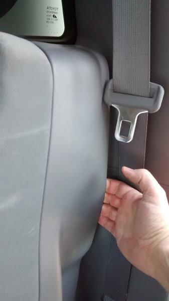

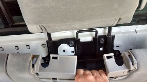

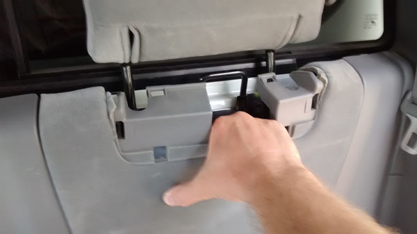

    I did this today, and never could see the green clips. From reading others' posts I found that I could pull the back off without damaging anything...
    First, pull here. Dig deep, you want to pull as close to the clips as possible:
    Then pull along the side. There's some gray clips holding the side of the seat back:
    Finally, enough of the clips will have popped out that you can bend the seat back and access the headrest bolts:
    No clips were harmed in the making of this post.

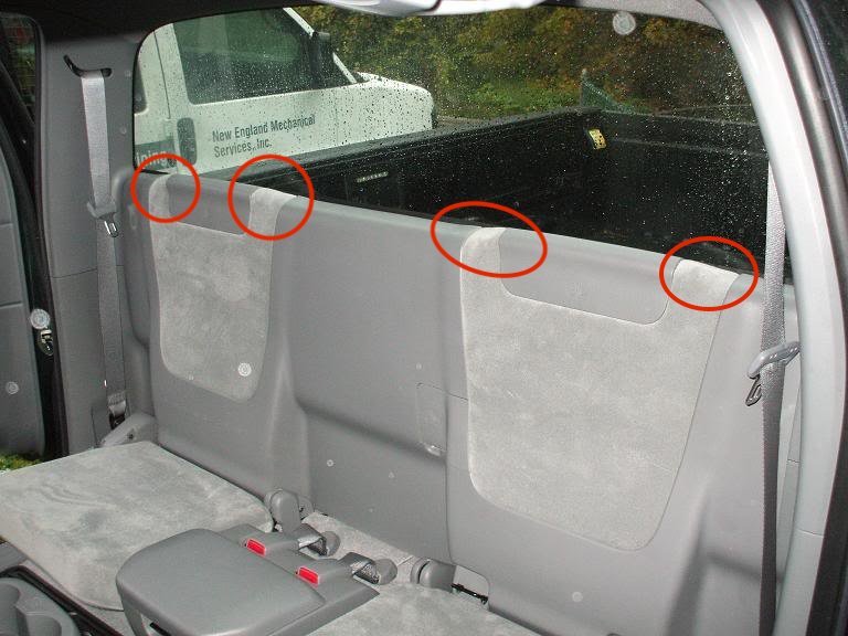

    90
    Brent
    If anyone is confused where NOT to pull, its the four spots that the fabric wraps up to the top. These are weak points with a small plastic connection that will snap pretty easily. Pull anywhere but there and you're good to pop clips out with no damage. Ask how I know...
