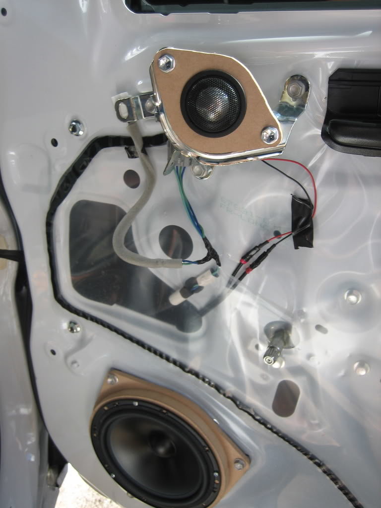

    Aftermarket it is! :) I decided to throw out the idea to keep it stock looking - it just wasn't worth it especially with regard to budget - would've needed a JL Cleansweep or the likes and if I'm not mistaken, you kind of NEED amps with that thing (amps are undesired and out of budget right now). Either way, the JL was simply out of budget for the VERY BASIC things I needed; just wanted a little more volume and a little bit better sound (plus USB connection).
    New head unit is Pioneer DEH-P4100UB. Head unit installation was a breeze. Used the Metra dash kit that came free via Crutchfield and despite it's cheap plastic brackets, it actually stays in place (doesn't move around, no rattle, etc) and everything went in smoothly.
    No amps right now, so no component speakers. No sub because I seem to be satisfied without one so far.
    New Infinity Kappa 62.9i speakers will go in (HOPEFULLY), but right now the factory speakers are still in place. Even with the factory speakers, the new head unit is a world of difference. :yay:
    The Kappas are 2-way coaxials with an external crossover and pointable tweeter. I say HOPEFULLY they will go in because Crutchfield says they are too tall therefore the door panel won't be able to fit back over them. Uhhhhhh.....:confused: I measured them - their outermost diameter is 6.5". Also confusing is that they sent a Scosche SAT6 plastic adapter, but it does NOT line up with the speaker. The Scosche adapter hole diameter is 6" - so it makes sense that a 6.5" speaker doesn't fit, but why/how is it SUPPOSED to fit a 6.5? :confused: Well I'm not worried about it because 1) I have ordered MDF baffles from Mr. Marv :) and 2) google shows that some people have had similar problems getting 6.5's in it and 3) Crutchfield lists about 3 speakers that 'fit' an '09 regular cab and I find it hard to believe I'd be restricted to Sony Xplodes or $300 Bostons and 4) if for some reason the Kappas don't work, oh well, live and learn.....and return them and get something else. :D
    I would've been majorly messed up on the factory tweeter / woofer connector situation if it hadn't been for EvilMonkey and Mr Marv who have outstanding posts and responses for that bit! Soooo the speaker adventure will be in the near future - here's hoping it's not a total nightmare! :pray:

    Regarding your question about baffles, adapters being the wrong size or speakers not fitting:
    The speaker depth can vary
    The cone width can vary - I had an Infinity 6.5" where the cone diameter was more like 5 3/4", then had Planet Audio which was 6 1/4"
    ... etc, etc. Also, Crutchfield does a guess on lots of parts, but isn't always 100%. Just as an example, sometimes they will say a certain sub won't fit in your car when you know your trunk is plenty big.

    Nothing like RTFM - the 'official' speaker diameter is 6 1/4" per the manual. Also per manual, baffle hole needs to be 5 1/8. Crutchfield says 5 1/16, grr. SonicElectronix says 5 1/8. I told Marv 5 1/16. Grr again, LOL. Not a showstopper, I wouldn't think, just grr. :)
    I dunno, I still think I should be able to attach to Marv's mount/baffle and be ok.
    Having fun either way and like chickenmunga said - it could be an even wierder situation since cone size, etc. can vary greatly.
