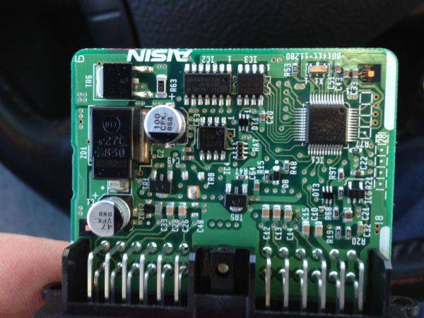

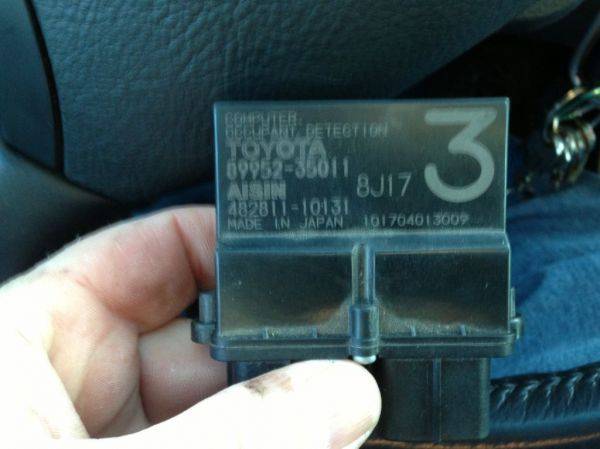

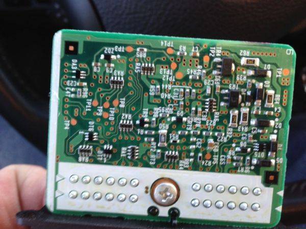

    Plug and play. Also I removed mine and opened it up to discover the corrosion so I knew it was toast. I would do the same before replacing it. If I recall it was two screws and pulled out of the case from one end similar to a computer "card"

    Its only a few inches off the cab floor. Its got one or two plugs going into it, then it is literally slid onto a tab under the seat. Takes five minutes...just check it. You will be surprised, or I will buy you subway, lol.

    Only when I see its not toast with a clear picture from your new camphone :D

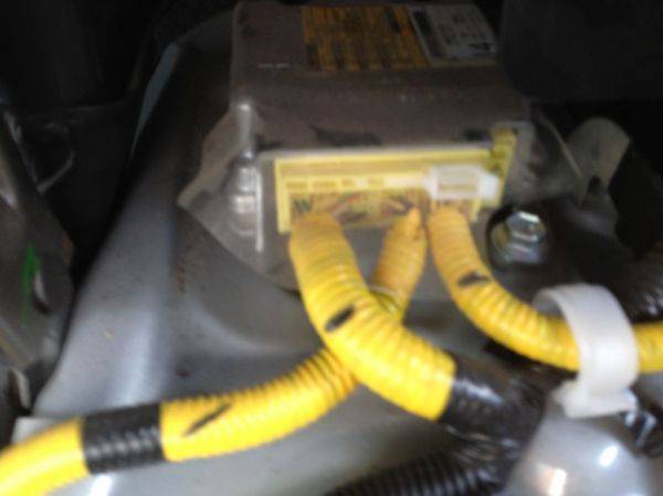

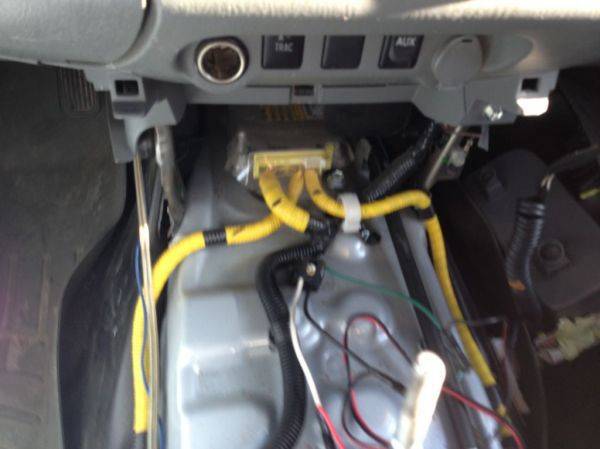

    ok so removed center console today and checked center air bag ecm
    result it was well above the high tide line......
    removed the pass seat occupancy detector ecm
    result it was well above water line as well
    so im leaning toward mabye corrosion in the # 2 floor wire or some connections
    as well as a possable selt belt tensioner
    i will remove all connections on sunday and start tracking things down with jumpers and testers as per fsm
    looks like a side air bag something might be low around kick panels too...
    im thinking if they are showing open that might throw the code as well
    also am going to try n restet n clear the codes then readf them again...
    im also going to remove the yaw rate sensor because im sure thats going to explode one day...
    question can i drive truck without one?
    thanks for all the help guyz.....
    its not going to be a fast fix but i will get it with a lil help from uz all
