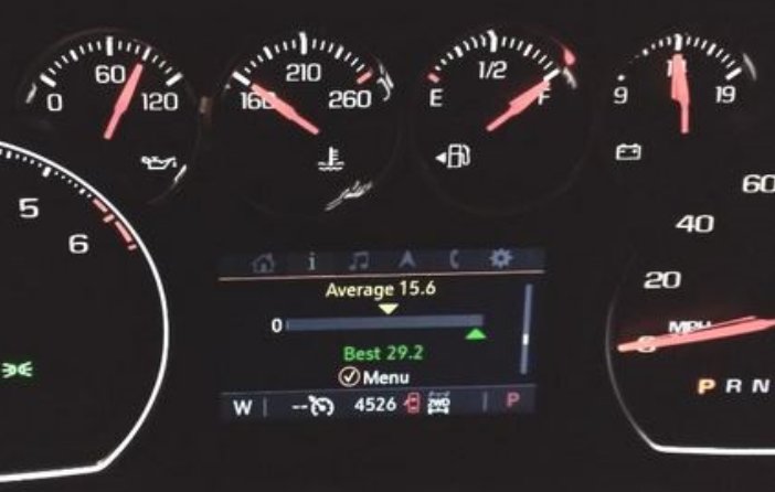

    I know this is a Tacoma Forum and I have a Tacoma, but gas mileage is dependent on many things and one is good maintenance just like anything else with a vehicle. The screenshot below is from a 2019 Z71 Silverado, V8, 4 door. Average MPG 15.6, best 29.2.
    Here's the short story on the 29.2 MPG. The 29.2 mpg was accomplished on an ice fishing trip to Lake of the Woods. I drove up to my brothers' house in Mora, MN, then we took his vehicle to Lake of the Woods. He/we didn't want to get there before the lodge restaurant opened up at 6:00 am so on the last third of the trip he set the cruise control at 40 MPH. It didn't bother me as I slept about half the trip and his normal day starts at about 1:00 am anyway. Remember, this was winter driving. A good conversation piece when he trades it in, which he'll probably do, as he doesn't plan on resetting it.
    Want to get great mpg, slow down, 4x4 trucks aren't made for great MPG.
    My Ultra gauge shows the average for my Tacoma at about 17.7 mpg and my excel spreadsheet is close enough that I'm not worried about the difference. My lowest is 11.8 and my highest is 23.9, according to my spreadsheet.

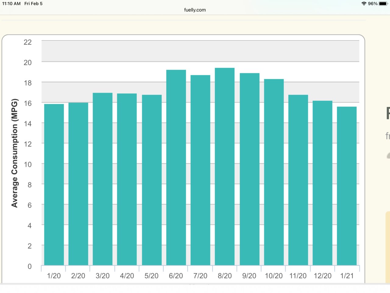

    BTW, fuel mileage will always decrease in the winter. Several causes, winter blend fuel, richer fuel mix on start up, snow/ice covered roads, declining tire pressure, stiffer lubes and grease........many causes.
    My truck was getting 19+ mpg in October. January it fell to bottom 17s mpg. Nearly a 10% drop in a couple months. February is typically colder, I expect more mpg reduction, 15-16 mpg wouldn't surprise me.

    3,995
    2015 Access Cab V6 4x4 SR5 MGM
    My summer driving is 18 mpg. This month is now 15 mpg.
    you can see it here below.
