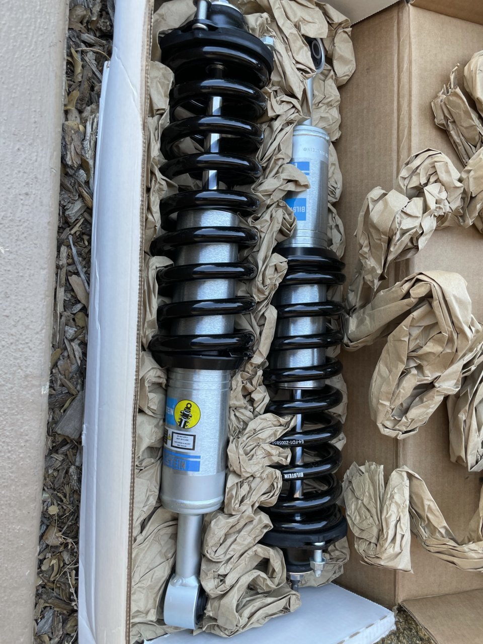

    Alll righty so on Monday I done got me this box, which I wasn't expecting until Friday:

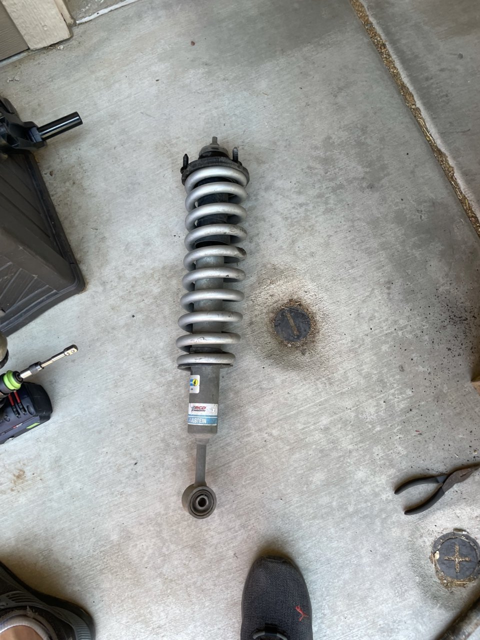

    So away we go! Here's a pic of the existing setup, see if you can tell what is wrong here...
    Don't see it? Try this out:

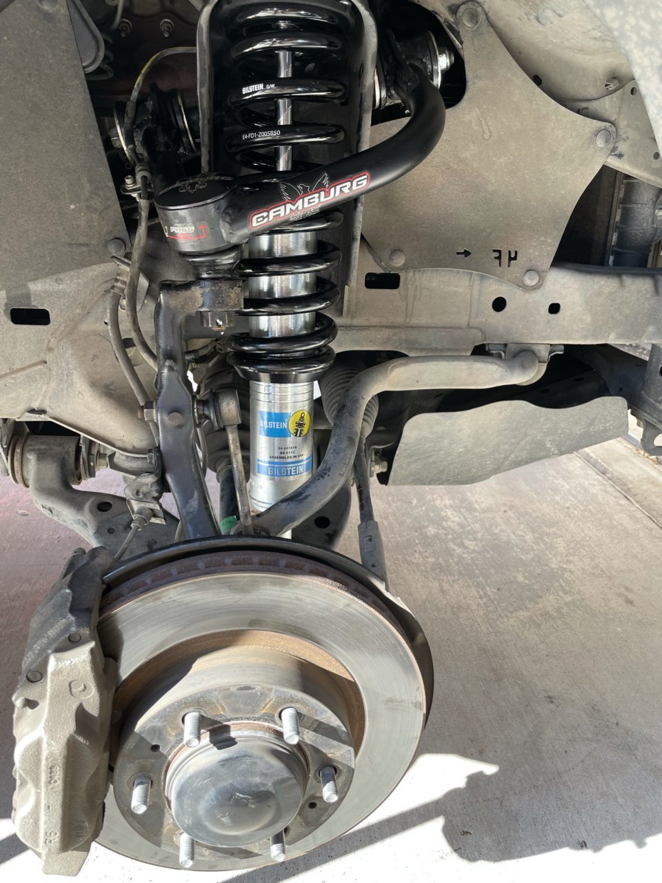

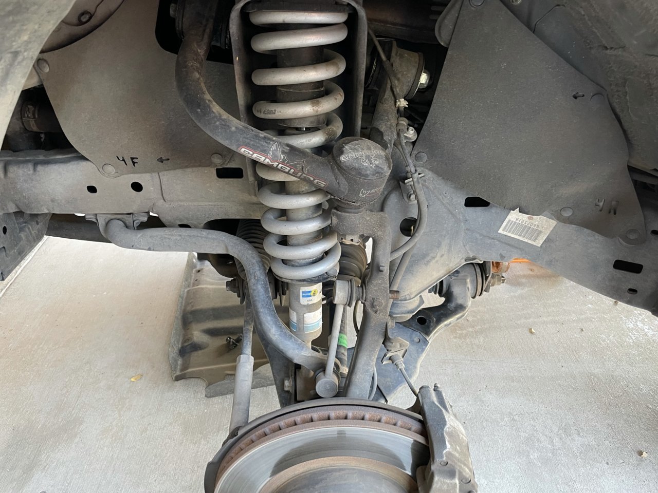

    Yeah both of my eibach coils have a curve. If I kick them around they wobble. Oof, I don't think that is supposed to be a thing. At all. But they got replaced so no problem anymore.
    Now this is pretty.

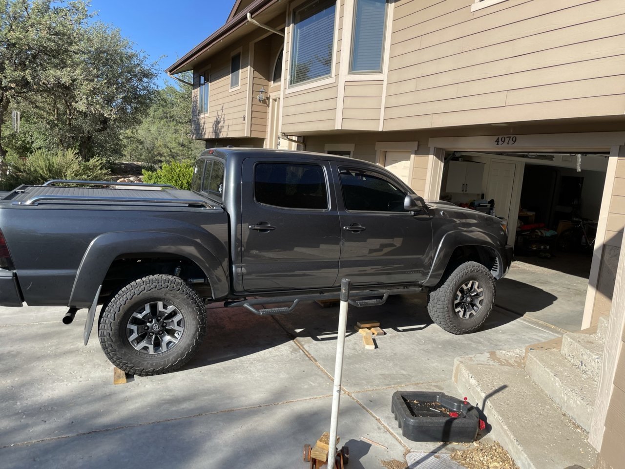

    The goal was to get within 1/2" drop from back to front. I am at EXACTLY that. Oh boy. Taco lean spacer completely deletes the lean, really nice.

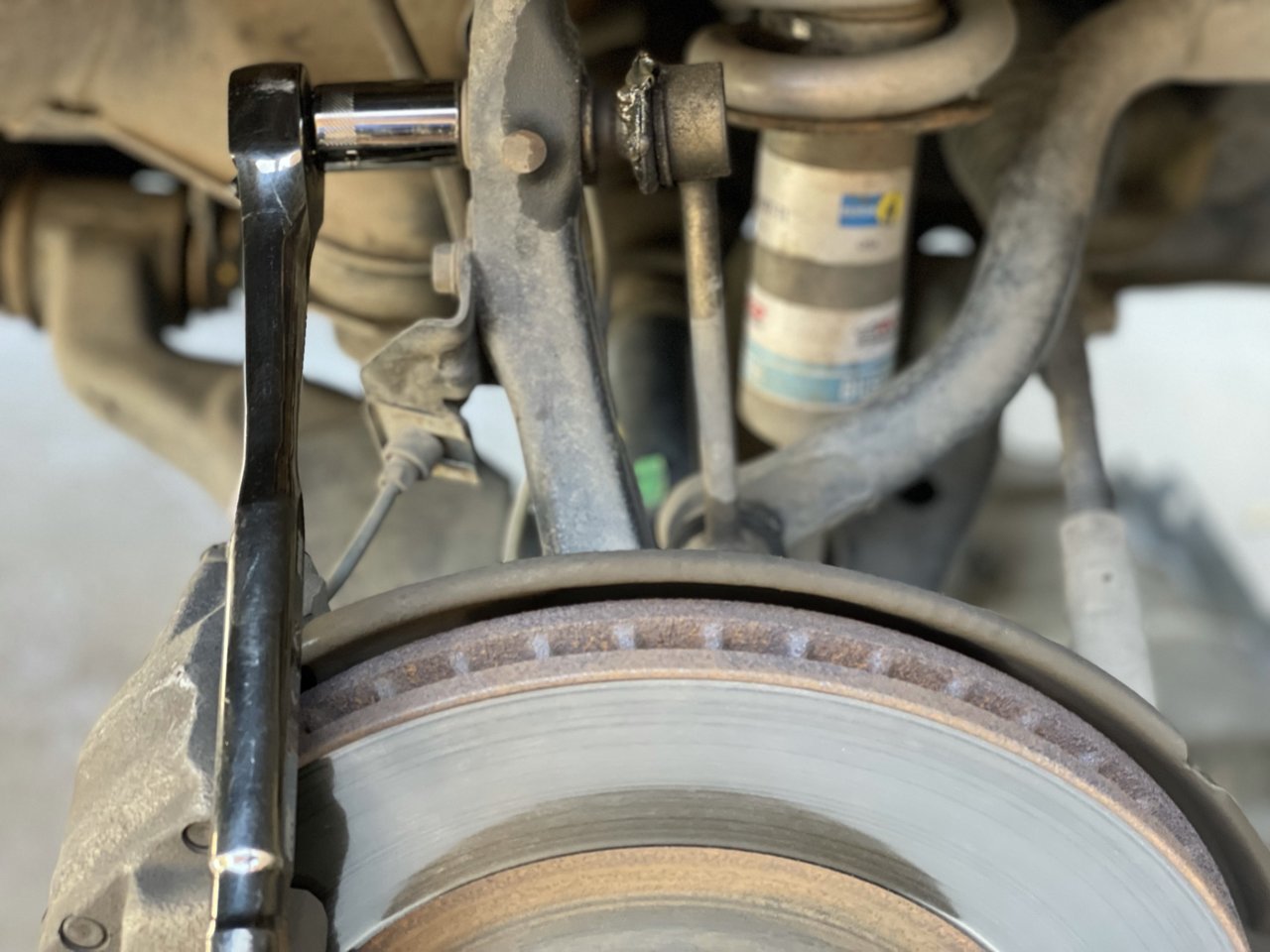

    Now I have had a concerning click coming from the suspension and I think I found the culprit. One of them, at any rate.
    So the sway bar linkage on the passenger side just spun when I went to remove it. Had to grab it with pliers on the other side to remove. Plus, the sealed grease looks like it's all blown out. Asking you guys to verify but I think I need a new anti sway bar. Are there any better options over stock? And if stock, what's a good source for one?
