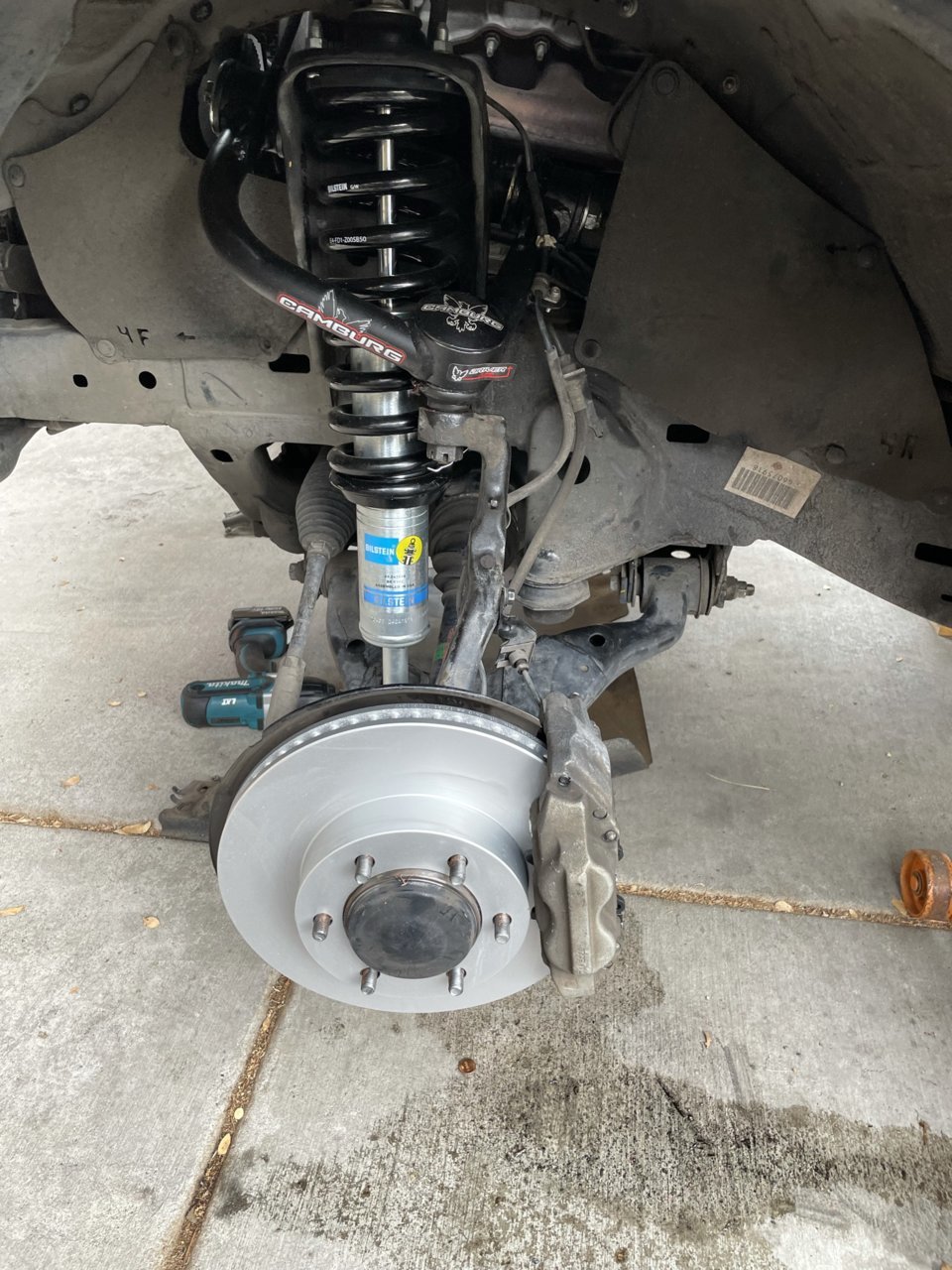

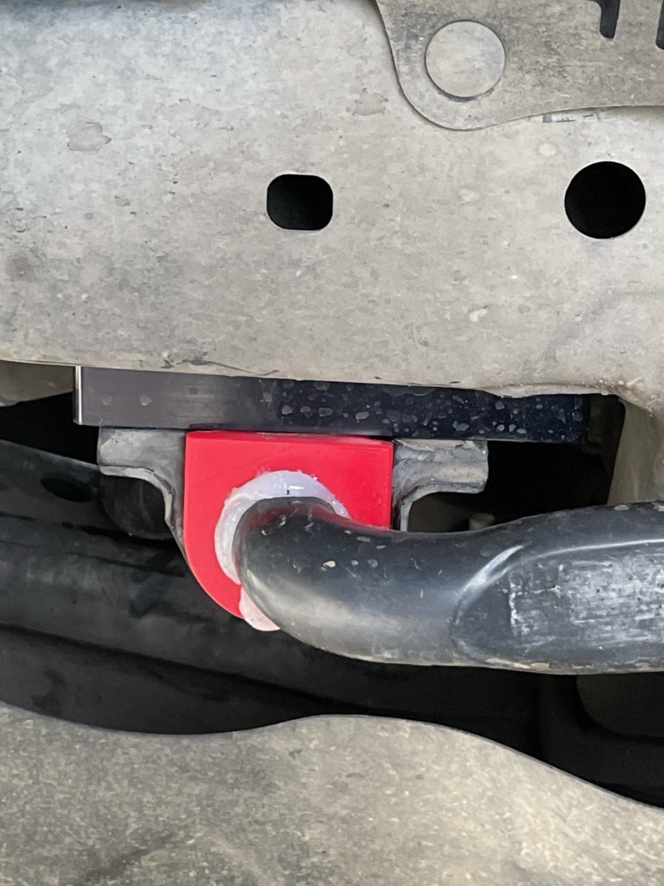

    I somehow forgot the stuff on the list for today, which was - new brakes and rotors, and new anti sway bar links bushings and drop kit. Ooh after all that it really feels nice. A majority of the slop in my steering is tightened up now, makes sense.
    Shiny rotor and brakes ready to go
    New bushing and drop kit on the sway bar. Some of the included grease squeezed out in that shot.
    And, a little needle bearing/axle slop demo video! How bad is this? Regardless I have a new bushing, and necessary tools in hand on friday.

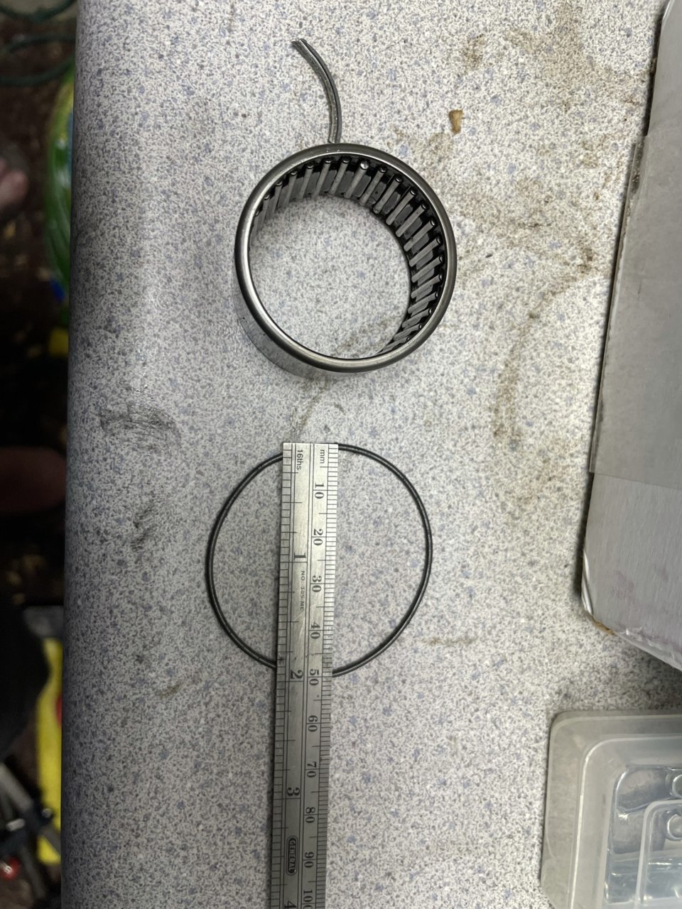

    Okay so boy was I glad I changed out the needle bearing for the ECGS bushing. The cv axle had so much play in it, afterwards - nothing. And one of the needles in the old needle bearing was trying to make a break for it! The entire cage has 1-2mm slop pushed front to back. It's a disaster.
    Top is the old needle bearing, you can see the rogue needle trying to bounce right at the top. Part of the case snapped but I think that was just trying to wedge the install tool in there, used a magnet to get out all of the material so I'm not worried about that. At the bottom though, is another story. Looks like just about 2 inch or 50 mm diameter, maybe 1mm diameter thick O-ring of some sort. It is stretchy but has a metallic outer, like a guitar string almost. I found it on the ground when I was cleaning up... oh boy. Near where I had the axle hanging out when I was removing the needle bearing and tossing in the new bushing, so it either fell from the CV axle, which is odd because I thought everything was tight there - or it fits on the back of the wheel bearing somewhere. Anyone know?
