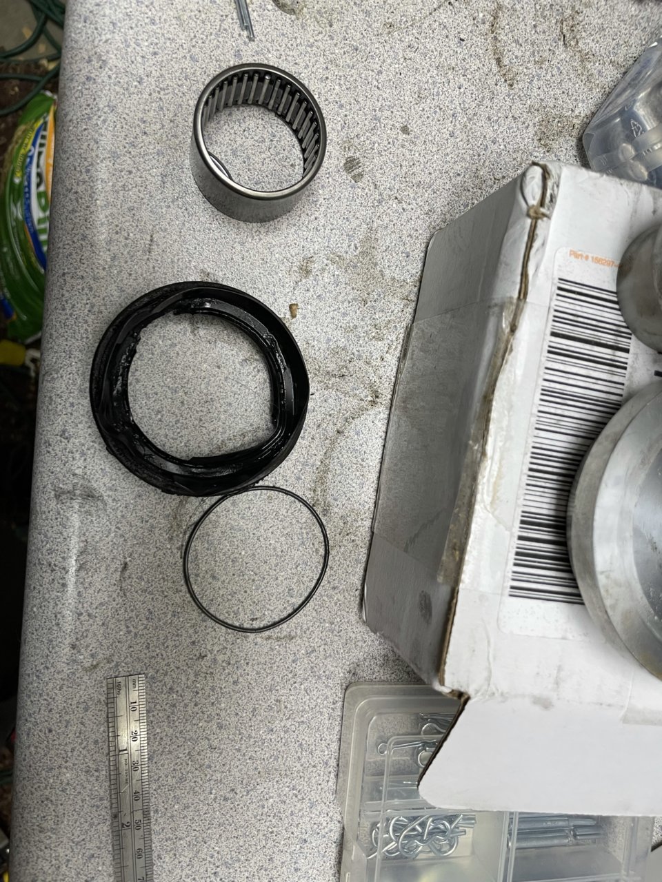

    @acupunk called this one - looks like that ring was a part of the old axle seal, which makes sense it's right where I put the old seal down after I ripped it out predator style with a flat bar. Looks like it sat in that tiny groove. Whoo that is a relief!
