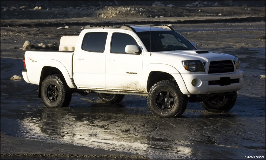

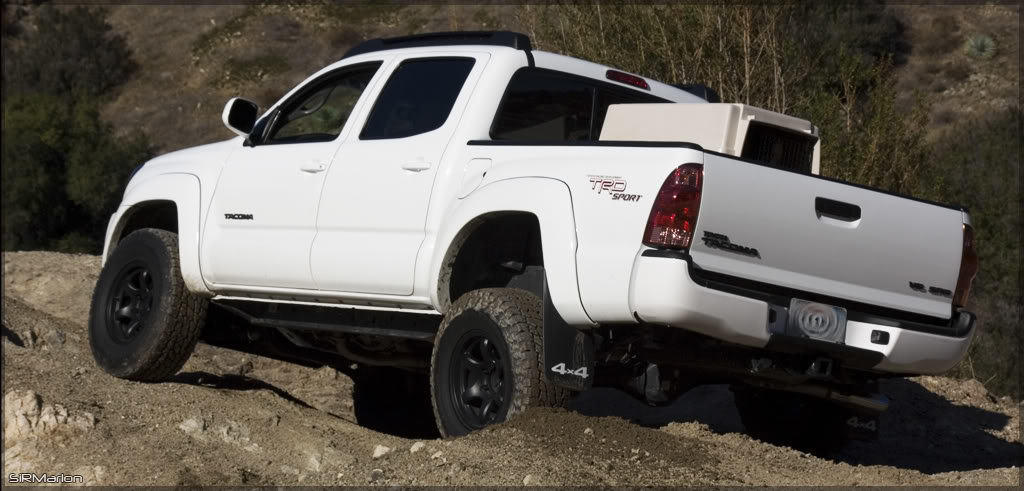

    Get some Icon Coilovers for the front and set them at 2.5" of lift. For the rear go with bilstein 5100 shocks and a 3-leaf add-a-leaf (Deavers or Icon). Go with 265/70/17 (32") Nittos with 17" wheels. That is a quality setup, it will ride like a cadilac. The suspension will run you around $1200 for everything. If you want to step it up a bit get some total chaos upper control arms as well ($650).
    This is what my truck looked like with a 2.5" lift in the front and add-a-leaf in the rear. I was running 265/75/16 (32") nittos on 16" wheels. Its a perfect setup and you dont have to worry about rubbing.
    Here is how she sits now with the icons set at 3"s and 285/75/16 (33") tires. She rubbed like CRAZY! I even had to cut my frame a bit.

    DTRUJ, thanx for the info! You have one sick ass truck man!!! If I'm not really planning to offroad (maybe 5% of the time), would you still recommend this setup?

    I still do recommend that setup. Save your money and do it right the first time. Icon, Fox, Camburg, or Sway-a-Away are all high quality coil overs. It will provide your with a lift and give you a better ride than stock, both on and off road. When I first got my truck, i lifted it using adjustable bilstein 5100s in the front, after that I upgraded to Toytec coil overs, finally I got the remote resivor icons. It was a night and day difference between the icons and the rest. I wish I would have gone with the icons in the first place. The toytecs rode like shit, and not to mention you can't adjust them on the truck. Any of those high quality coilovers that I mentioned will run you about $900, the rear 5100s will run around $150, and the 3-pack add-a-leaf around $150. Save your pennies and do it right the first time around.
