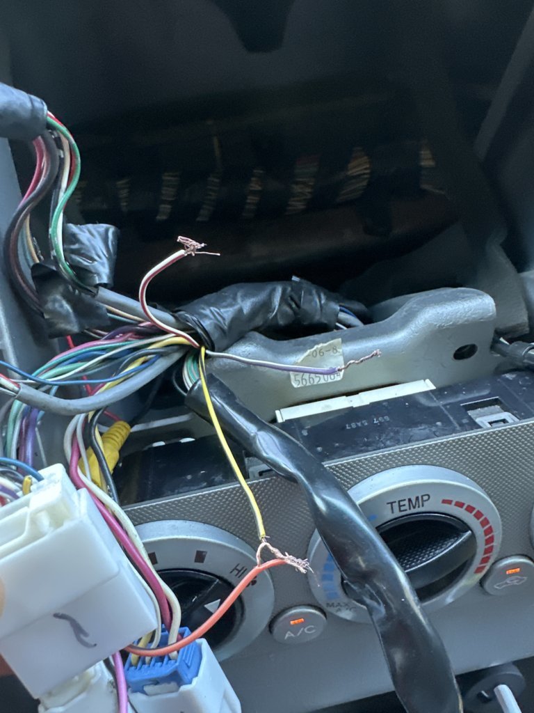

    Hey,
    I just bought a use 2009 Tacoma
    previous owner installed an aftermarket stereo android 12 and it has CarPlay etc and messed with the wires. it was working fine when I got it but then it started to glitch and the buttons on the side stopped working.
    wanting help on what to do to fix it?

    Well the previous owner cut some wires that is coming from the truck. Wanted to know if that is causing the issue or just need another stereo.

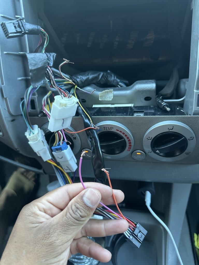

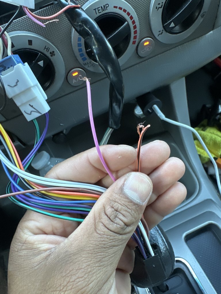

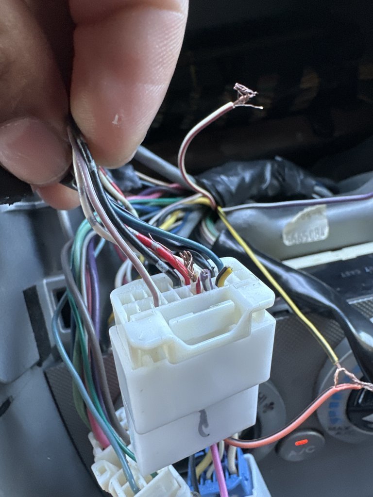

    i would trust that radio about as well as any politician.
    but no matter what, you'll need to repair the wiring first.
    the first option is going to be a junk yard-- just get them to cut as close to 12" of wiring as possible. 6" is doable, but can be more difficult.
    the next option is a harness supplier.
    metra(seller of aftermarket radio adapter harnesses) sells 2 of the harnesses you need. but it appears 3 are damaged in your pictures. the 3rd is likely for steering wheel controls.
    metra 71-1761 covers the two harnesses for radio power, and speaker connections. but be warned, they'll be using aftermarket wiring color code, so splicing them in will require matching the wire location, not necessarily the color.
    next option would be to pay a shop to do it.
    and last option would be the dealer, if they'll even touch it.
