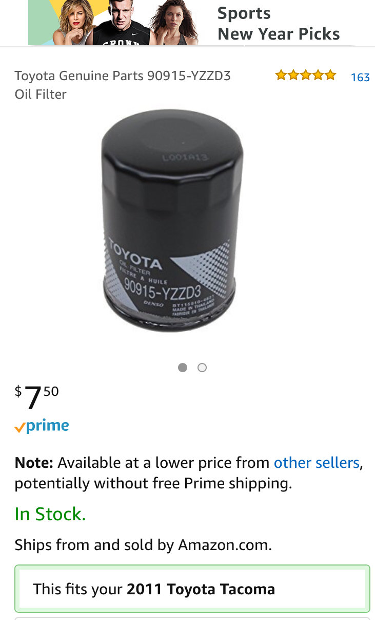

    I really don’t know what filter. Assuming it’s a a valvoline that’s where I get my oil the changed.

    ShuggieTaco
    ShuggieTaco Well-Known Member
    May 31, 2017
    #220385
    252
    2011 Tacoma
    1.5" level front
    This what I need? What’s bette this or the WIX?

    D3 all the way.

    '13 TRD OR Crew Cab
    Yup that's a good one. Can't go wrong with oem or wix.
    I bet your cold start knock will go away with the correct filter. Give it a whirl.
