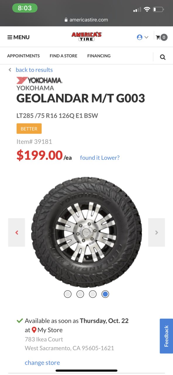

    I’m looking at some Yokohama Geolander m/T G003 tires $190 a pop before mounting balancing, etc. I like the lift kit price of $600 but could go as high as $1000 before installation. I’ll mostly be hunting and going rockhounding places where the extra clearance will make for a more comfortable ride. Probably won’t be doing a lot of mudding. I’ll likely do running boards but might not do at same time as lift. I’ll see if I get tired of hopping into the truck. I don’t foresee needing them though.
    Edit: the tires will be roughly 33” and the lift must accommodate the tire size increase. That said, will I run into and drivetrain issues at 33”. It’s a 6 speed manual.

    Those tires may require clearance work, as a lift has little to do with tire clearance.
    A 255 85 16 will get you your 33" and if you leave them on OE wheels, no clearance issues, even with no lift.

    I am not familiar with a cab mount chop.

    And don't forget the pinch weld fold, wheel well trimming and possible negative caster adjustment.

    Ok, so a lift really isn’t what gets you the clearance for 33’s (assuming you mean 285’s). The width is the issue, not the height. Which is why the 255’s work. If you want 285’s, you’ll need to cut your cab mounts, install a full plate, hammer the pinch weld, and trim inner fenders. There are shops that do it, but just want you to know what you’re getting into. I know some people say 285’s fit without rubbing, but MOST need a good bit of work to fit. For me, it was worth it.
