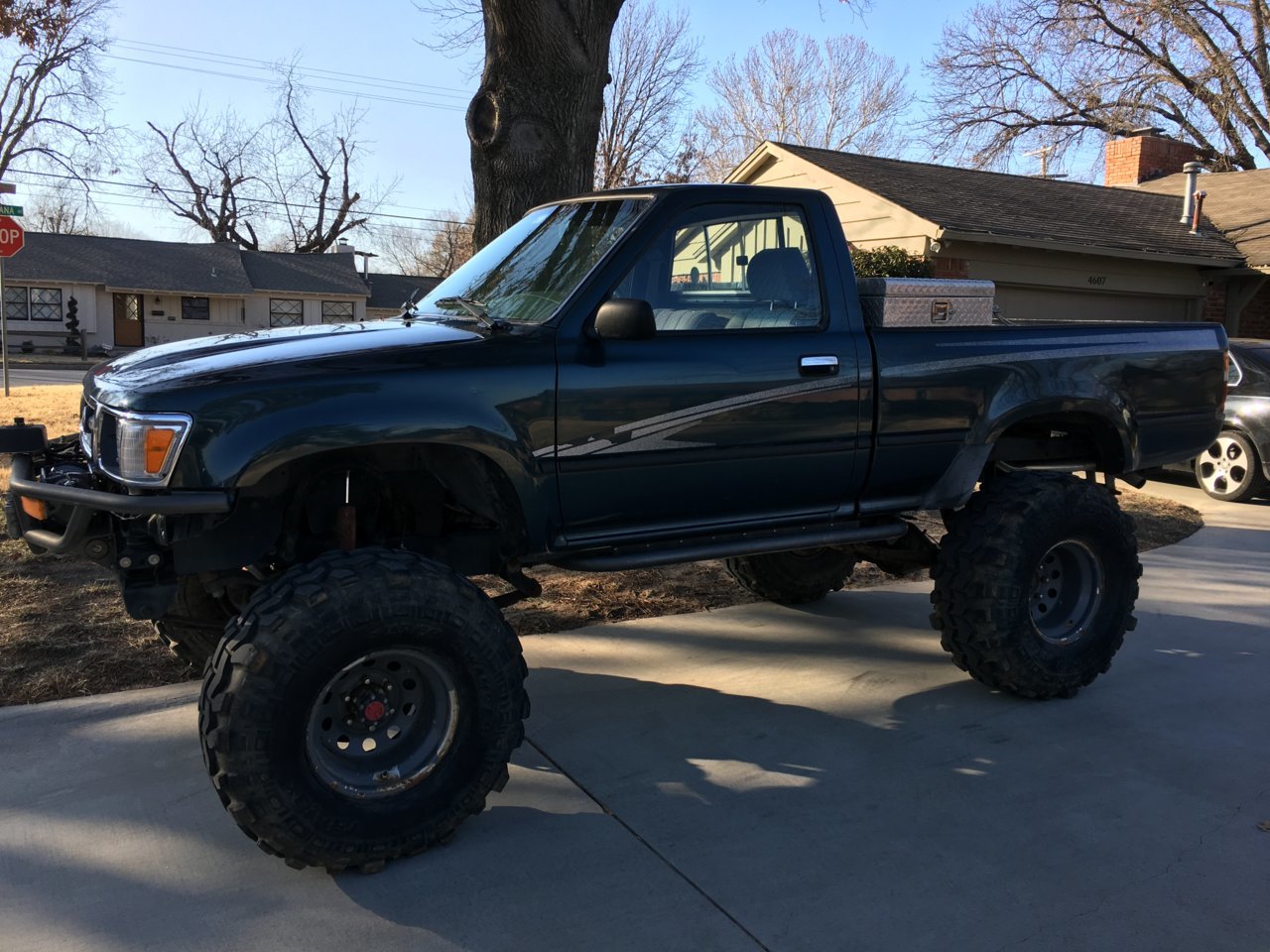

    Thought I would chime in for the real off-road people and give my experience with a 1” body lift. Here is my old truck before my 2018 TRD Tacoma. And yes it has a 1” body lift. It also has a 1” drive train lift, 1” gas tank lift, solid axle and a Marlin Crawler. The 1” body lift was greatly needed despite the front axle moved forward a full 3 1/2”. If done right a 1” body lift can give that extra clearance needed.
    If you want a 1” body lift go for it. Just remember to lower your radiator so the fan does not hit the shroud.
