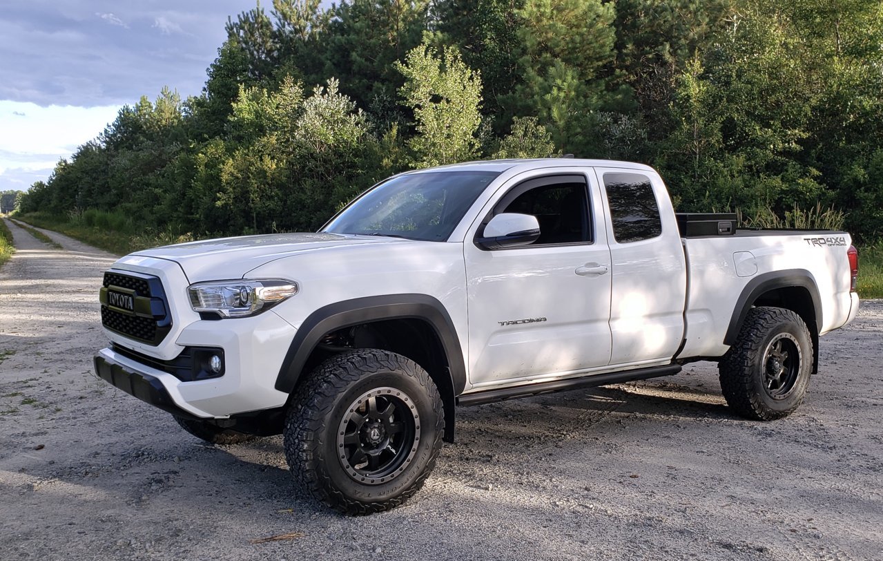

    At the risk of stating the obvious...
    A 1" lift will typically level the front with the rear factory height. If you go 1.5" front lift, you'll want to also lift the rear (unless negative rake is the goal).
    Truck below was lifted 1.55" in the front (Bilstien 5100's) and spacer blocks were used in rear (0.5" passenger side and 1" driver side because of lean), along with 5100's. Tires are 265/70r17. Wheels are 8.5" wide with -6 offset. Slight rubbing on WeatherTech mud flaps. Originally tried 1.1" lift, but rubbing was excessive.

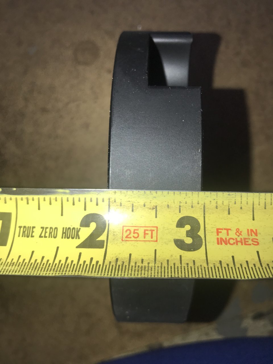

    so i got the “1.5” set of spacers. i’m pretty sure these are to tall. correct me if i’m wrong but shouldn’t they be 3/4 thick for a 1.5 lift? they said they are correct. thanks.

    Boss hoss

    That is correct, 3/4 thick for a 1.5 inch lift.

    TacomaKZ

    so basically these will give me 2” right?

    Boss hoss

    That is what i was told by the front end shop who installs them.
